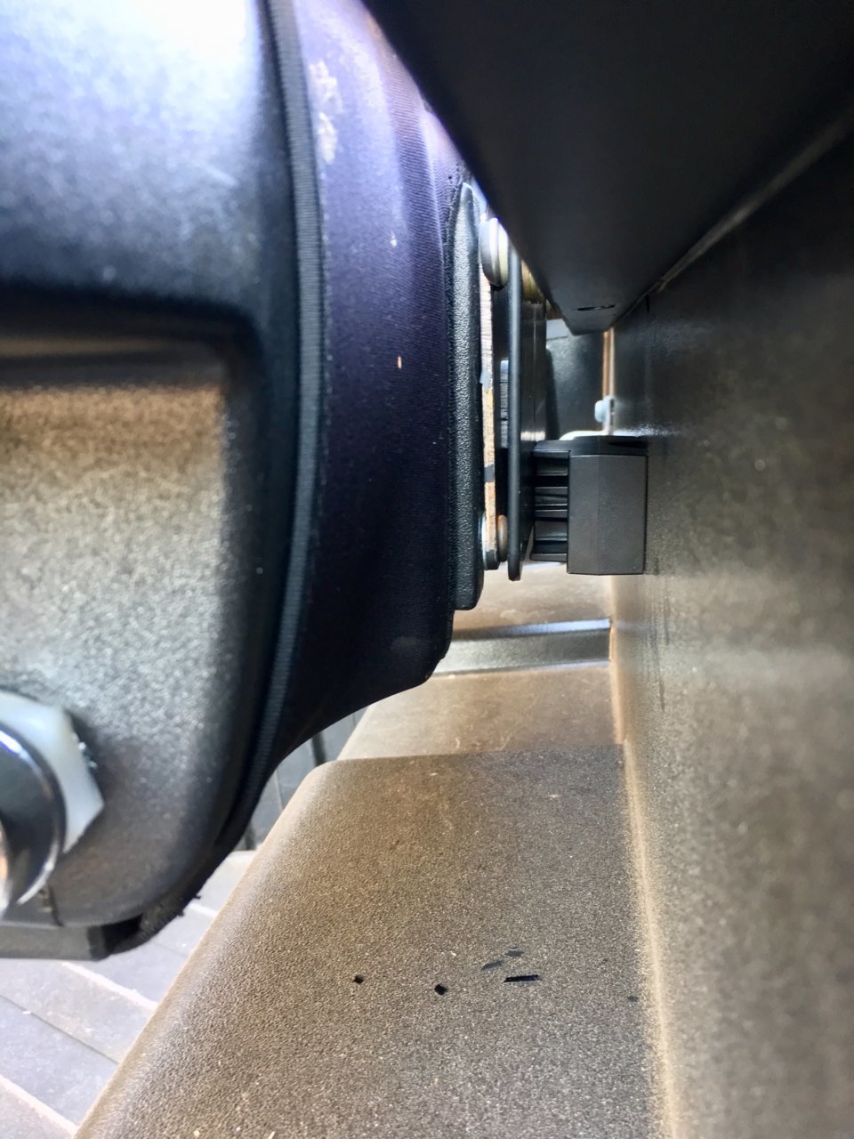

    Really handy water container that can be pressurized and holds just under 4 gallons. Costco currently has great prices on them.
    Using the bracket shown in the first pic, and some included slot nut fasteners, I bolted the mount to the bedside over the wheel well.

    Nice work as always! For the waterport, I used one of their hardware and plastic pieces with some mastic tape to the bottom of their plate. I was finding that if only attached the bed rail, it moved on trails more than I liked, so adding an additional way to transfer the load helped a ton.

    Good tip! I have that piece still and will definitely add it.
