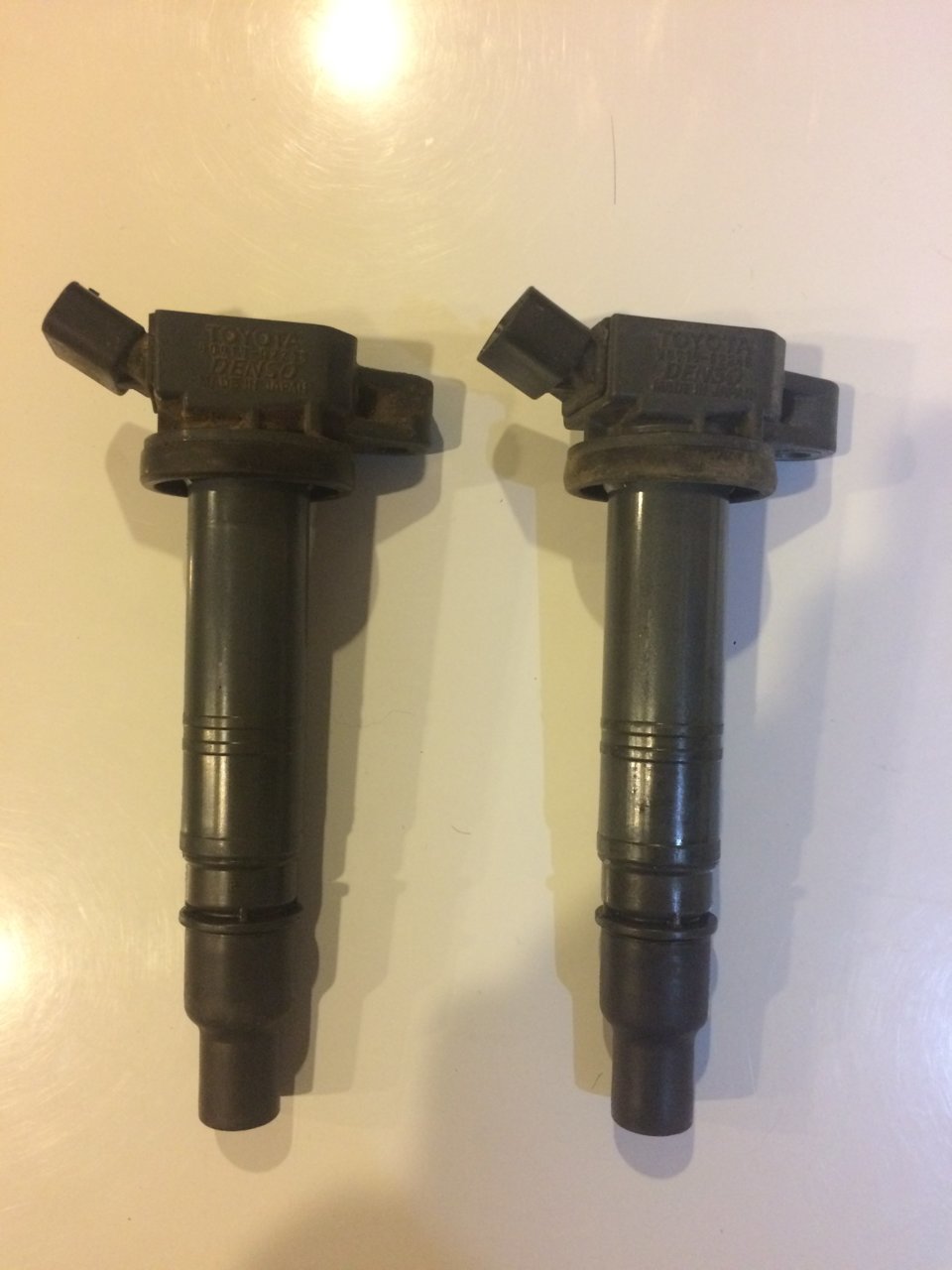

    @BassAckwards . You have two trucks. Pull one coil pack out from each and lay them side by side.

    They look identical to me. Maybe they will work..

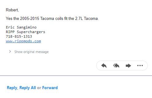

    No worries, I think I am wrong, I thought the part numbers were different bc they were between my 2013 4.0 and my 2009 2.7. I think the part number just got updated though. After looking at both online they both say they were replaced by 90919-A2006 so they should work for both I think

    Confirmed with their tech support they will work with the 2.7L as well

    The convenient thing about Toyota is there is a ton of interchangeability and they use the same parts for various models. The 4.0 coils will fit 2.7s, as will the fan clutch, etc.

    Correct. ^^^
    I've used my coil packs on a 2AZ-FE. Scion. It was just too long. Worked fine.
