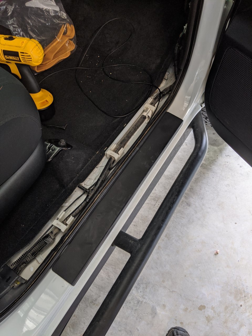

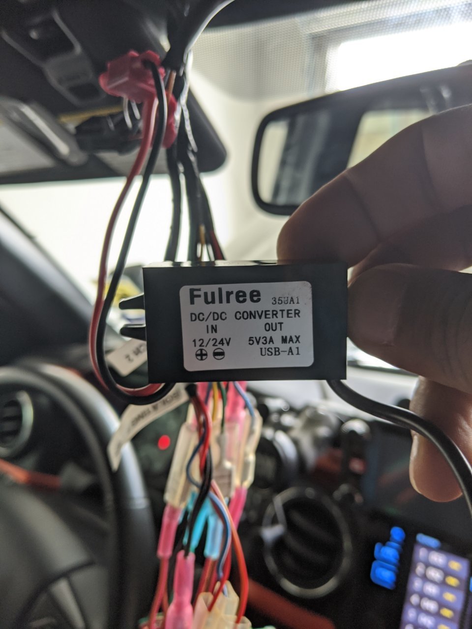

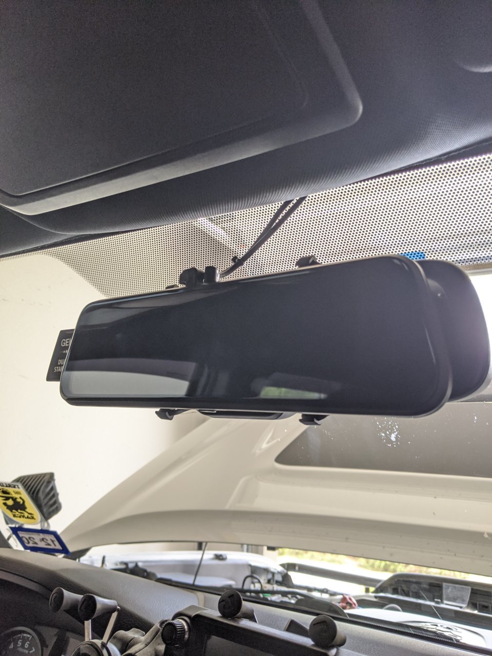

    06/27/2020 - Ran the wires for the dashcam in the headliner and got it all cleaned up.
    https://www.instagram.com/p/CCGY9eKh50D/
    I initially planned on using a 12v to 5v converter in the headliner but it didnt provide enough juice to power both front and rear cam. So I used the 12v adapter provided in the kit and routed it to an unused 12v power port in the center console. Not perfect, but it works and cost me nothing :thumbsup:
    I routed the wires under the door sills and up the A pillar across the headliner to above the rearview
    A nice fellow on IG who commented on the dashcam pic is printing me a mount that will allow me to remove the oem rearview and use a ram ball to mount to wind shield making it look clean and less bulky up there
