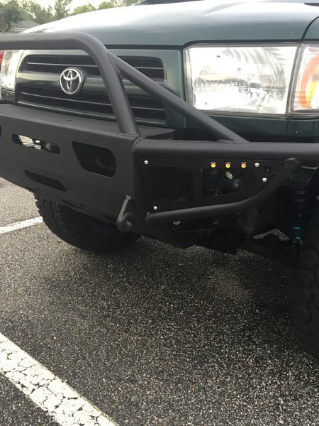

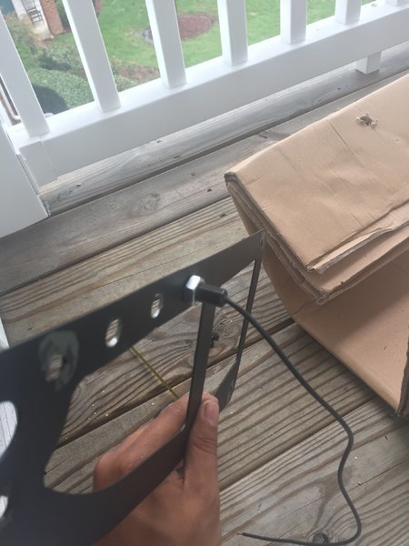

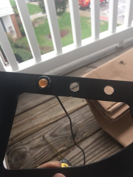

    Going with three LED's in each of my insert side panels for turn signals. I realize there was a hole for a single 3/4" on the top right corner of them but wanted to go for a different look.
    Drilled 3/8" holes and test fitted one:

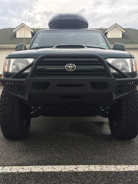

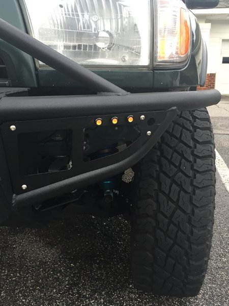

    Test fitted them. The back was a little tight but turned out pree good.
    BYJOSHCOOK likes this.

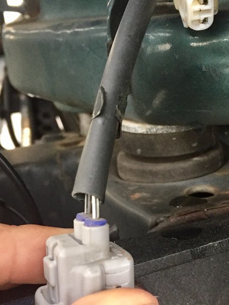

    So, looking at the wires to the signals...both wires on the signal are white with a black stripe. Which ones are positive/negative? @4Running Daily figured you've done it.

    Got a volt meter?
    Shove one needle into one of the wire ends. Then ground the other needle. If it's +12 it's thehot. If it's -12 it's the negative
