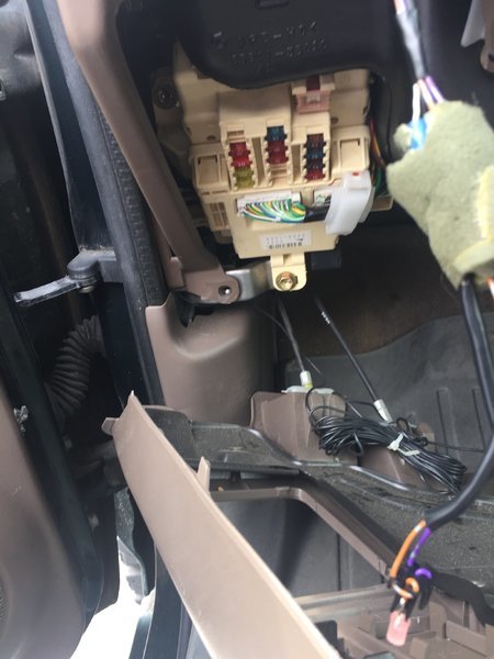

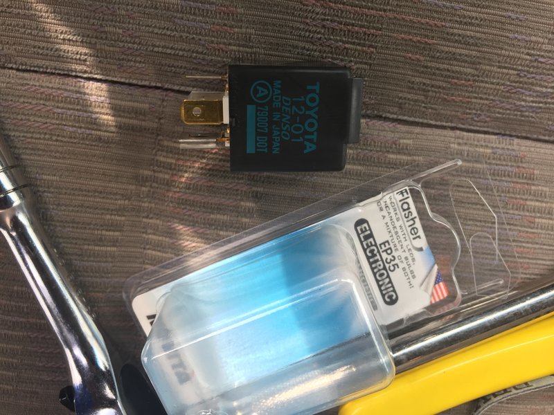

    Got them all wired up. The reduced load of the LED will cause the light to flash really fast as if a bulb was burned out. So, for anyone doing LED blinkers, you're gonna need another flasher unit. I purchased the ep 35 unit for about 10 bucks at o'reilys, changed the OEM out, and we're back in business. The sound is a little quieter than OEM but I'll get used to it.
    The flasher unit is behind this guy here:
    There's two 10 mm bolts that holds the fuse panel and it took a bit of wiggling to get to the back of it.
    Simple ten-fifteen minute mod.
    I'll take some pics of the LEDs later tonight.
