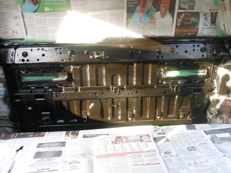

    I had mine blocked off with masking tape for a few days and found that the windows fogged up quite a bit.... The noise was definatly coming in from the sloppy space around the vents AND the rear metal wall of the cab....
    After sealing around the vents and applying sound deadener to the rear of the cab, I had about 40-50% reduction in noise... I run with the seats down 99% of the time... Even better with seats up..

    over60 (so am I.:).)
    I like the idea of spray-on insulation. Thanks
    Did the spray block any of the mounting holes to hinder re-installation ?

    NO...I put masking tape over them just in case, but it was not needed... the plastic "thingys" just pushed thru it when I re-installed the OEM stuff...
    The most critical, In MY opinion is sealing the AROUND vents....(they are so sloppy..1/4" play inward/outward).. If I was to do it again...I'd use silicone from a calking gun all around them. I just used the product shown and it dries hard... might be good to have the "flex" of silicone to keep from cracking loose in future..
    Might be a better product out there, but in the boonies here, that was the only thing I could find...
