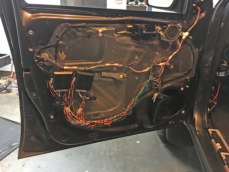

    Looking good. How did you do the automatic window roll down?

  4. Nov 4, 2016 at 3:04 PM
    Robman
    Robman [OP] Well-Known Member
    May 26, 2014
    #130638
    536
    Rob
    Hawaii
    '14 Tacoma Double Cab
    Oh and be prepared for wiring, I think i counted 40 connections;

    oh wow. Gonna see if that is worth the trouble. LOL.

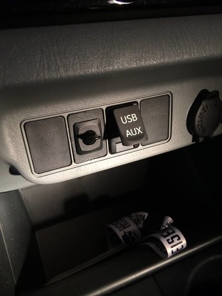

    Looks good man, where did you find switches for the center next to the usb/aux and you other switches also they look very clean?

    Thank you. I got all my switches from Aironboard.com but also search CH4X4 on ebay. The switches are of the same quality and 33% cheaper, the only thing is they may not have all the same designs.

    Let me go on to say that as far as switches go, they aren't the best only the best looking. They are SPST type have a max load of 2-3 amps so almost anything you use these switches for will require the use of a relay. Just something to keep in mind.
    My Aux Power Switch is for the 12v outlets in the bed and center console. The Bed Lights switch controls the LEDs in the bed. The reverse camera turns my rear camera on any time I push the button. Each of these switches required a relay.
    Other buttons are only wired for illumination, just there for future expansion.

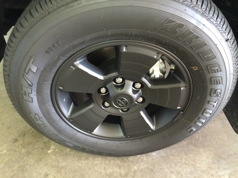

    Nice truck! Clean and simple. How did Costco damage your tires? What size KO2s are you running now?

    Thank you. They damaged the wheels, apparently the coating is sensitive to front loading the tire on the wheel. 265/70/17 load C
