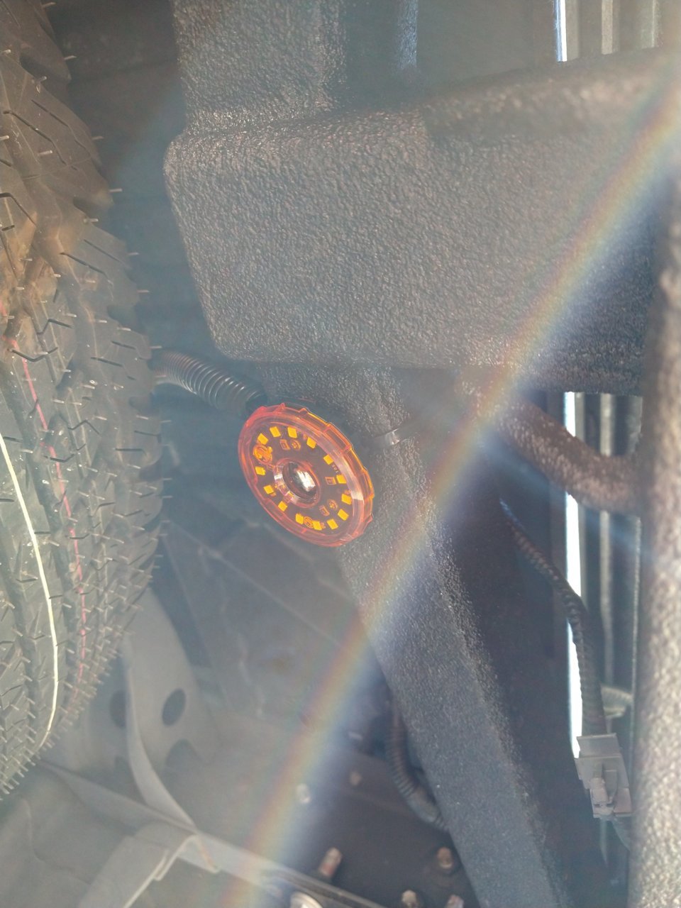

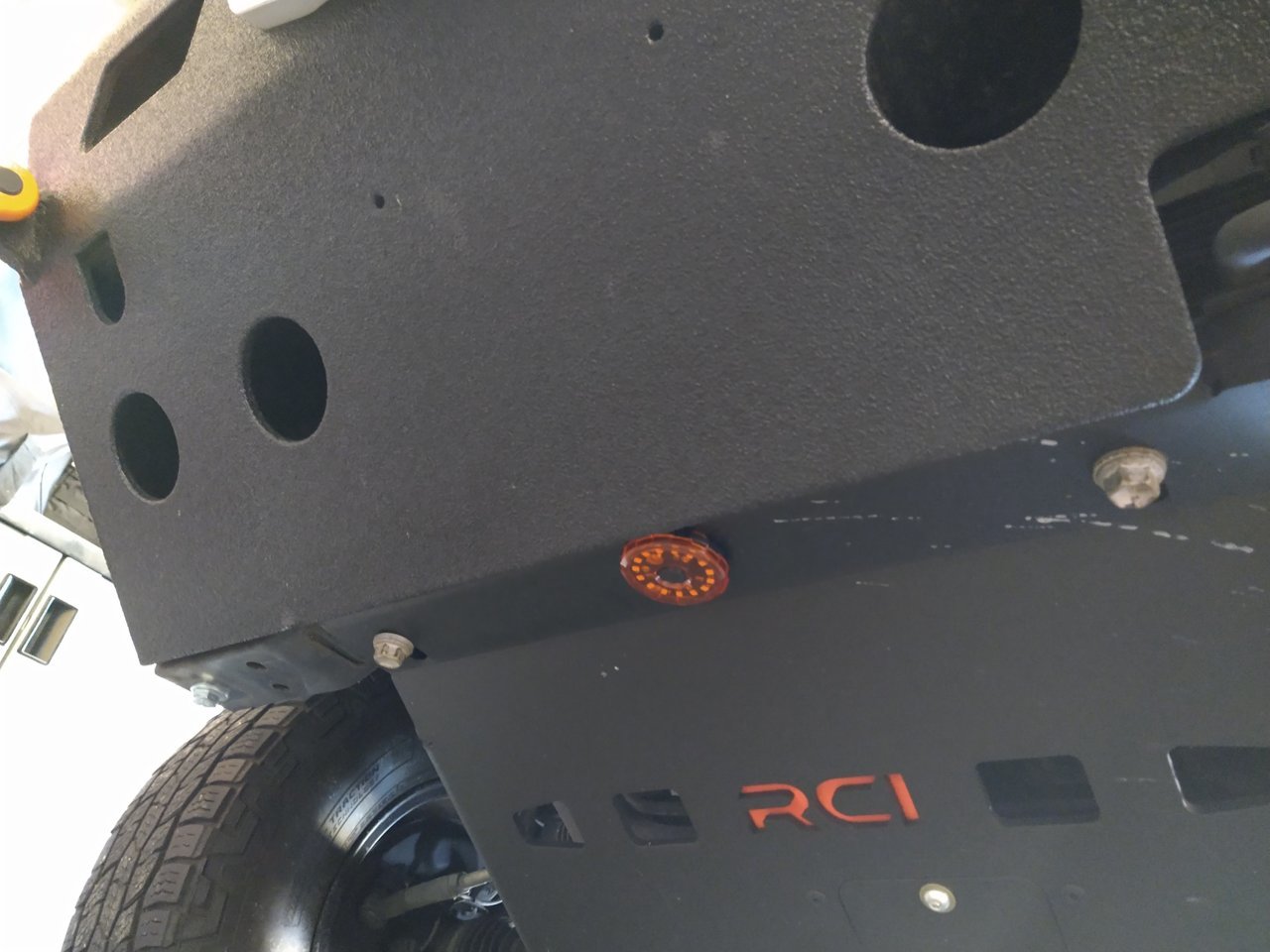

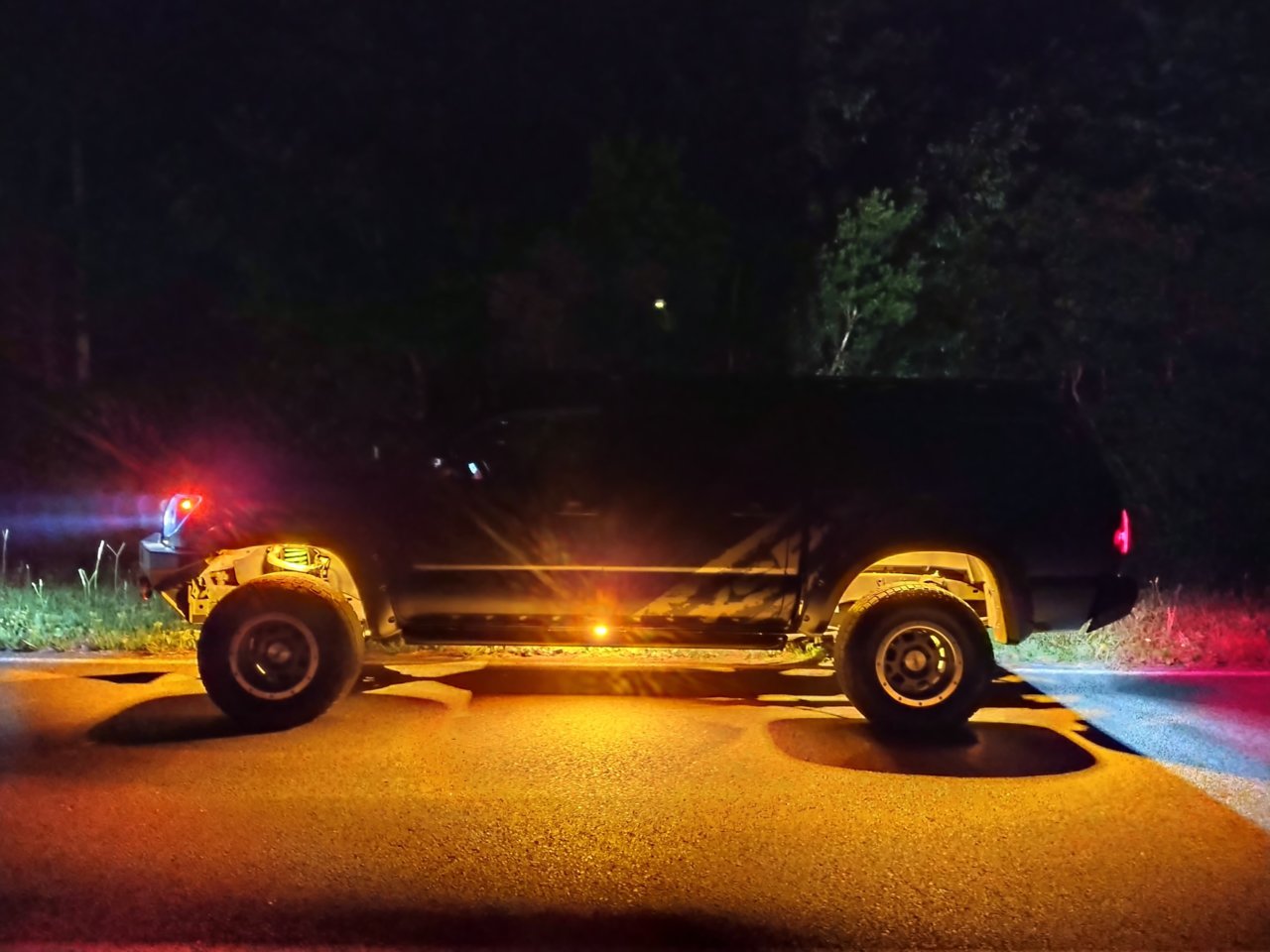

    Man I thought I updated. I have an anytime on/off switch and they're linked to my lock/unlock dome lights. I have one in each wheel well on the top, one under each slider, one in the front bumper where the RCI skid meets the Pelfrey bumper, and one in the rear Pelfrey bumper. All amber. 8 total.

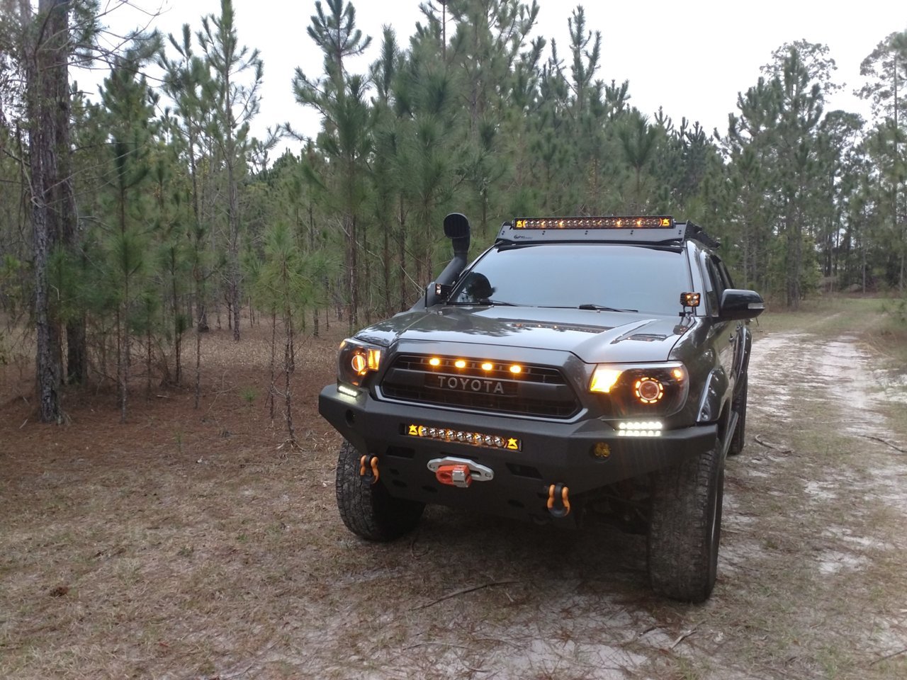

    These have been so damn useful! Camping, finding my truck at night, pulling over on the side of the road. Love em. The new version of the Cyclone's really are an upgrade. This first pic is from when I had 6 lights, not 8. I'll get ya a fresh one soon.
