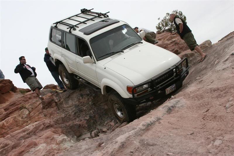

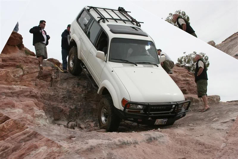

    I wont disagree about the TG gussets, but its so easy to make your own stronger gussets and have them work out just fine. That's what I did on my Land Cruiser that also has TG sliders. I made my own frame plates and gussets and I've pounded on those sliders for years and they've held up awesome.
    Hangin the whole weight of the driverside on the slider. These are 67" TG sliders (not designed for a heavy Land Cruiser). with my own plates and gussets. No deflection, no dents and lots of abuse. If they can hold up this well under my HEAVY Land Cruiser, they'll hold up just fine on a much lighter Tacoma.
    Oh sorry, some people freak when photos have the camera tilted. Let me fix that. ;)
