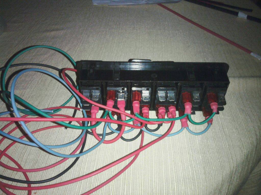

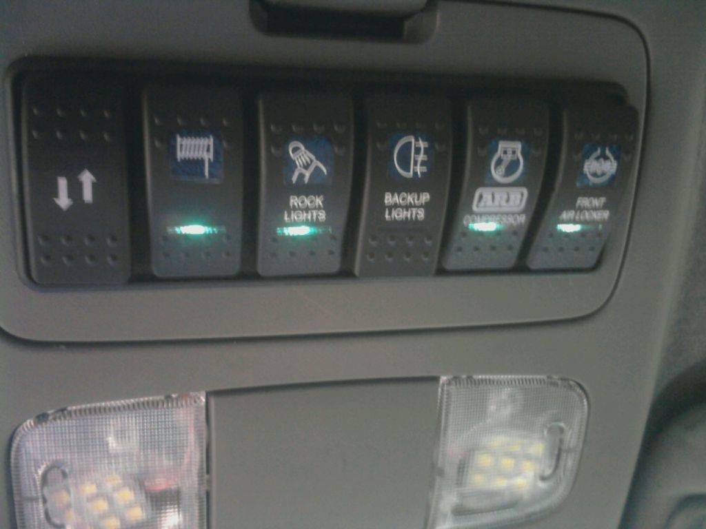

    Hey ya'll,
    Just finished installing 4 Hella 500ff's and some strobes on my Yota and thought I'd share another good source for switches and wiring solutions that I haven't found mentioned here before. Fastronix is where I got my switches at and they just happen to be made by Carling. Picked up the 4 switch panel for just shy of $34.00. Kinda nice that you can interchange toggle light colors and the number of switches you use. Here's a link
    http://www.fastronixsolutions.com/Switches and Switch Accessories/rocker switch panel.htm
    and a couple of pics of the installed switch panel

    How did you get your switches in the overhead compartment? Im clueless when it comes to this stuff.:facepalm: Got some Hella's in today and thinking about taking it somewhere to get them hooked up. I would love to have a set up like yours. Looks great!:thumbsup:
