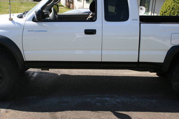

    Well I finally got around to spraying the bottom of the truck. I sprayed rubberized rocker guard from the body indentation down, then painted it silver. It looks pretty good two tone silver and hunter green.

    Kinda like this? It looks good and really protects the rocker panels!!

    Yes only I sprayed about 6" higher. Then I painted over top with a metallic silver paint using a polyurethane paint called Endura... it is really tough stuff.

    It was really easy to spray on using a Schutz gun... A guy could also spray in a box liner for less than $50 if he was so inclined.
