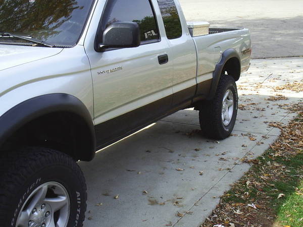

    I herculined my rocker panels and I really like it heres some pics

    I thinks it looks good. Even better considering that your truck is silver with unpainted OEM fender flares. Mine's the speedway metallic, so i don't know how well it goes with black rocker panel protection as a two tone. I don't know, I'm thinking about just adding the rocker panel protection on the bottom rear portion of the bed panel where all the rocks hit.

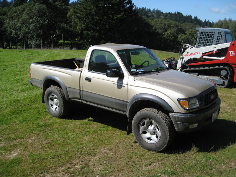

    I used Line-x for mine. I went to the top of the indentation, whereas KMOC went to the bottom. Beware that Line-x will pickup dust and hold on to it. The black will quickly take on the color of whatever dirt you have in your area. If you live in an urban area it shouldn't matter so much. Line-x is extremely durable, as advertised.
