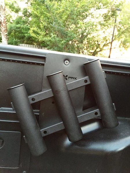

    The first set of holders I built were similar. Almost identical actually but I tossed them. Inexpensive 3 tube bases with a piece of aluminum plate. Works well for others but I really didn't like how high it places the rod tips in the slipstream ($250 steelhead rod tip taken out by a pebble or jubebug?!) or the vertical stacking when laid down lower. At some point I will do something that mounts high off the front rail (above coolers, etc) using "mortar tubes" and aluminum tubing for big long surf and salmon shore rods.

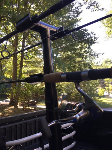

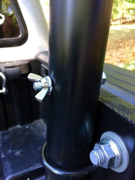

    I do a lot of surf fishing. My 11' and 12' rods would stick up way too much with most of the vertical holders I see out there. I used PVC pipe and t-fittings, which I cut open on the top side. The arms of the rack are secured with bolts and wingnuts. They can be removed, leaving only the 2 support tubes you see in the 2nd photo. Made it this way so I could go through car washes. I also added a 3rd holder for my shorter rods. You can get creative and add more PVC fittings to hold as many rods as you need. This is a great setup when chasing stripers up and down the beach.

    On the longer rods, if I mounted them that way, the reels would smack the roof. That or the tips would stick out the back too far for my liking. You can do it with 5-7' foot rods. That's no problem - but then why even use this style rack?
