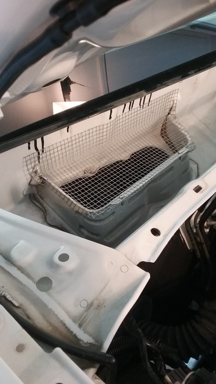

    In the cowl on the passenger side. If you look past the plastic vent, you'll see direct access where the little bugger would squeeze in to get there. A lot of people add steel mesh to this area to block it off. Pretty simple process once you remove the plastic cowl. I wouldn't suggest blocking it off until you get the mouse out or you'll be trapping him in there where he'll die and stink up your truck.
    While you have the hood open, you may want to remove the plastic engine cover. There's a small nook there that rodents like to nest in as well.

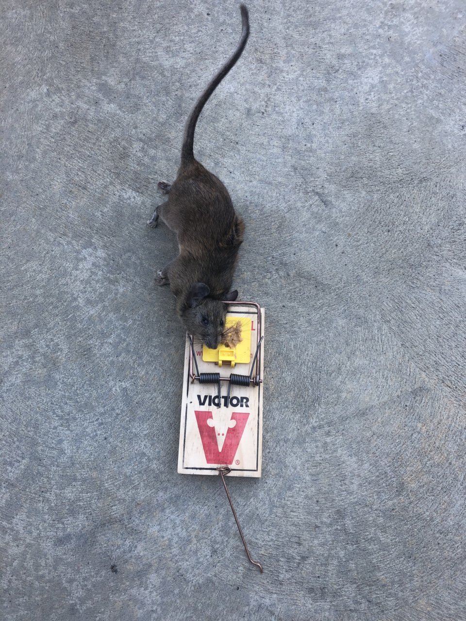

  5. May 23, 2019 at 5:47 PM
    GHOST SHIP
    GHOST SHIP hates you.
    Mar 9, 2015
    #150537
    22,393
    GHOST

    Plain Jane Taco
    Plain Jane Taco Well-Known Member
    Apr 19, 2009
    #16179
    40,279
    USA
  15. May 24, 2019 at 4:34 AM
