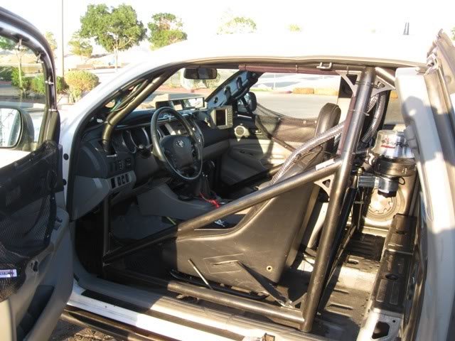

    I'm caged with .120 wall 2" chromoly all around, tied directly into the frame and A-pillars, properly triangulated and gusseted at all intersections.

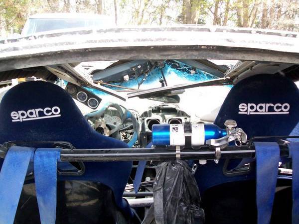

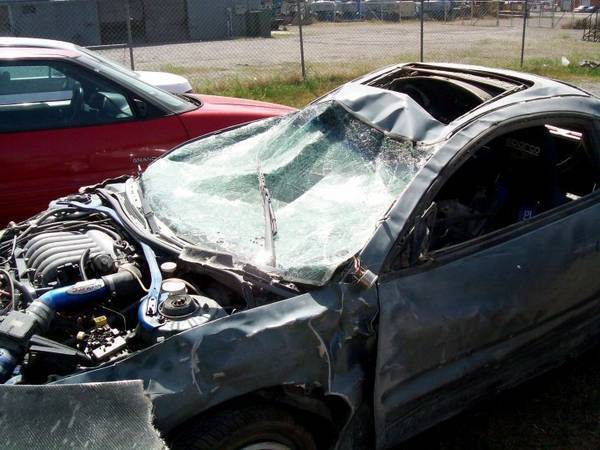

    Last April 15th my roommate got in a gnarly rollover crash in a Mitsubishi Eclipse on a ridge slamming into a guardrail at 110 mph. The guardrail's wooden posts gave way immediately and acted as a ramp that flung them into the air about 40ish feet down and 200ish feet forward (110mph is pretty fast). The car rolled in the air about 3-4 times and landed UPSIDE DOWN in a giant pile of Pea Gravel (we were being stupid and street racing right next to an asphalt manufacturing company).
    They walked away from the crash with minor concussions, a messed up ankle, and several scratches and are almost completely healed to this day.
    They are alive for a few reasons: Most importantly the pile of Pea Gravel that cushioned their fall, a set of Sparco Pro 2000 Racing seats with 4 point harnesses, and a crude rollBAR just barely covering their heads.
    Seriously, not even a full cage, but just a single bar behind the seats in the cab that was also used to secure the racing harness.
    Since I probably will get a "worthless without pics" banner, here ya go, TW:
    I'm not sure, but I think the roll bar was made of the same metal as the harness mount bar...not quite sure:

    Yeow! Bummer you needed it but freaking wonderful that it worked!
    What material was the rollbar made of and what size tubing? The Eclipse is a unibody, right? How'd you guys attach it to the car and did you have any bracing to keep it upright?
