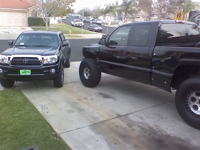

    I wanna keep the Tacoma the daily driver, but with the touch of show and go... The Silverado is the main project in the garage right now...
    I'll get some more pics up soon...

    Regardless of whether it's the site for it, post some info on that Chevy! Just from that picture I can see lots of rubber, fiberglass fenders, and some serious mods to the front end. The tires don't look overly aggressive so I'm going to guess you run sand with that beast. Am I close?

    I'm gonna start a new thread and post some pics so I don't hijack this one...
    It does see sand the most but the Baja T/A's haven't failed us yet in other conditions...
    I'll get some pics up soon....
