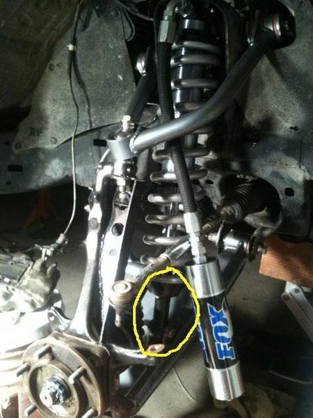

    thanks man..here are a few more from yesterday and finally some pictures of me actually doing some of the work
    cutting the shock mount to fit the reservoir hose
    a little straddling never hurt nobody...

    What did you have to cut? Mine fit without cutting but I have a 1st gen. If you cut a notch in the tower make sure you gusset that shit.

    I'm 4wd and it is just a little notch for the hose. You think that should have a gusset?

    Oh yea I see. I would def stregthen it before you bash it. They say to add strength to the mine and its not even cut. Most people say the secondary shock hoop works well. It mounts to the top of that tower so it adds stregth to the coil mount too. Im new at all this too but that is what I have got from the experienced people here

    yikes..ok good call. Looks like I'll be doing some reinforcing...but really though, having to cut that for the hose is wack

    I think its because on the 4wd you have to have the lower spring plate on your shock higher to clear the driveshafts. Look at the difference on the lower shock on yours and mine. I think the 2nd gen 2wd is like mine
    Yours
    Mine

    Looks awesome but is that resi mount permanent? It looks like those hose clamps are really close together
