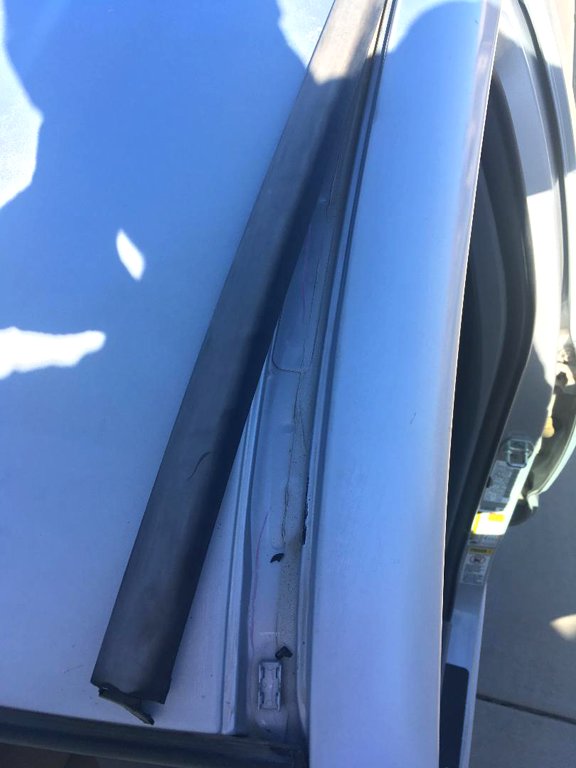

    So driving through the $5 car wash this morning I hear a thud, not sure what it was. Get out to vacuum and dry and see this. Anyone know how this is fastened down?

    Has lockers a skewp and a bit of droop
    Get some 3M double sided tape,, good as new

    Yep 3M tape, and you can stick it down on that clip that you can see in the most front in the picture you’ll be fine any car washes I would be very hesitant

    Marine grade silicone also works. They sell little squeeze bottles of it (in black) on Amazon and at hardware stores. That’s what I used because I already had it laying around.

    The molding is already oxidized and chalky so it doesn't have much life left.

    Pull them both off, paint them, then reinstall. I used Rustoleum Bumper and Trim on mine. Came out great!

    That's the little plastic piece in your pic (an inch from the windshield) that it snaps down to and then in the rear I believe its only double sided tape. Last time I checked (before Bidenomics), the moldings were $80ea on the discount toyota parts site.

    I used 3M Tape to hold mine down after my Prinsu install.
