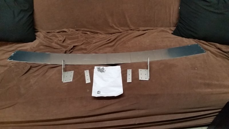

    FedExjust delivereda big package to me can't wait to get it sprayed and installed. Product looks top notch 20151211_205039.jpg

    Finally got mine installed. Had to enlarge the side mounting holes on mine for my light bars, middle sags a little bit so gonna see if there's any wind noise or not.

    Curious on my 50inch, 1 side I mounted on the 1st set of bolts and on the other side I had to mount it on the 2nd set...is that correct? Or is my lightbar off...

    A couple notes:
    - I'd be nice if the slots were sized for an M8 bolt, rather than M6. Seems like most light bars have M8 bolts.
    - I had to bend the end brackets out pretty significantly to fit around my 42" bar.
    - Mine was flapping around in the wind like crazy. So much so that I pulled over and unbolted it. I'll have to figure out how to get it mounted more snugly to the bar and put a brace in there.
    It really does get rid of the glare though. Way, way better in that department.

    I suggest drilling a hole in the center of the visor and the lightbar itself, and use a small bolt with some washers to get rid of the flap, sag, or rattle... this has been my number one complaint, ill get some pics of of the fix..
