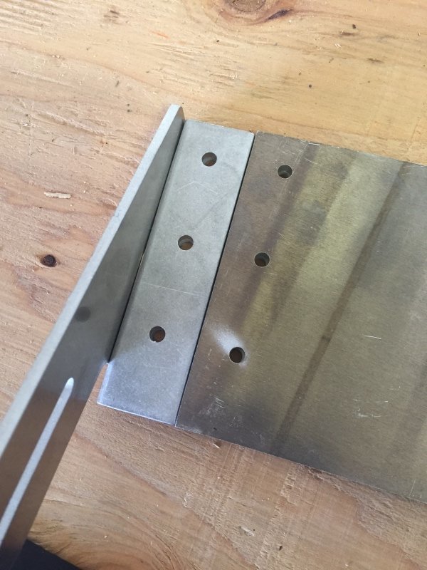

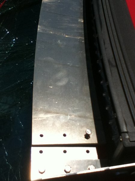

    Arrived today. Looks good. Have to enlarge the hole for the light bar bolt (not a bad thing), and need to make new spacers the same thickness as the rest (they are a bit thinner), but it looks like it will work well. I'll get pictures later when I get it on.
    New spacers are going to be half an inch wider on each side. Got the side brackets on and the visor is an inch short. I'll get new spacers cut and welded onto the visor then bolted to the brackets.

    anyways that looks like a manufacturing defect, like the holes were drilled in the wrong spots.. so you made some wider spacers to fill in the gaps? is that what happened?
    everything should fit together perfect like this:

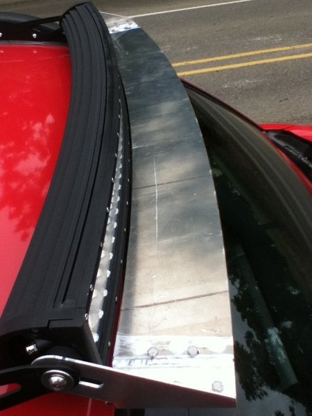

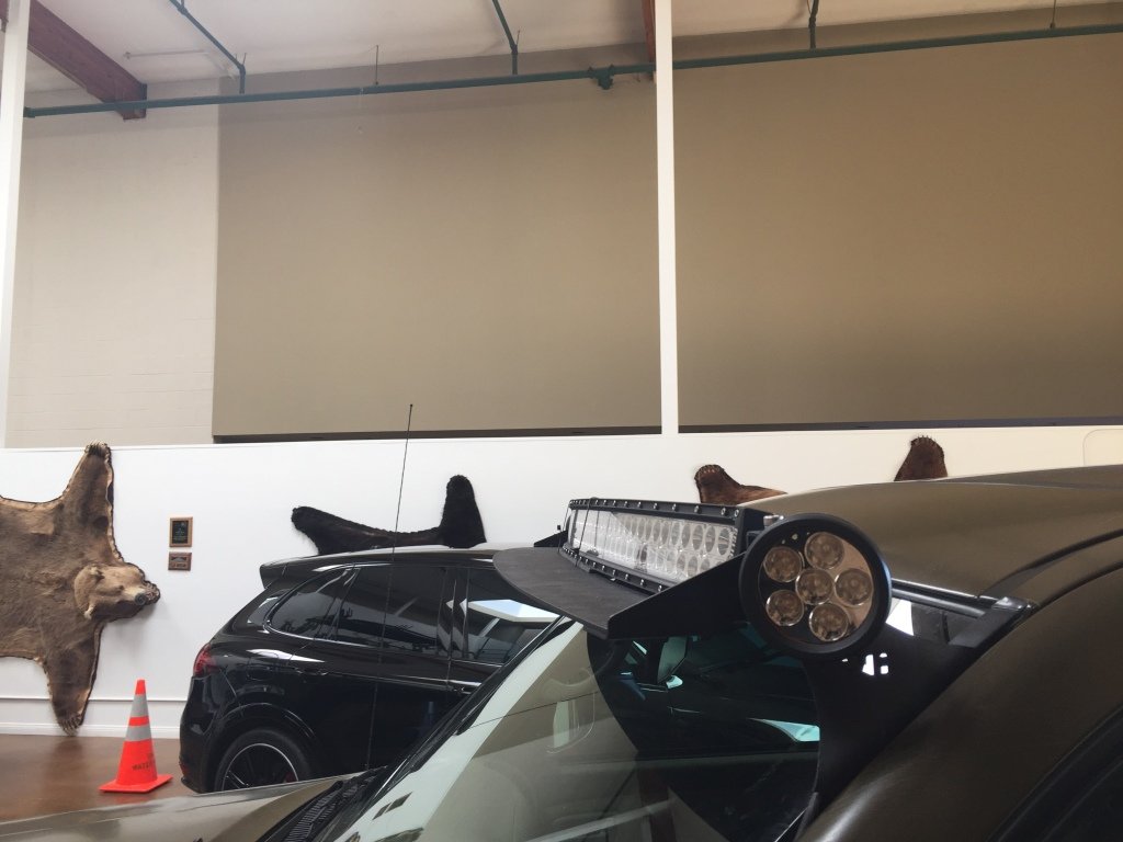

    The issue was that the main piece was actually too short. My picture that you quoted shows how short it was with one side set in place with the spacer as your picture. What I did was get some aluminum and welded it onto the main piece then re-drilled the inside holes on both sides. I used stainless fender washers and longer bolts to hold it all together.
    I made brackets that slide into the fins on my bar and then bolt to the visor. It got rid of almost all vibration on the roof and wind noise from the bar.
    I also put a small stainless bolt on each side through my RC brackets and the brackets for the visor. That did very well at locking it in place with the light cutoff line being right on my hood rock guard.
    Pictures taken during mock up.
