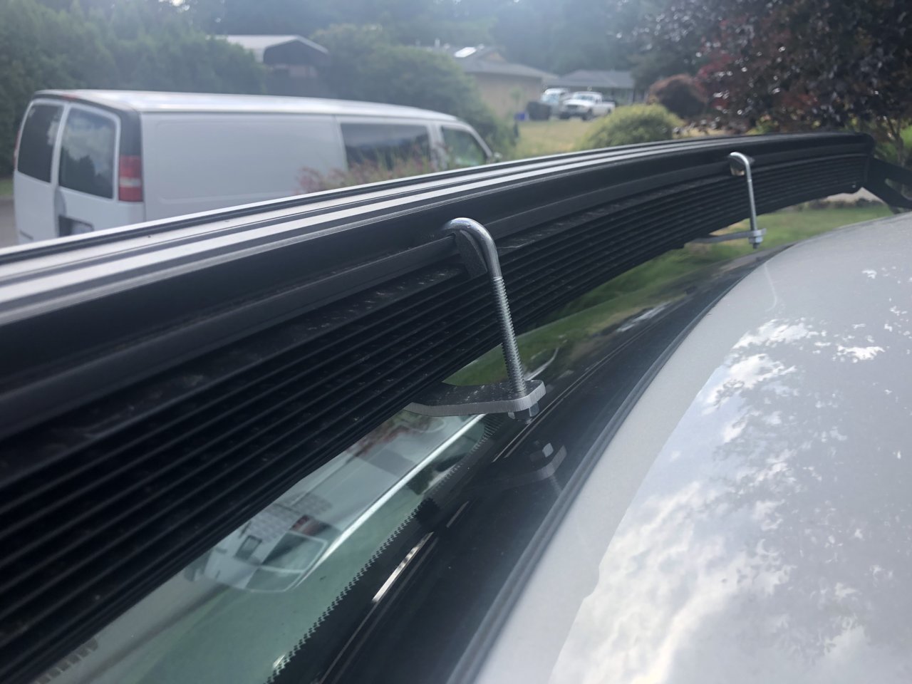

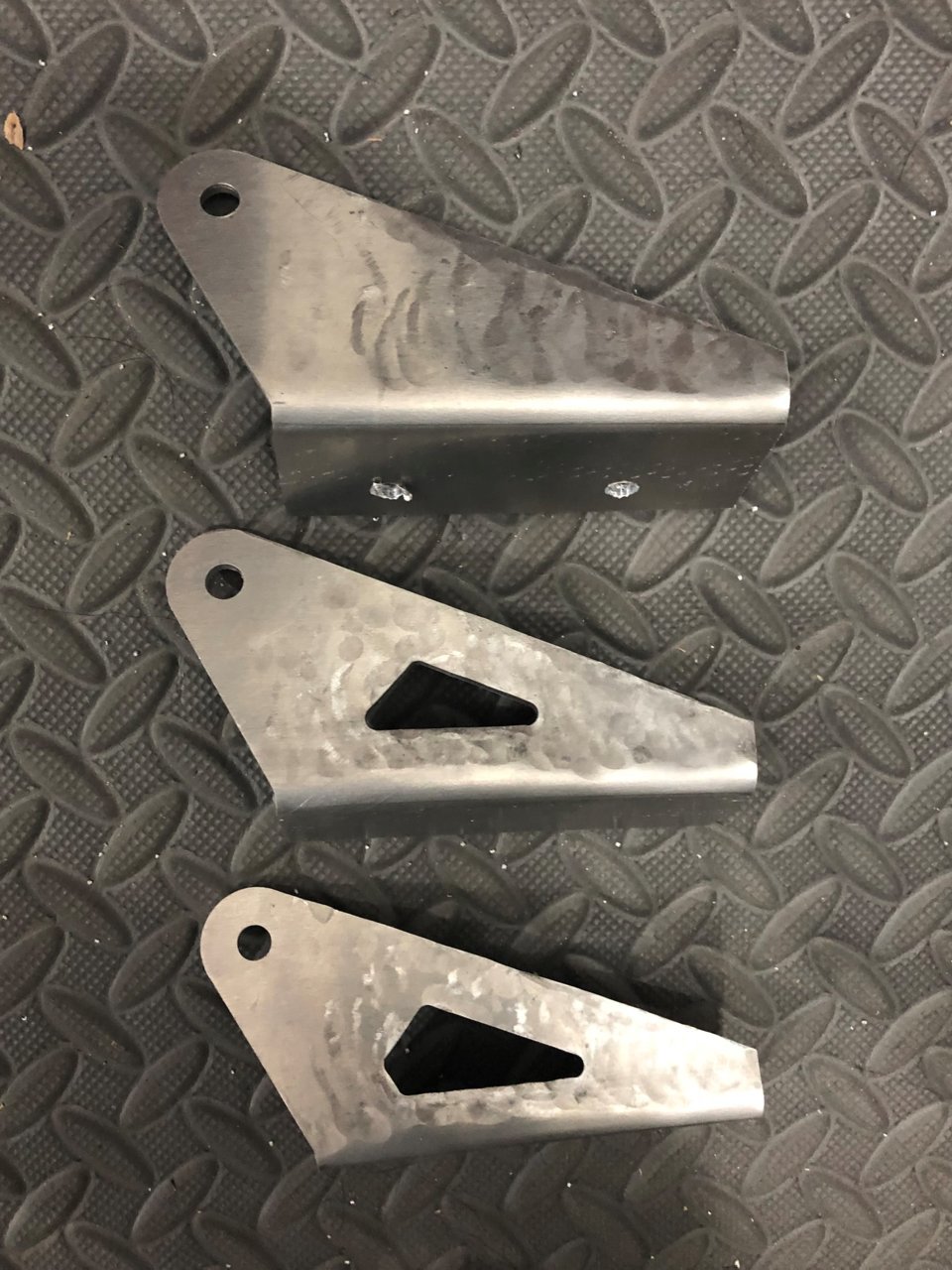

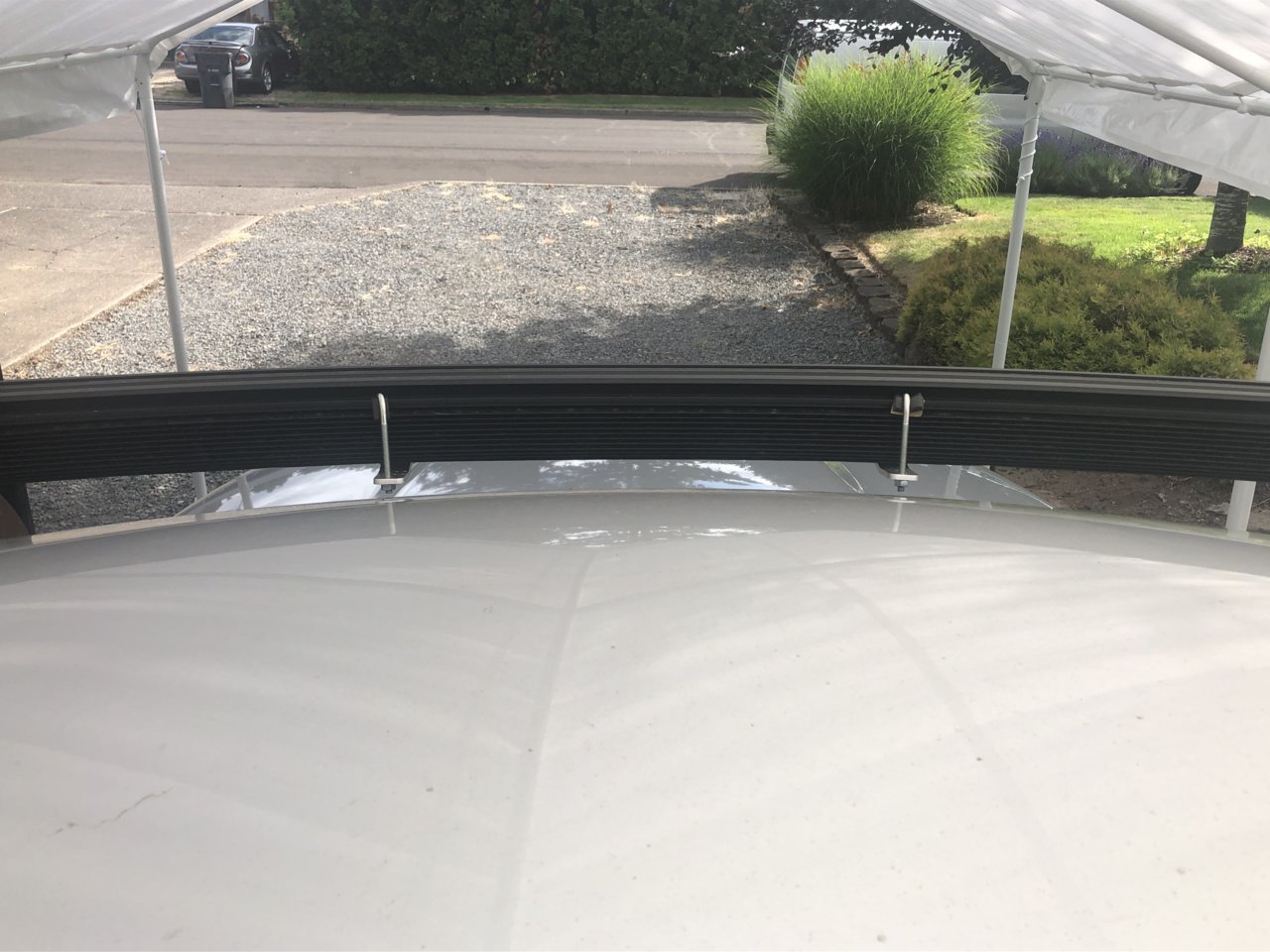

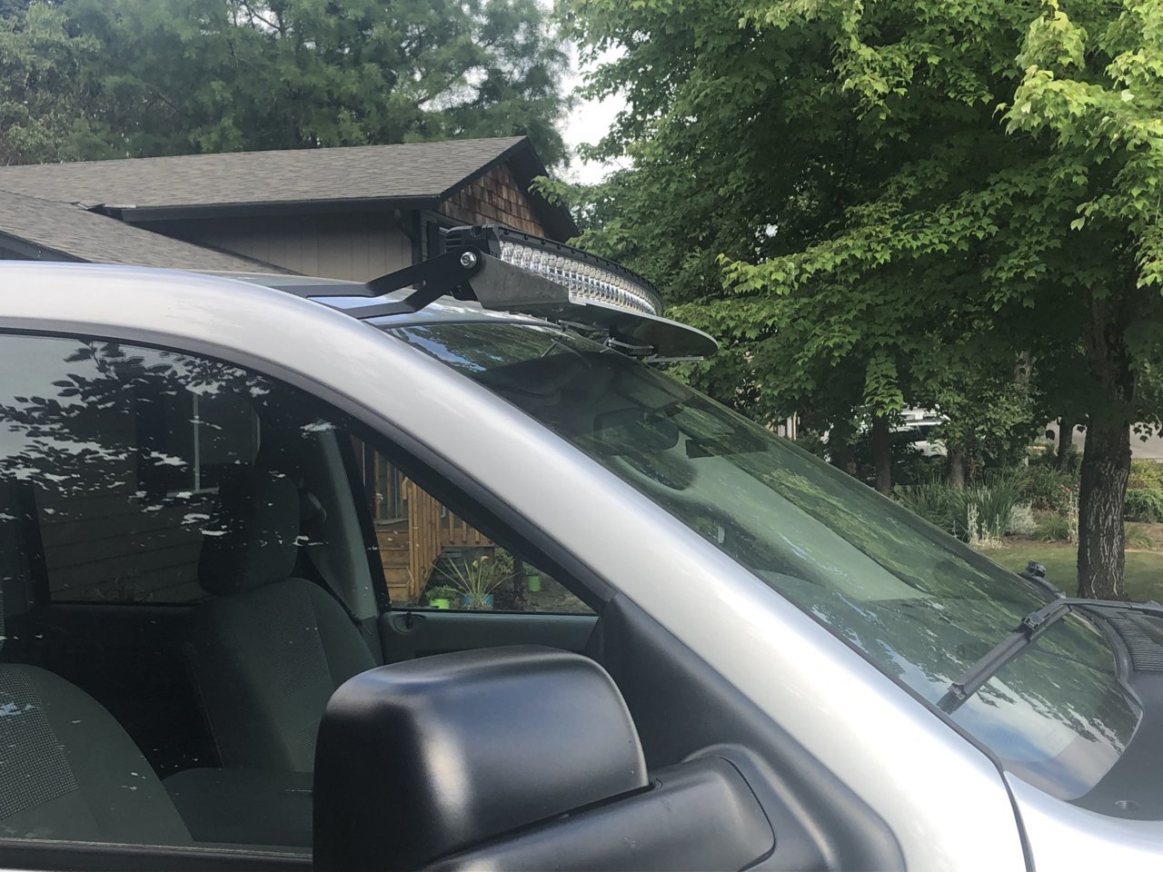

    I made a few of these with my own little twist, so I have a couple I will sell. I have a Rough Country light bar and the design of it lends it to have J bolts to act as support to keep it from flapping in the wind. I had the visor cut with two tabs that go under the light bar and stick out the back for the J bolts to attach to. I used set screws with nylon tips to keep it tight and not scratch it. Turned out very well for my setup. I made a few designs for the mounting brackets.
    I made these to fit my Ram that has a 54" light bar, so it can be cut down to fit any smaller size. Definitely weren't cheap to make so I'm just looking to make back the cost of them. Not sure how much shipping will be, but if you're interested, shoot me your address and I'll get you a price. $150+ shipping
    IMG_4896.jpg IMG_4899.jpg IMG_4908.jpg IMG_4905.jpg IMG_4915.jpg IMG_4911.jpg

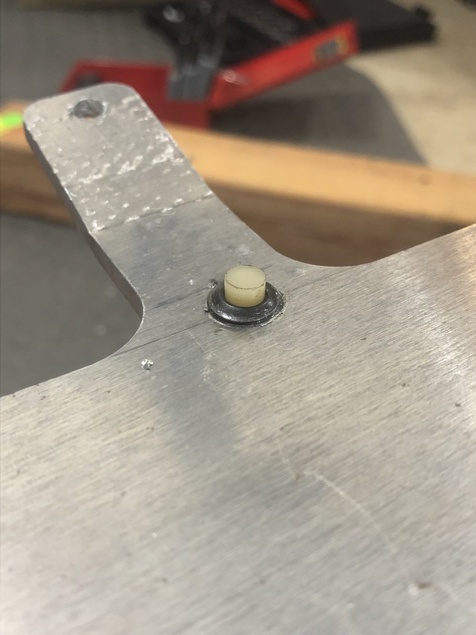

    Hey. What are the white things with the grommet for? Isolators for the light bar?

    They are set screws with nylon tips. The J bolts pull up on the visor to keep it from flapping in the wind and the set screws give the visor a “stop” so the visor doesn’t get pulled all the way up to the light bar when the nuts on the J bolts are tightened. The nylon tips keep the light bar from getting scratched/damaged. Rock solid mounting and no wind flap.
    bkrdave36[QUOTED] likes this.
