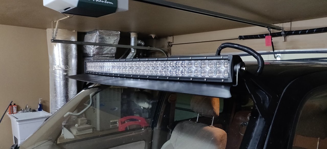

    I happened upon this thread after putting a 42" curved lightbar on my 96 4runner, and getting a lot of glare on my windshield. I ended up making my own visor, since the 54" one listed here seemed like maybe a little too big of a piece to start with.
    I wanted a way to attach it in the middle like insano7101 had theirs, but I decided to try to use pop rivets going into the bottom fin of the light bar heatsink. That may void the warranty of the lightbar, but it seemed like a clean attachment method.

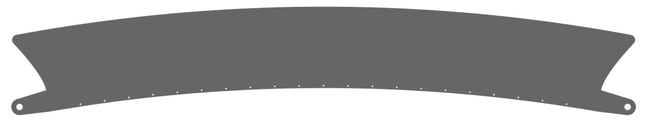

    Did some measurements of my bar and drew up a design in illustrator. I had it cut and shipped by the folks over at sendcutsend.com out of 0.125" Aluminum 5052 for about 60 bucks. Note that my light bar was a 42" inch curved Auxbeam lightbar. Your mileage might vary for other brands.
    The pattern that I sent to sendcutsend looks like:

    The tabs on the end need to be bent up to make brackets that match up with the light bar mounting screws. I did this fairly easily with a vice, some steel strap, and a pair of long needle nose pliers. My understanding is that the Aluminum 5052-H32 sheet metal bends pretty well, and it did. I think other alloys though, like 6061 will be less forgiving and snap.

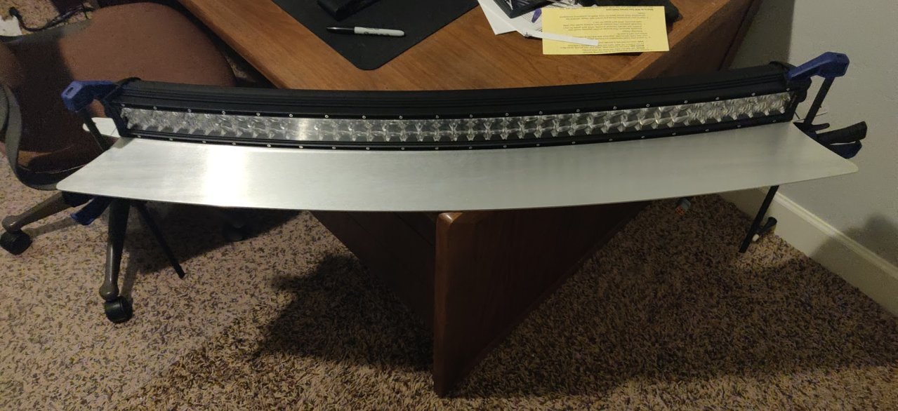

    The shipped piece and my light bar:
    oMC6F85B8Ru6bBmkHISy0dzxBidrBdDQHdAjBWPn_040f41b7dd1b7e7dd32bbb61dbfc45b37dc84e77.jpg

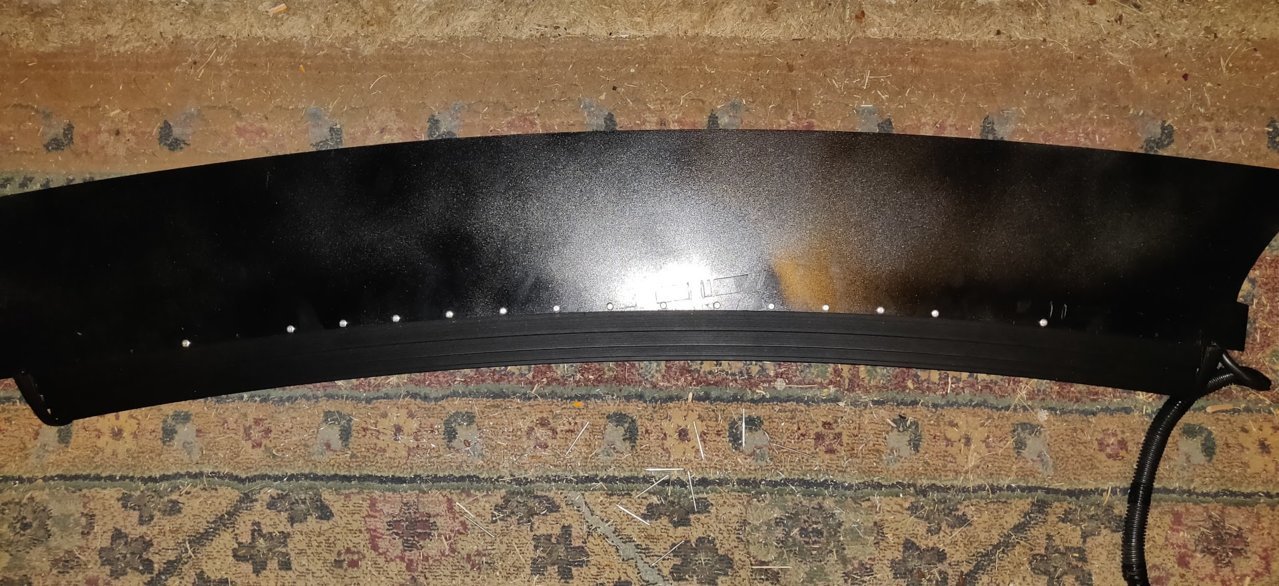

    After bending the end tabs, I painted the visor using some self-etching primer and black rustoleum. I lined up the bar, and drilled holes for the rivets in the bottom fin of the bar. I used 1/4" grip 1/8" diameter aluminum pop rivets.
    cn8l62_D9dGAAlFBcQc4Cm5T_GewAf8y0WE1oa9s_b950cc19fb0575c5125b62b8c3cefcf7f96e1e72.jpg

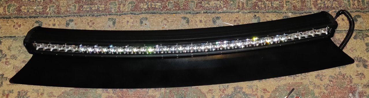

    The attached visor from above:
    ZlEnn5svMK8c1UBIe9VaMQqW93jb4_PuyTLz_9ex_b917d6e047bd1048c4481616f30f22e9524b4061.jpg

    So far it seems like everything is working pretty well, but I've only had it on for a few days. I have a lot less glare on my hood and windshield.
