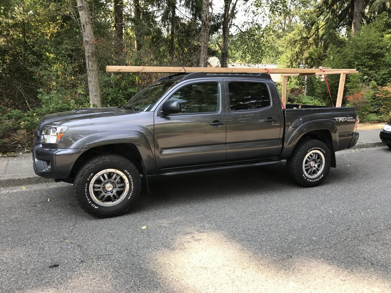

    Factory rack is ultra light, made of composite and aluminum. Cross bars fold out of the air stream when not in use to in inline with the cab and are great for grab handles to climb up the cab. Folding out of the airstream reduces air turbulence, wind noise and increases mpg by reducing drag. When needed they fold out across the cab to carry the load and have a few tie down points. Brilliant design for those that care about the details.
    I put a 3rd gen rack on my 2nd gen (they fit and have a higher weight rating) to carry some 16' deck boards:
