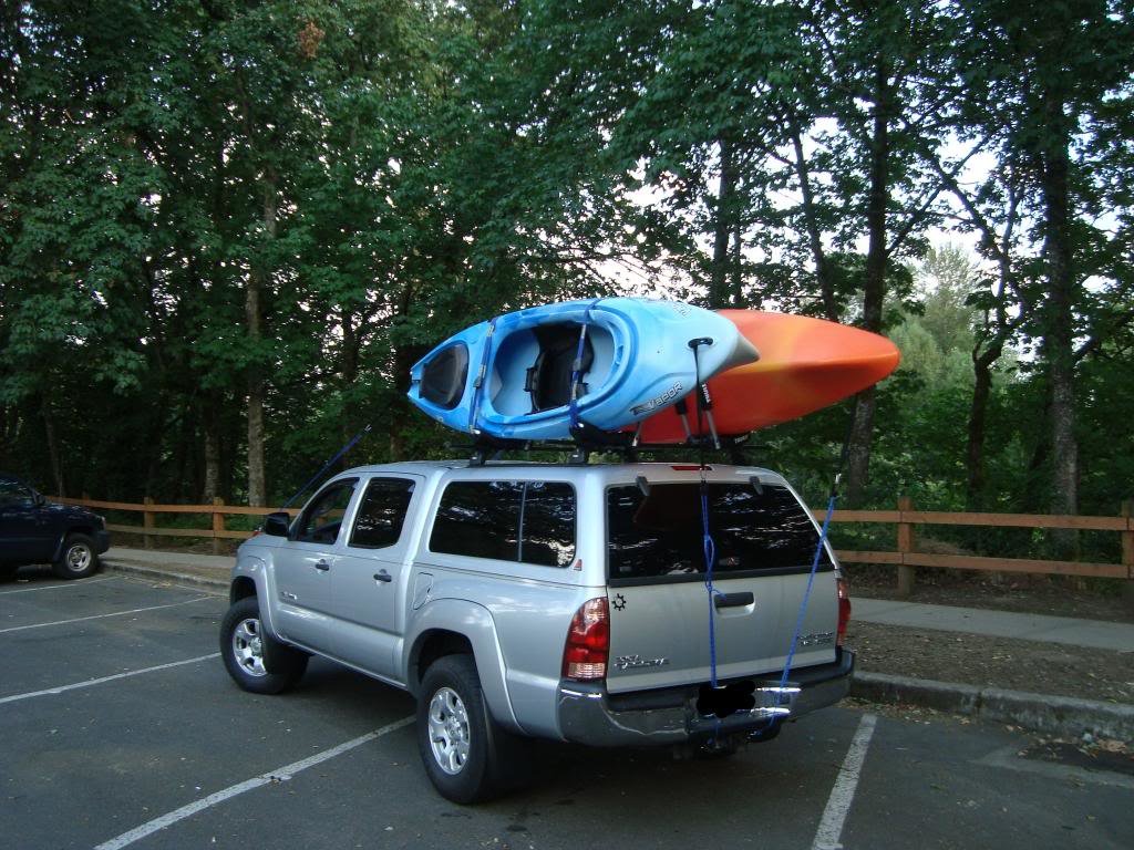

    On my 2006 I put a Thule system on top. Simple low profile rails attached through the cab. Then added the feet, cross bars, and Heliport kayak racks.
    Sold pickup and bought a 2014 TRD Sport. Ordering my Leer canopy today (probably the 100XR or XL). I will have the Thule rails installed by the Leer dealer. I had no issues.

    No hassle...could not find invoice but I know I used:
    Thule Permanent Base Track
    http://www.rackattack.com/thule-permanent-base-racks.asp
    Thule Load Bar
    http://www.rackattack.com/rack-search.asp?searchString=Thule+load+bar
    Thule 460 Fixed Podium
    http://www.rackattack.com/rack-search.asp?searchString=460
    Thule 3101 Fit Kit (attaches the 460 podium to the track)
    http://www.rackattack.com/product-pages/thule-podium-fit-kit-3101.asp
    NOW...I just ordered my new Leer 100XR canopy with factory installed Thule tracks and they look different than the ones I had installed my 06'
    But the dealer said the 460 podiums will fit...we'll see.
    Good luck.

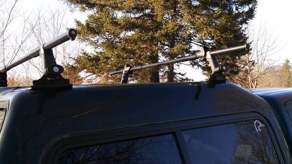

    That's the DeWalt Prorac that used to be what Leer installed on their RCC commercial caps but it has since been discontinued
