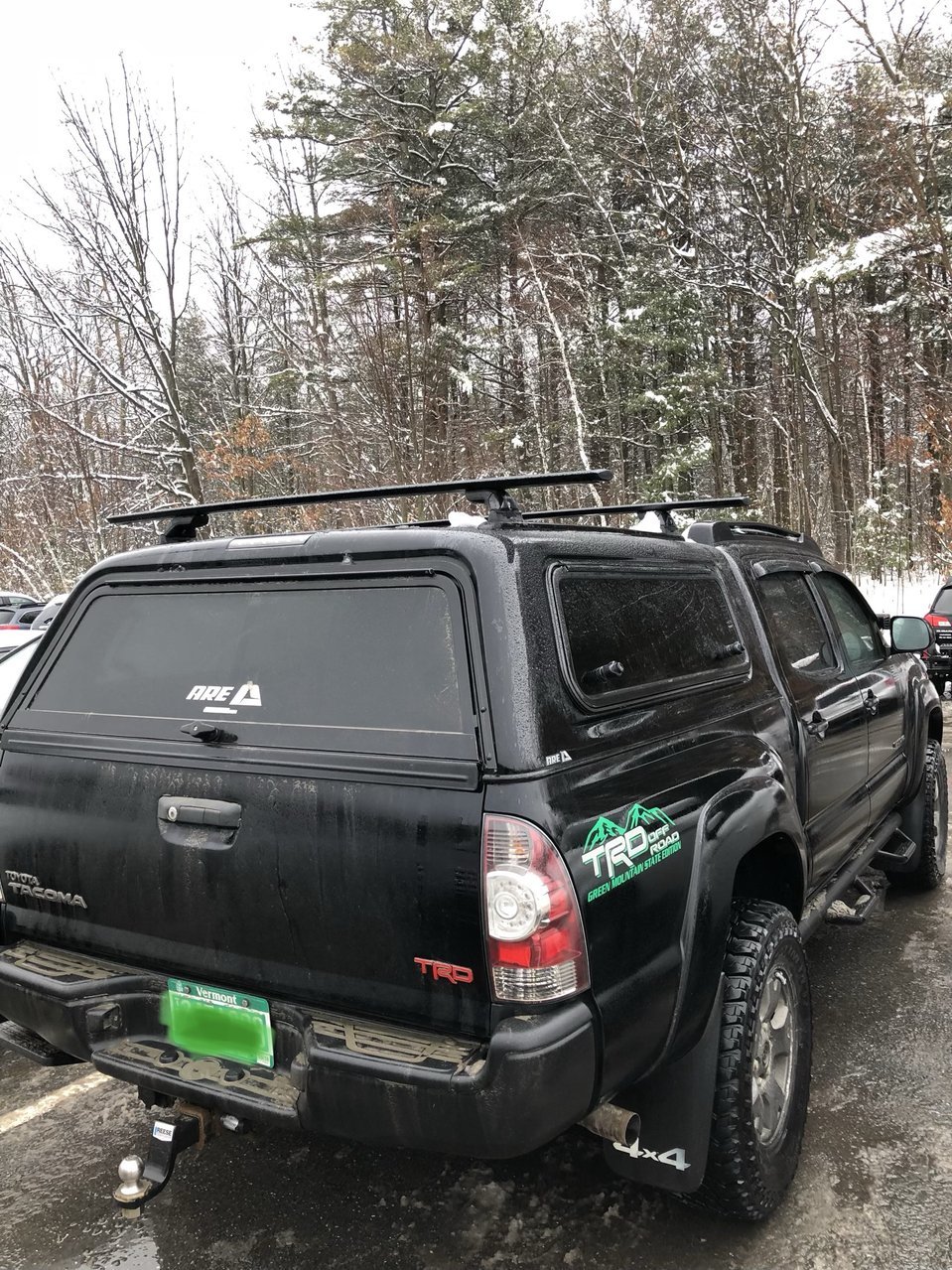

    ARE shell w/ Yakima rack system. I had the dealer install the tracks and I took it from there.

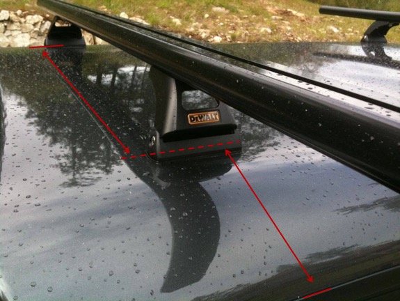

    Hey old friend. Been working on a new to me 100RCC cap and I was wondering if you wouldn't mind grabbing a couple measurement for me? Been trying to find these dimensions and I'm coming up empty.
    - Distance between the left and right mount bolts
    - Distance from the mount center to the window radius
    Thanks OZ!

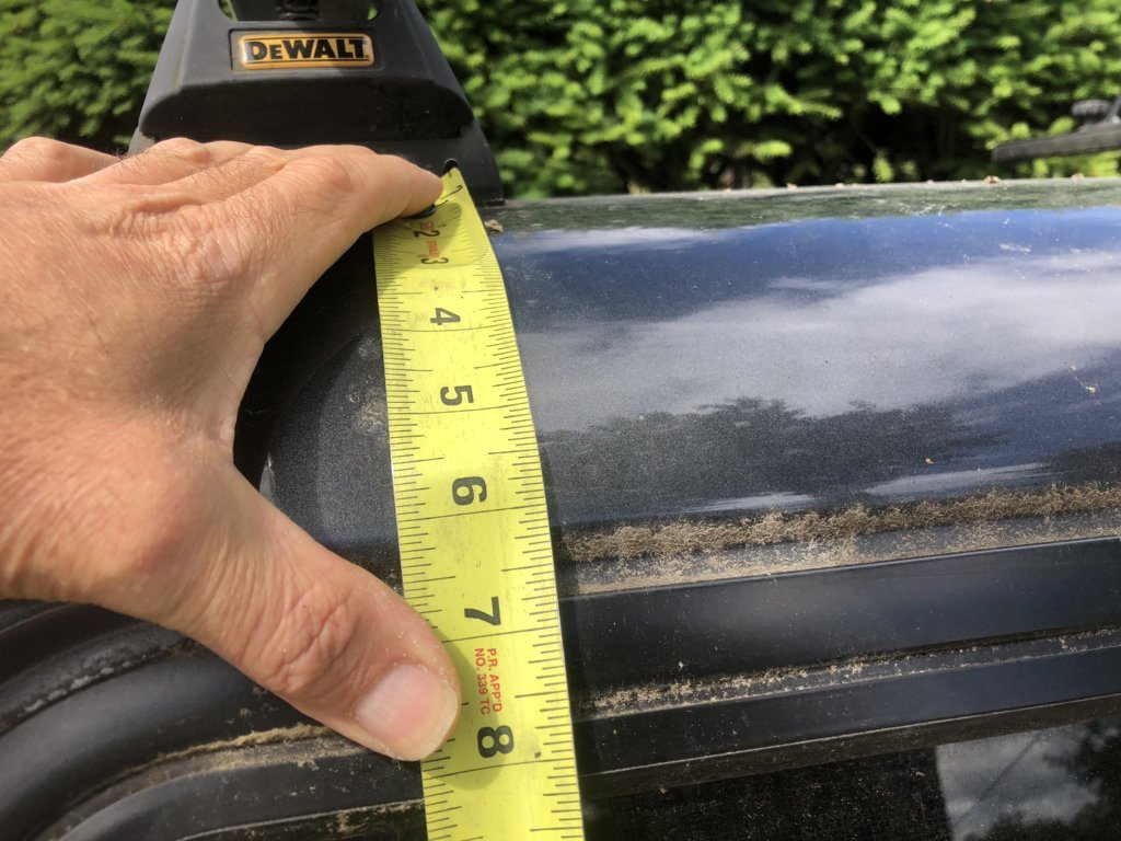

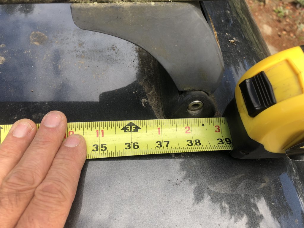

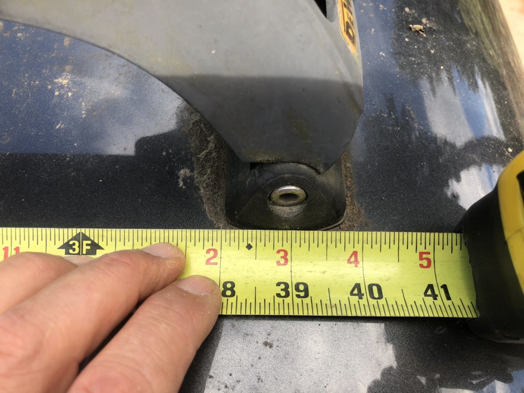

    Yolandi , broseph
    Centre bolt to bolt ~ 38 3/16"
    Hooked on foot to outside of opposite foot ~ 39 3/4"
    Butted into foot , wrapped down to edge of window indent ~ 6 1/4"
    Don't hesitate if you need any other help
