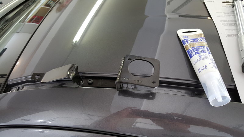

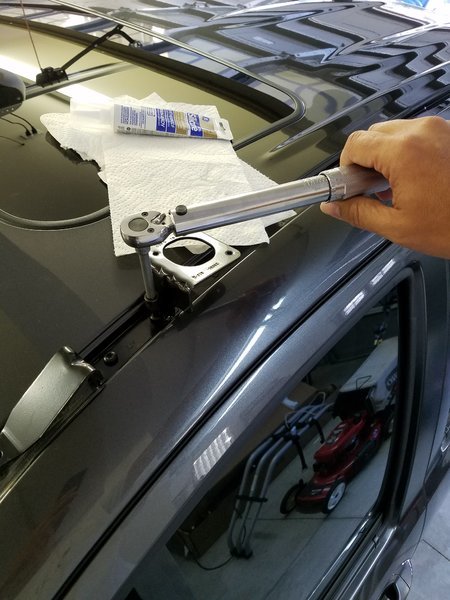

    I have installed two OEM roof racks now:
    2nd Gen kit: PT278-35130 (my 2014 DCSB, 2 years ago) Hardware kit is 401941.
    3rd Gen kit: PT278-35140 (my 2017 DCSB, today) Hardware kit is 401941A.
    The 2016 ditch molding is different, it's now in two pieces, unlike before. The hardware, despite different part numbers, appear visually to be the same. The front brackets appear to be identical, and the rear three cab bolt holes also appear to be the same in size, location and spacing, although I can't definitively say that they are in "exact" same location. The installation manual spans 2005 to present, and the instructions are the same (I compared the instruction sheet with the old one that I still have).
    Compare:
    2014 front bracket
    2017 front bracket
    (LOL that's the same tube of silicone I used to seal the 2014 bolts 2 years ago!)
    2014 passenger side
    2017 passenger side
    The only real difference between the two installs that I could discern are that the bolts appeared to be lined up better than before, and that the newer part number cost $50 more than the old one (paid $250 shipped 2 years ago for my 2014 kit, this new one was $300. Bas***ds.)

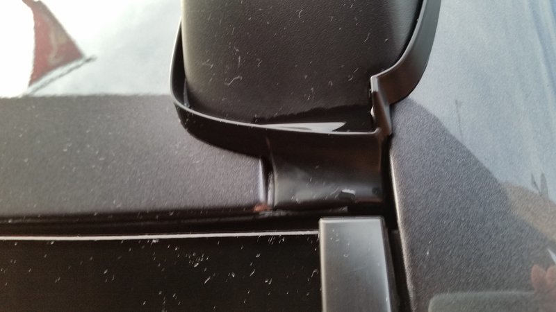

    16 TRD Offroad
    Just installed them. It was really easy, but one of my wellnuts had weld inside thee threads. So I just drilled it out and put in one size larger screw. Worked fine.
    Also, I didn't have much of a gap on either side. I have seen pictures of others on here with more of a gap than this:
    Maybe it has something to do with when the rack was made.
