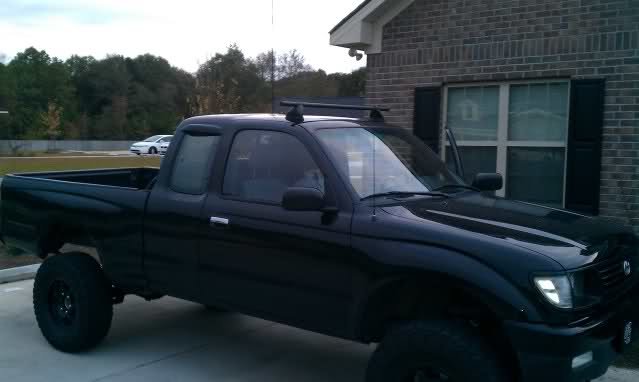

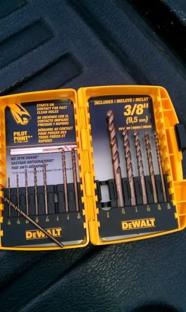

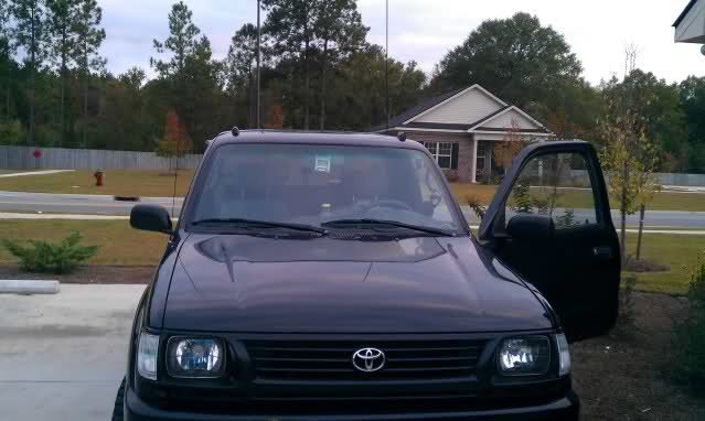

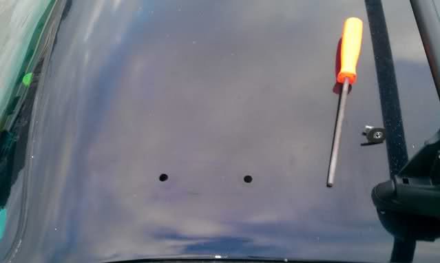

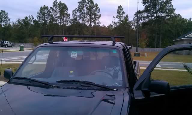

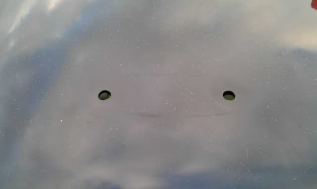

    mkay fellas well i finally went to mount my rack and ran into some issues :( i accidentally pierced the headliner in one spot(its not that bad really)!!!! and one of the fasteners broke so i need to call Yakima and get a replacement :( so i could only install half of my rack
    It was a pretty easy install i started by assembling everything and getting everything centered and where i wanted it on my roof. then i started with a 1/8th drill bit and made my way one drill bit at a time up until i hit 3/8ths at this point the hole was barely too small but if i went the next drill but size up it would have been to large so i hit the hole with my dremel and a grinding bit.
    I then touched up the marks with some paint, applied silicone to both sides of the fasteners attached the landing pads then the roof rack and DONE!!!!
    Mounted up:
    With the rack removed and the landing pad covers installed:

    How did you get your signal lights to shine all of the time?

    Looks good wolf. So the fasteners only go through the sheet metal? How strong do you say that rack is?

    Look up the "turn signal mod"
    Yup the fasteners where actually pretty thick, and the roof was MUCH thicker than i was expecting. so i have absolutely zero worries about strength. I am not going to ever put more than 100 up there because the basket i plan to get is only rated that far. The landing pads and fasteners where rated at 150lbs and honestly i can believe it. After install i tried to "break them" and i was shaking the whole truck and the rack didn't move a millimeter.

    How does the rack hold to heavier weights if the only support is from the sheet metal? Are the holes centered on the roof supports?

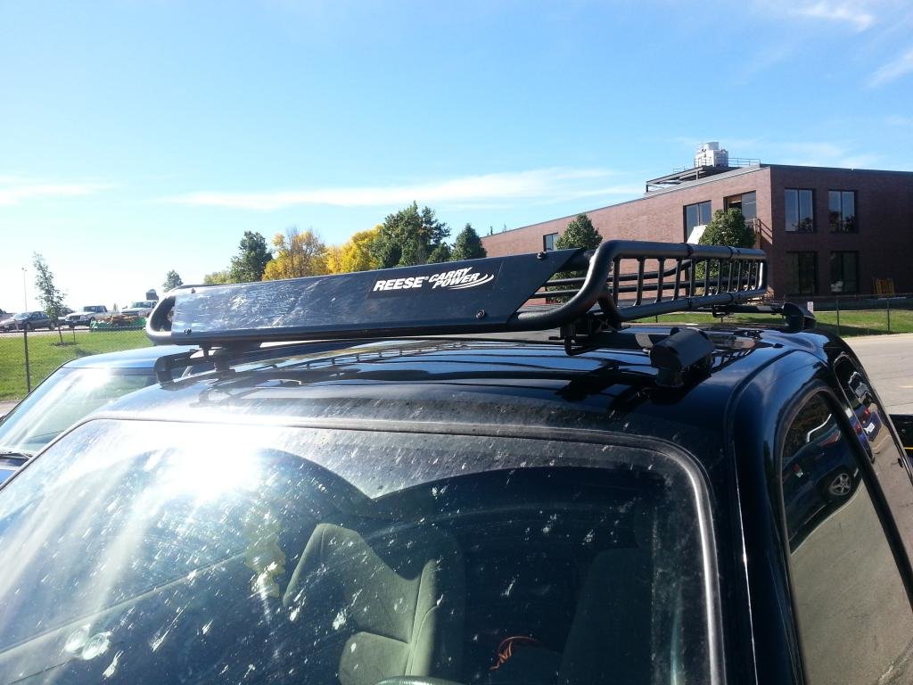

    I hacked up a rack off a wrecked blazer... PITA but it looks ok I think and it works...

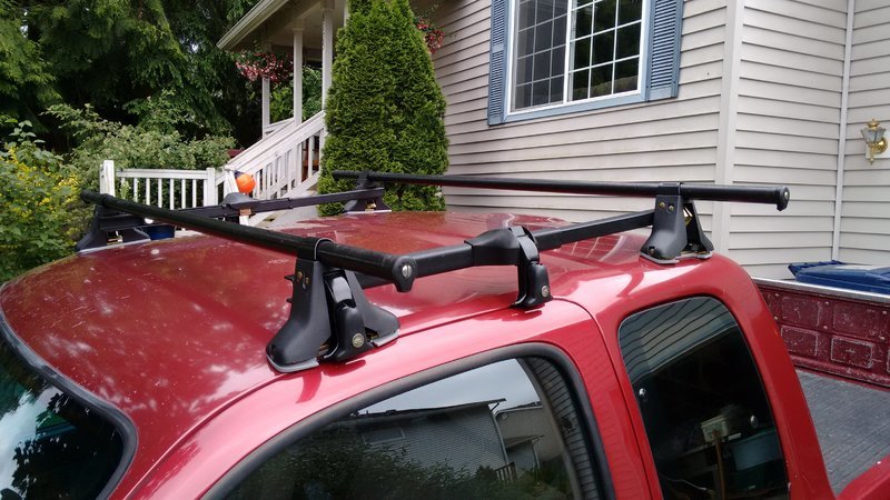

    I just put a "new" Yakima rack on my 96 ext cab for far less than retail.
    I purchased bars off Craigslist and the towers, clips and a short roof adapter off eBay.
    My set up:
    Yakima SST towers with locks - old, but ReRack in Portland had them on their eBay store.
    Y6 clipsfound - some on eBay.
    Yakima Stretch Kit for SST towers - old, but ReRack in Portland had them on their eBay store.
    58" load bars.
    Total cost was about $130. The SST stuff is old. Yakima stopped it in 1996 or so, but the items ReRack sold me had never been used.
