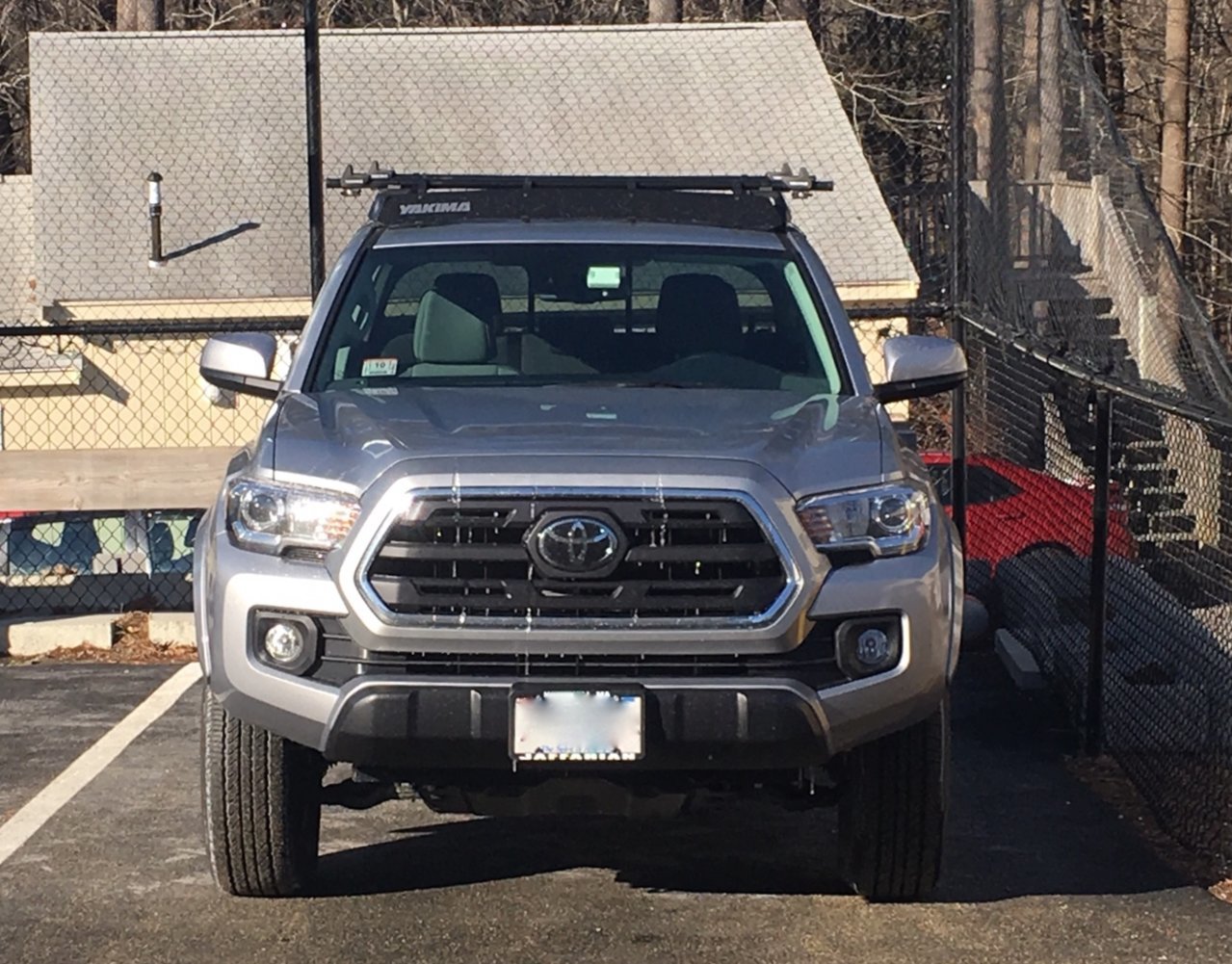

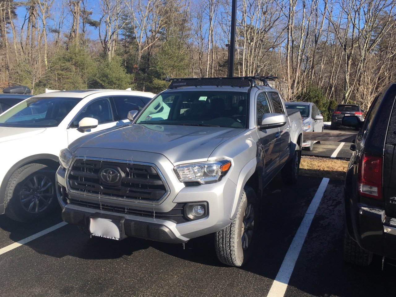

    I realize this may not fit what you're looking for but just to throw it out there...
    We have a standard Yakima rack on our cab. The bars clip to the door jam and you can attach just about any Yakima (or Thule) accessories to them.
    (Thule also makes a similar set up.)
    They make several styles of crossbars to choose from. We already had a set of round bars so buying new feet to move the rack from our Subaru to the truck was the cheapest rack option for us.
    Just note that if you go with the standard round bars, you'll want a fairing (otherwise it's extremely loud) but if you go with the JetStream bars (like the one's shown in this video: https://www.youtube.com/watch?v=3pqhLFVaRh8) you shouldn't need one.
    No it's not quite as hard core as the Prinsu or Frontrunner racks, but it's a little less expensive, doesn't require any drilling and it can be taken on and off (with relative ease) if you want.
    It's a solid rack and does just about everything we need for carrying skis, bikes, kayaks etc.
    Will run out and snap a quick picture in a few minutes.

    I had some concerns about that as well, but read from some other folks on here that it hasn't been an issue. So far I haven't noticed any scuffing. The clips and feet are padded pretty good with a layer of rubber so there's no metal on metal. And it's on there solid, so it doesn't move or shift around at all. I did made sure the truck was clean and waxed before putting it on so that there'd at least be a bit of protection and I'll probably remove the rack at least once a year to clean underneath any contact points. Have had Yakima or Thule racks on every vehicle I've owned since I got my first car in '97 and have had zero issues with all of them.
    Here's a few pics of our set up. (Right now it's just the bars, fairing and some canoe brackets (which work great for lumber as well BTW), but you can imagine how a ski box or bike racks might look up there.)

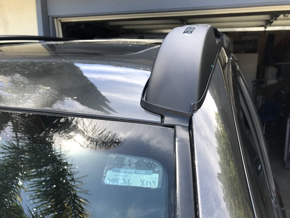

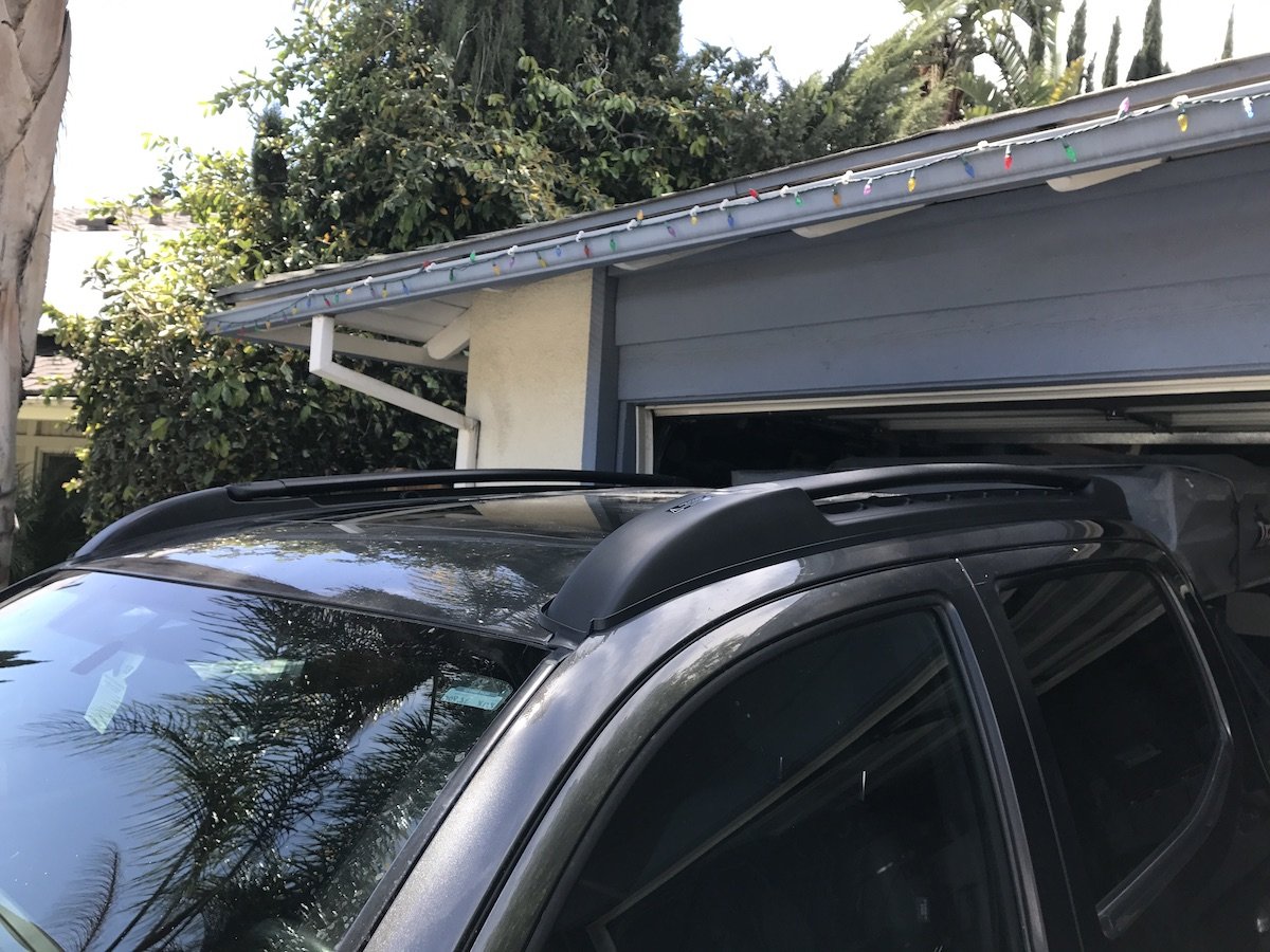

    I bought and installed the OEM rack (~$300ish), mostly because I wasn't ready to drop $1200+ and all I needed was the crossbars to mount a storage box. It went through these last few CA rainstorms without a leak (I also ran it through the carwash when I first installed).
    I can barely turn a wrench and this was an easy installation. I just made use of excessive silicone sealant around the brackets and bolts. And hell, we both live in SoCal. If it leaks a little, it won't have been massive and you can take it off and reseal it.
    I think the real valid criticism is the low carrying capacity (I think it's around 130 lbs or so).
    Don't let me talk you out of a nice Frontrunner or Rhino, though... It's just that there are so many Tacomas on the planet, if anything can possibly go wrong then it has gone wrong for someone and they've posted about it.
