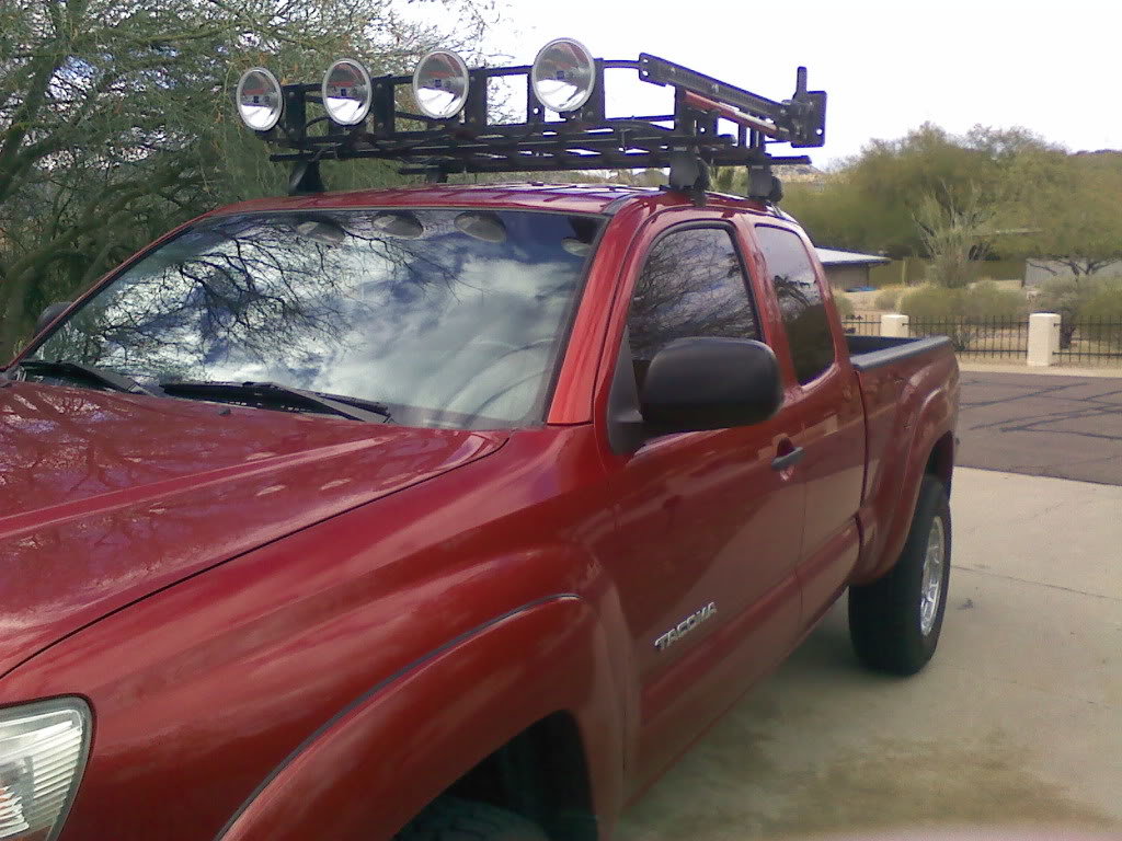

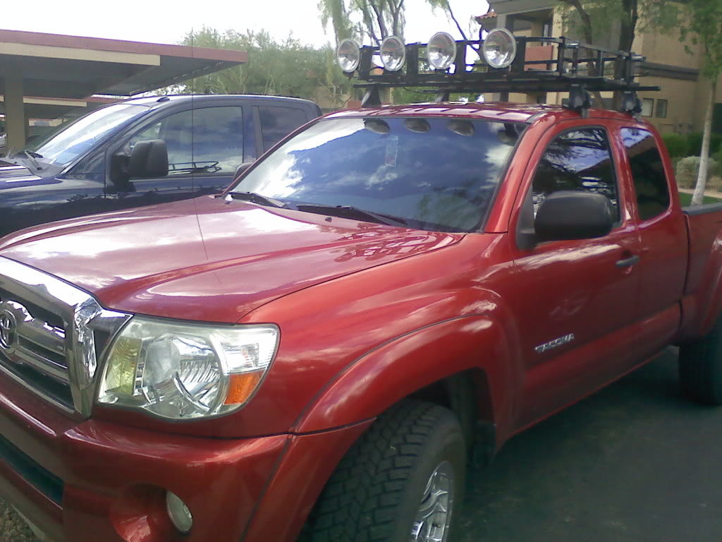

    Wilderness rack on Thule bars on my access cab
    sorry they're crappy cell phone pics :(

    question how did you run the wires for your lights? Did you have to drill into the cab?

    The front lights i ran down the driver side of the windshield, the wires fit perfect between the window and some of the weather stripping but I dk how it is on the 1st Gen. However for the lights i have on the back of the rack (2 bed lights/backup light) i wired by running the wire down the backside of the suicide door then under the foot of the door frame where my other wires are running then through the firewall under the steering wheel.
