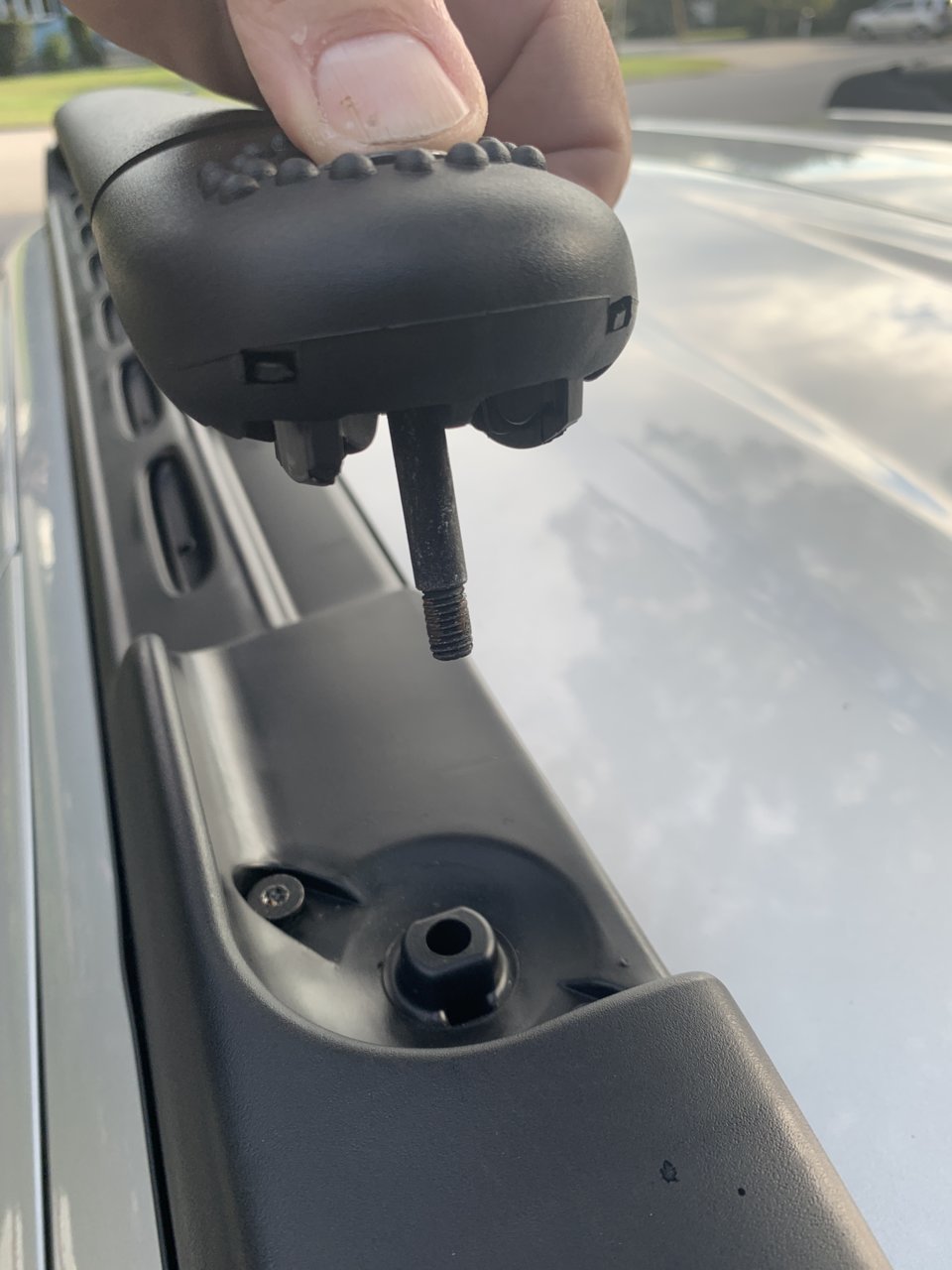

    FFB064A0-23D9-43E6-ABD2-4C02BA3CDB0F.jpg Hey guys just an update I went OEM because I’m not going to carry a lot of weight and I like the look of it and the dealership told me that it would not fit because it only fits 16-21
    Toyota wrong again
    But I have one question the passenger side came with the crossmember not connected but they did give me the screw to put through it and screw into some thing for the swivel point on the passenger side I have nothing for that screw the screw into any help would be appreciated how I can adapt Without removing it from the truck

    Wish i could help you. Its been a long time since i installed mine. Weird that they didnt finish installation on your truck. I would definitely go back and have them do it, not because its difficult, but because you paid for their service. God forbid you install it and something happens they wont cover it…

    If i remember correctly, the instructions stated not to apply too much downward force when torquing the screws. I guess it pushes the tap plate out of the holder—something that, if i remember correctly, results in you not being able to screw something in. I can be wrong though, never happened to me so i cant say. But it kinda makes you wonder if this happened to them.
