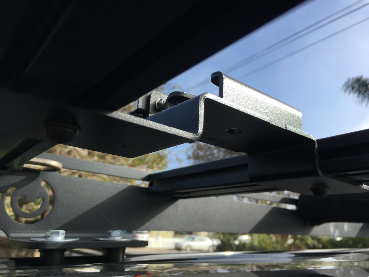

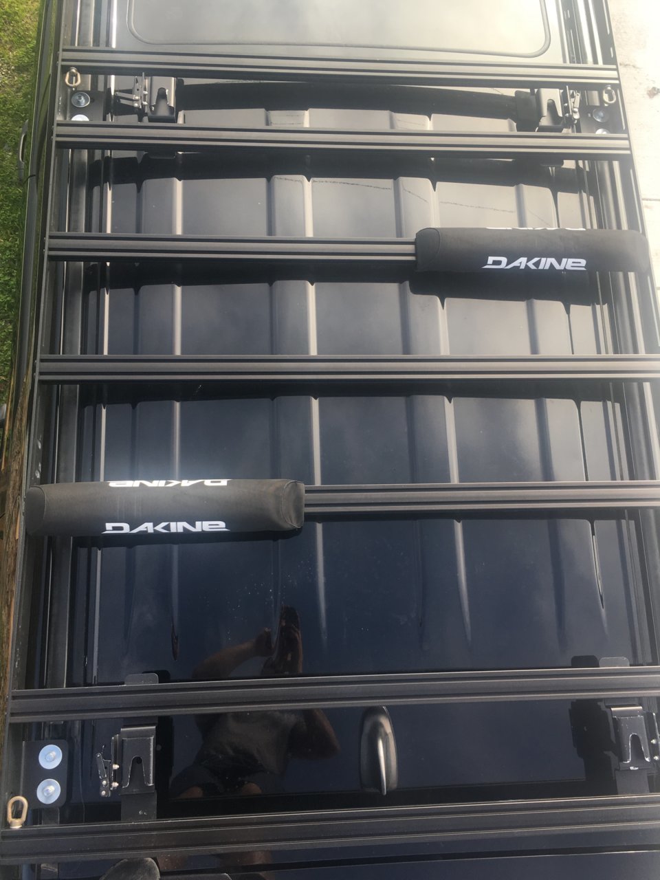

    So I ended up ordering everything I needed online and got it all set up. My record time for taking the RTT on or off is 4 minutes (with two people).
    I bought the heavier duty nuts, then screws and washers that fits Prinsu's rack and every lined up perfectly.
    So FrontRunner's quick release mounting systems is compatible with Prinsu's rack. You would just need to source your own bolts/washers/nuts. One single mounting point was strong enough to support me (185 lbs), so I'm not concerned with all four points holding 25lbs each. I've taken it wheeling and everything stays put. Also, no issues when testing on freeway at 80-90mph.

    You’re absolutely correct. It would be smarter and more logical to mount the quick release mounts on top of the cross bars, however I wanted the lowest profile possible and minimal wind drag. With that being said, I can proudly say that I’ve officially had it on for 2 years without any issues. The rails on the rooftop tent sit on four (4) Dakine pads I have as well so the weight is evenly distributed across the entire rack. I didn’t have notifications on and didn’t see all the responses here.
    One of my buddies just bought a Prinsu rack with the 2nd generation Front Runner quick release mounts. The new version of the mounts need to be mounted on top due to the design. I’ll post additional pictures of how we made it possible. All you need is eight (8) “1/4-20 standard T-Nut & 1/2” screws” (plus washers). The cost $4 + $5 shipping. My guess is that FrontRunner says they’re not compatible in an effort to draw in more people into their own roof rack market. Stay tuned.
