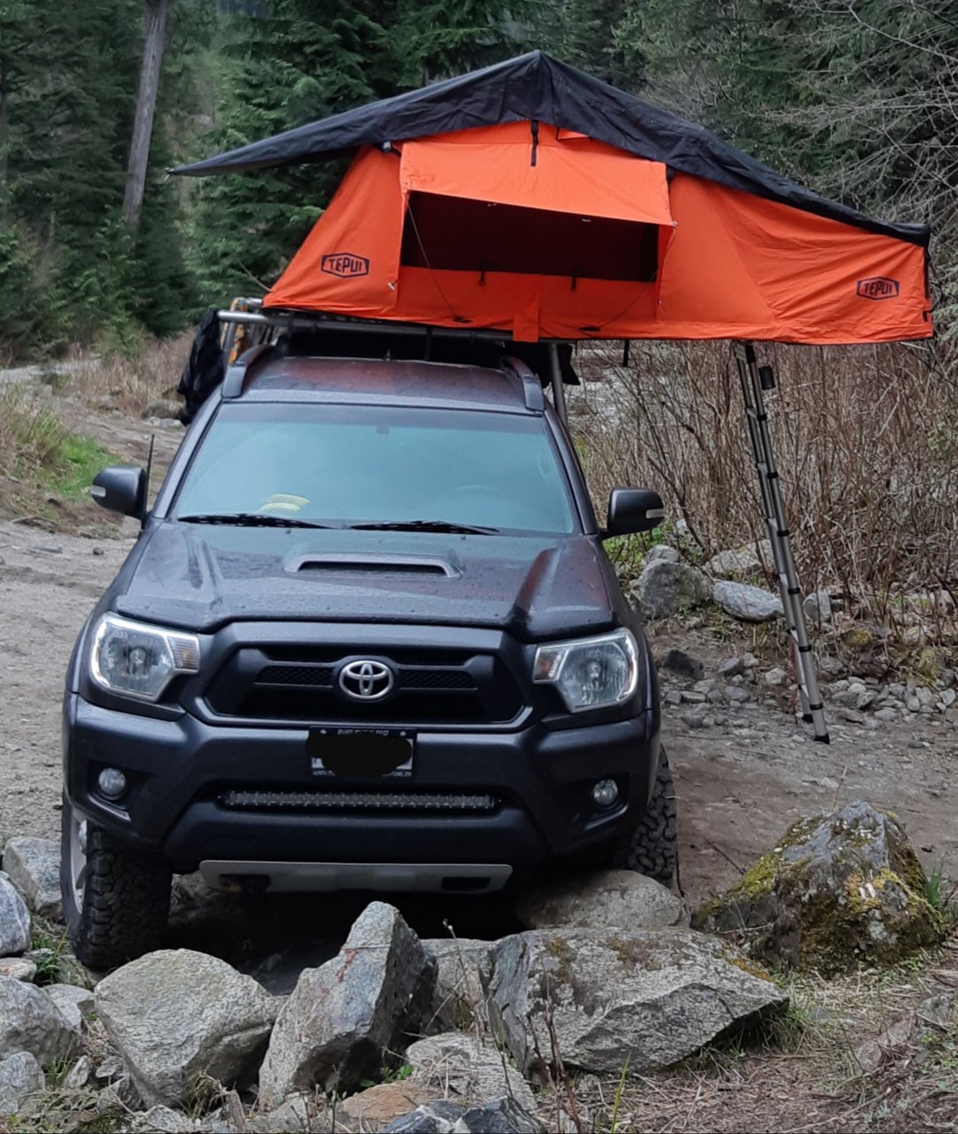

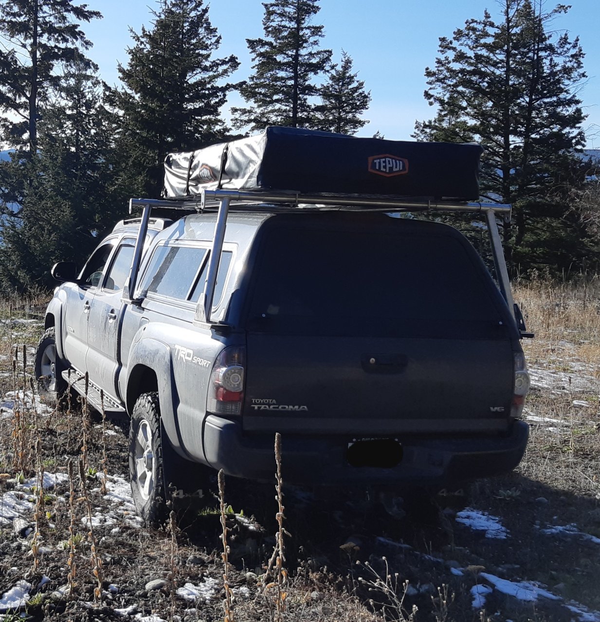

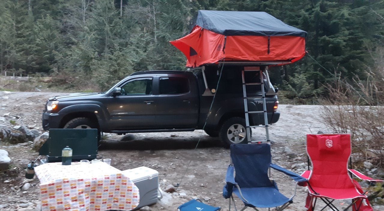

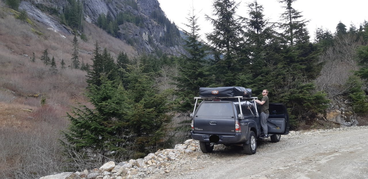

    It fits and it is massive and heavy but it fits 3 adults comfortably, not regrets until my son and I have to lift it up there it is about 200 lbs plus.

    That’s awesome man! Love the set up! Is that a long bed? I have a short bed so mine will probably hang over a bit.

    What canopy and support setup is this? I want to get a canopy where I can have my dogs so the commercial ones won’t work I need windows that open and I like the way your mounting bars for the RTT go outside the canopy. Where’d you get that setup? I’m looking for something like it

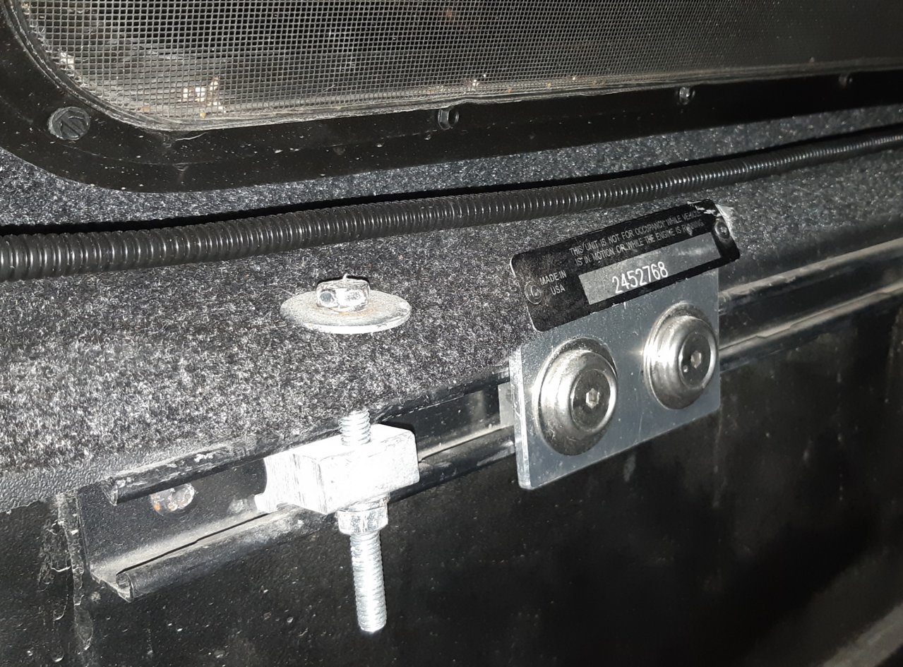

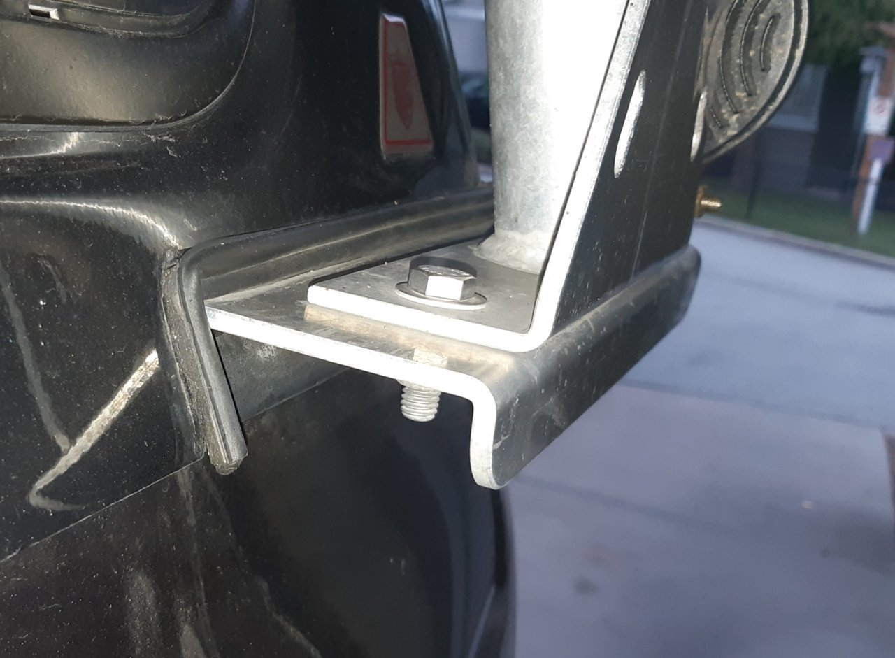

    https://westcanmanufacturing.com/truck-products/over-canopy-racks/ Its a Canadain company called Westcan Manufacturing. There also an adaptor kit that you have to buy in addition to the rack to make it fit. You have to dremel out the bottom outside lip off the canopy if it has one so the adapter plates fit flat. It is a L shaped bracket that screws into the rails inside the box via t-slot nuts. The weight of the canopy which on top of the bracket and secured down makes it rock solid. I will attach a photo shortly.

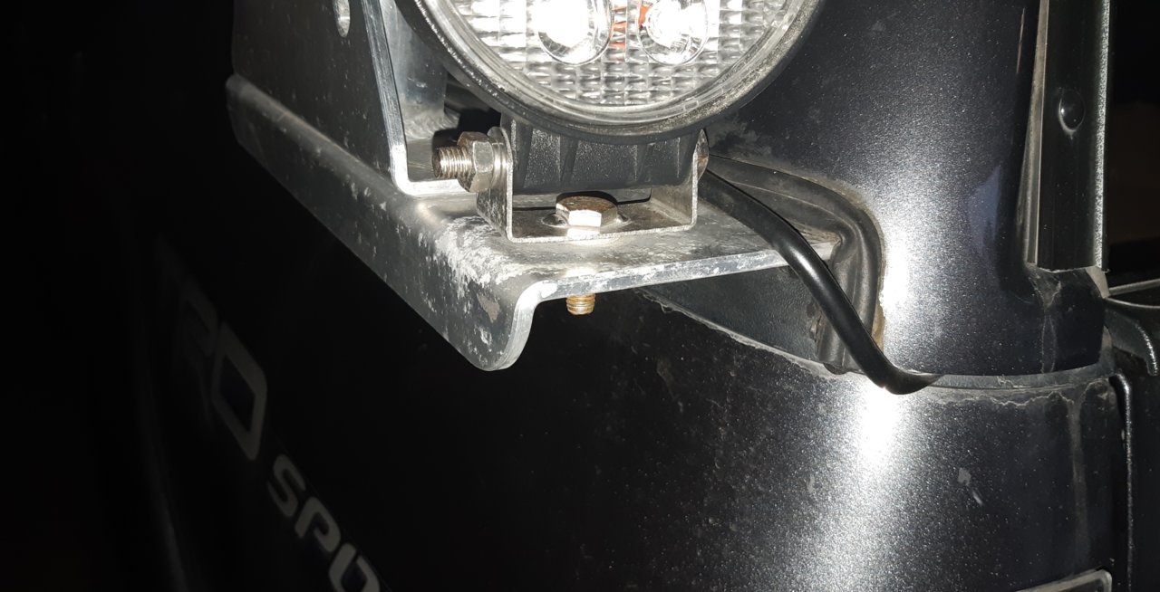

    Here is the canopy where I had to trim and the way it mounts into the bed rail. I decided to trim it out with rubber door trim strips off Amazon. Then some Proform black chassis repair body shop chalk around the canopy adaptor plates to make it waterproof and it looks better than a jagged fiberglass edge.20190620_204654.jpg 20190620_204718.jpg 20190620_204742.jpg
    It's on the website noted previously or you can get a hold of NSOR.COM North Shore offroad in Vancouver/Langley BC , Canada and they will hook you up. 1-800-624-2468 Say Trevor Froese sent you their way. Been dealing with them since 1992 good people. I bought the set up from them so they should have it on file for a second gen short box. Took 8-12 weeks from the supplier but they should have some already made. Its adjustable and just clears my garage door frame with the lift and tires just face the top tube tabs down when the tent is not ontop. Need more info let me know we are here help each other spend :spending:

    Sweet that is a great setup cause it keeps all the weight at the front and back of the bed and off the canopy unlike all the others I’ve looked at really liking the idea. I have a 2012 long bed will this work with any canopy I buy as long as the canopy roof is level and one of the ones that’s higher on the rear?

    It is adjustable so weither it is a flat or raised back canopy (yes they are level) longer or shorter bed as long as there is a canopy to hold down the adaptors you are golden. It will not work without a canopy is what I was told. Super versatile not too noisy at all still drive with the windows down and extra places to mount lights. I got lazy and just put them in the easiest places.
