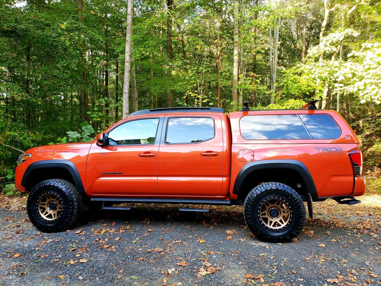

    2018 TRD Offroad
    OME 888 springs , Nitrocharger soft shock
    HD Dakar Rear Springs Nitrocharger Shocks
    Method MR312 17x 8.5 0 offset
    Nitto 265/70r17
    No rubbing rides amazing
    Undertow likes this.

    That looks great. This should be the model for why going to 285's is not necessary.

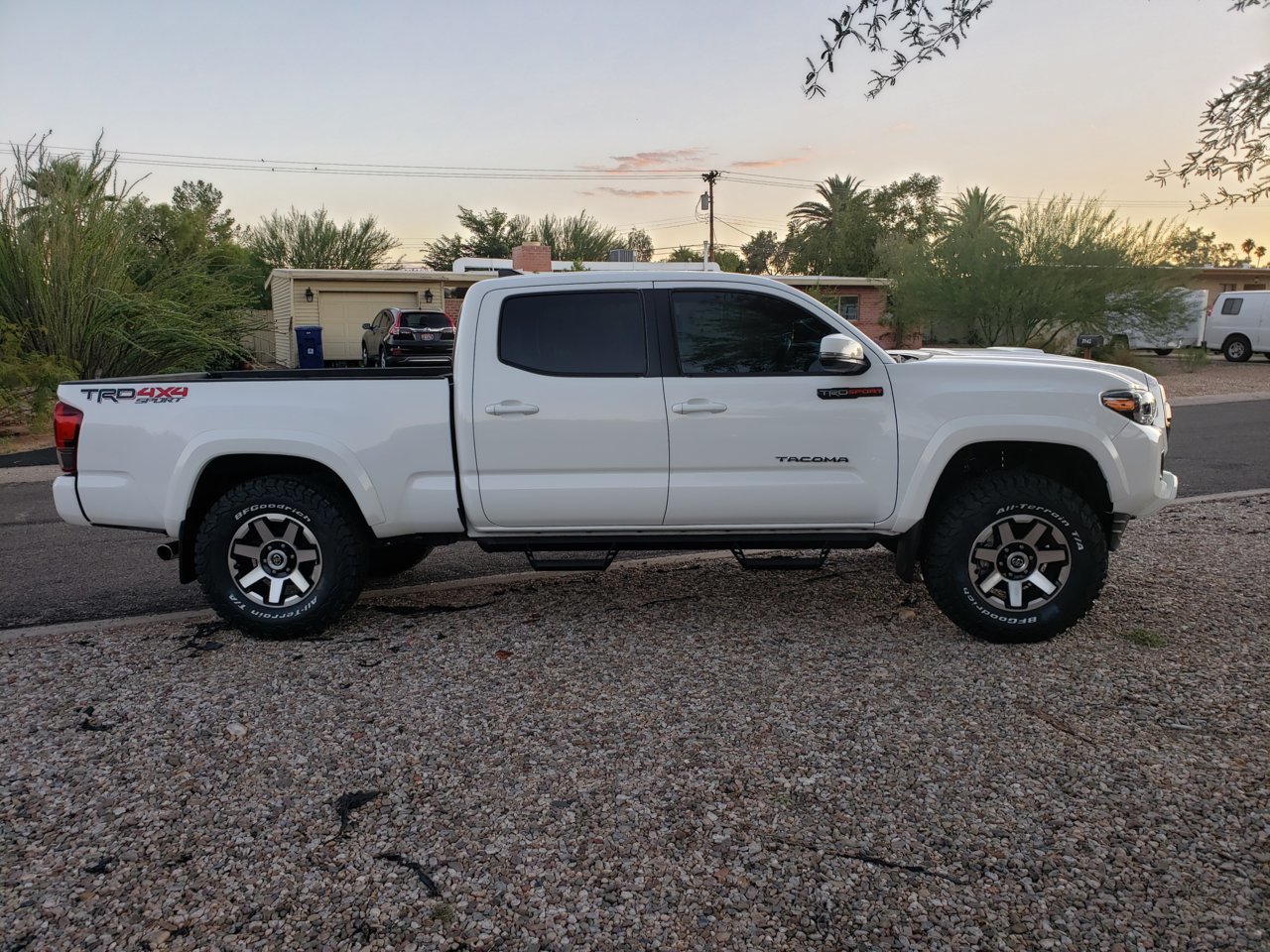

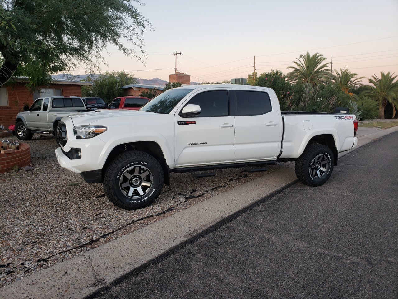

    OME 887 coils
    5100s
    SPC UCAs
    3 Leaf AAL
    285/70/17 mounted on 4runner Pro wheels
    CMC
    Minor fender liner trimming.
    Tires are Nitto Terra grapplers, SL so they're 46lbs per corner, only 4lbs more than the 265/70/17 I was running before. Loss in MPG for me was about 2, still running 18-19mpgs calculated by hand.
    Stay away from E tires if you're concerned about mileage.
    You will need the CMC for sure if going 285 tires.
