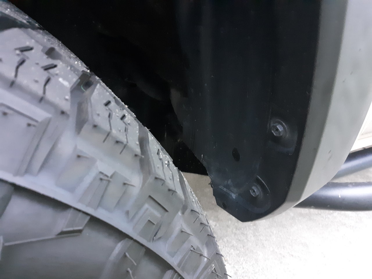

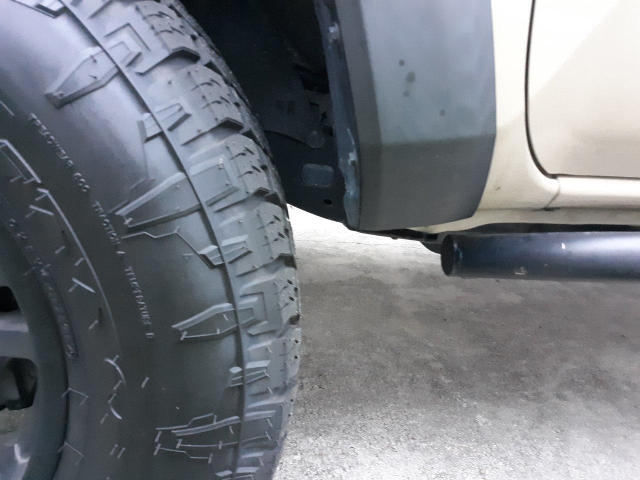

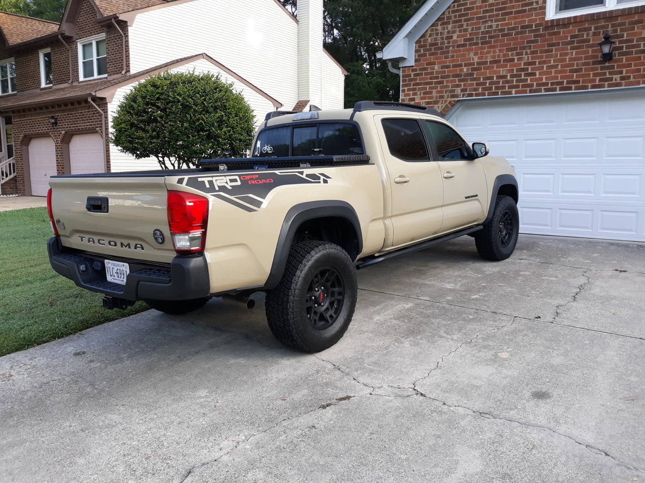

    Heres the clearance I have with the 285s on the 4runner Pro wheels. I also have a CMC and still need to trim a little more plastic, about another inch.
    Here's the poke

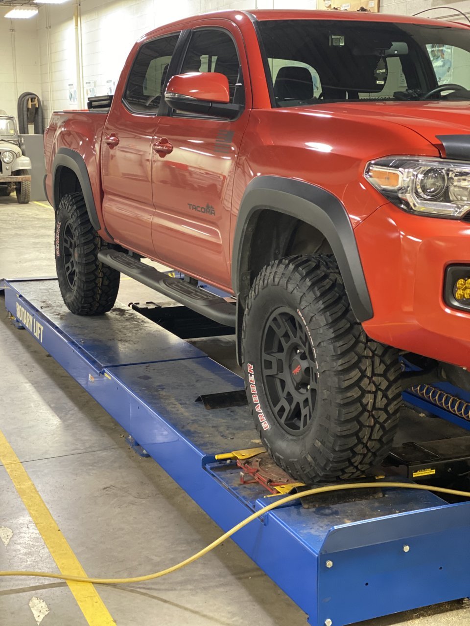

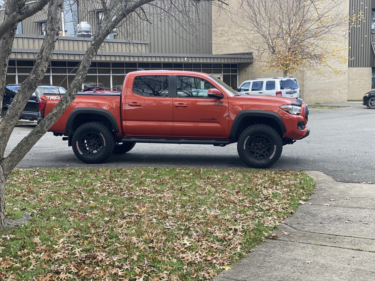

    Have 285/70/17 General Grabber X3's on my 2018. I'm using the black 4Runner Pro styles wheels from TRD. I currently rub a little bit on my cab mount when turning or hitting inclines at an angle. Currently scheduled for a local shop to perform a CMC and then it looks like a little more plastic trimming according to @jsinnard... Should this solve my issue? I went back and forth between a simple CMC and a complete Cab Mount Relocation kit from Taco Twonz. Went with CMC plates from BAMF.
    Hoping this fixes my issue. Anything else I'm missing guys? Truck pics for attention as always.

    Are you still on the factory UCA's?
    The reality is you will rub under certain conditions but where is hard to say.
    You end up trimming a little, repeat the situation then trim a little until you're done rubbing.
    CMC will help a lot.
