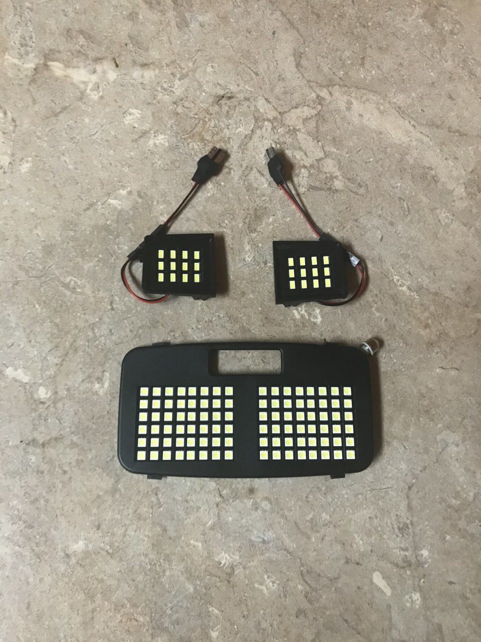

    Got another mod in on a trade deal. Will be installing as soon as I get some free time. The factory interior lighting is lackluster.

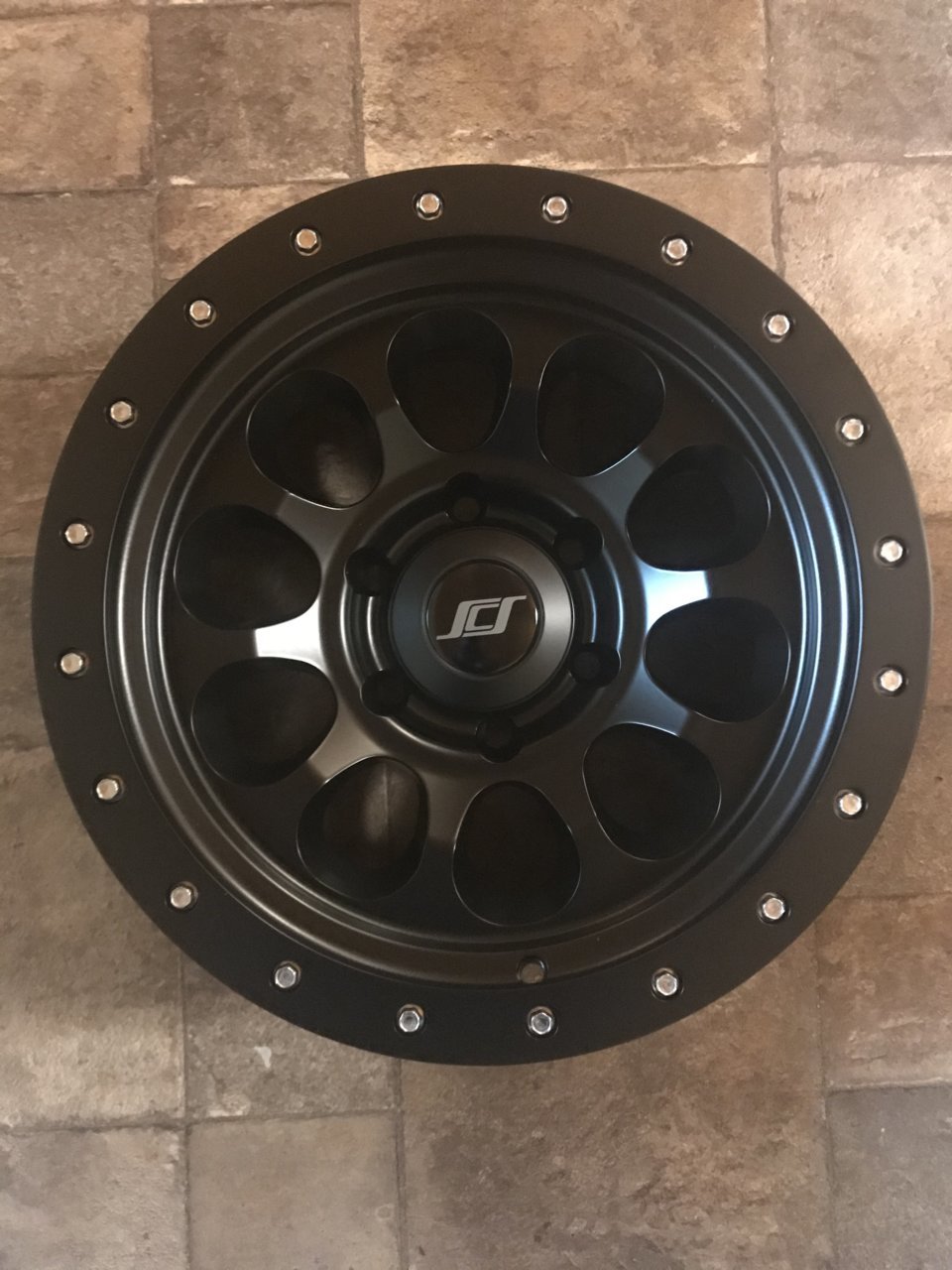

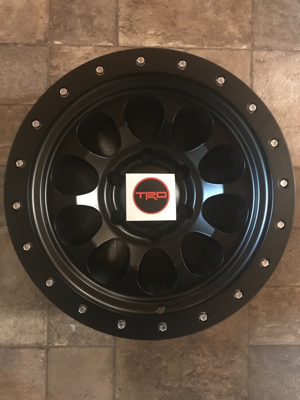

    Also, had these decals custom made for the SCS wheels. Back and forth if I’m going to install them or not. The factory wheels on the PRO have the red TRD logo on the center caps. I like the small touch of red accents on the MGM color and am going to do a few red accents where I can without getting crazy.
