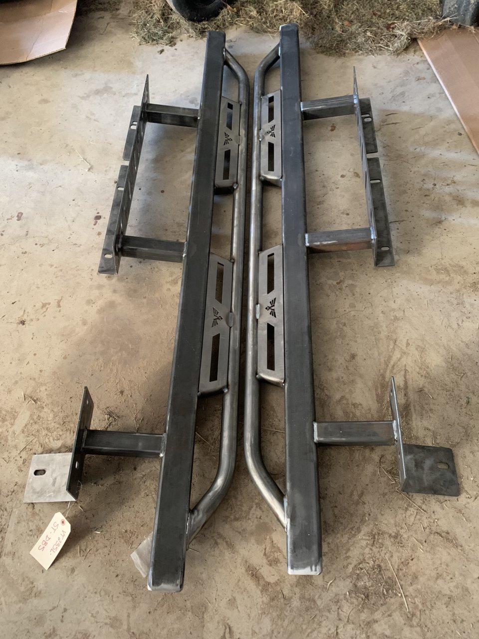

    Bumper and rock rails in from @victory4x4 . Looks like the bumper received some damage in shipping, but I was able to fix it fairly easy with a sander and file. Hoping to get it prepped and coated throughout the week.

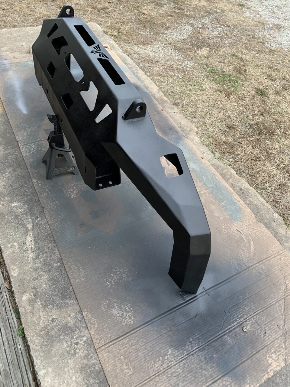

    Was able to get my new bumper cleaned, prepped and a few coats of primer on it. Tough when the whole family is sick.
