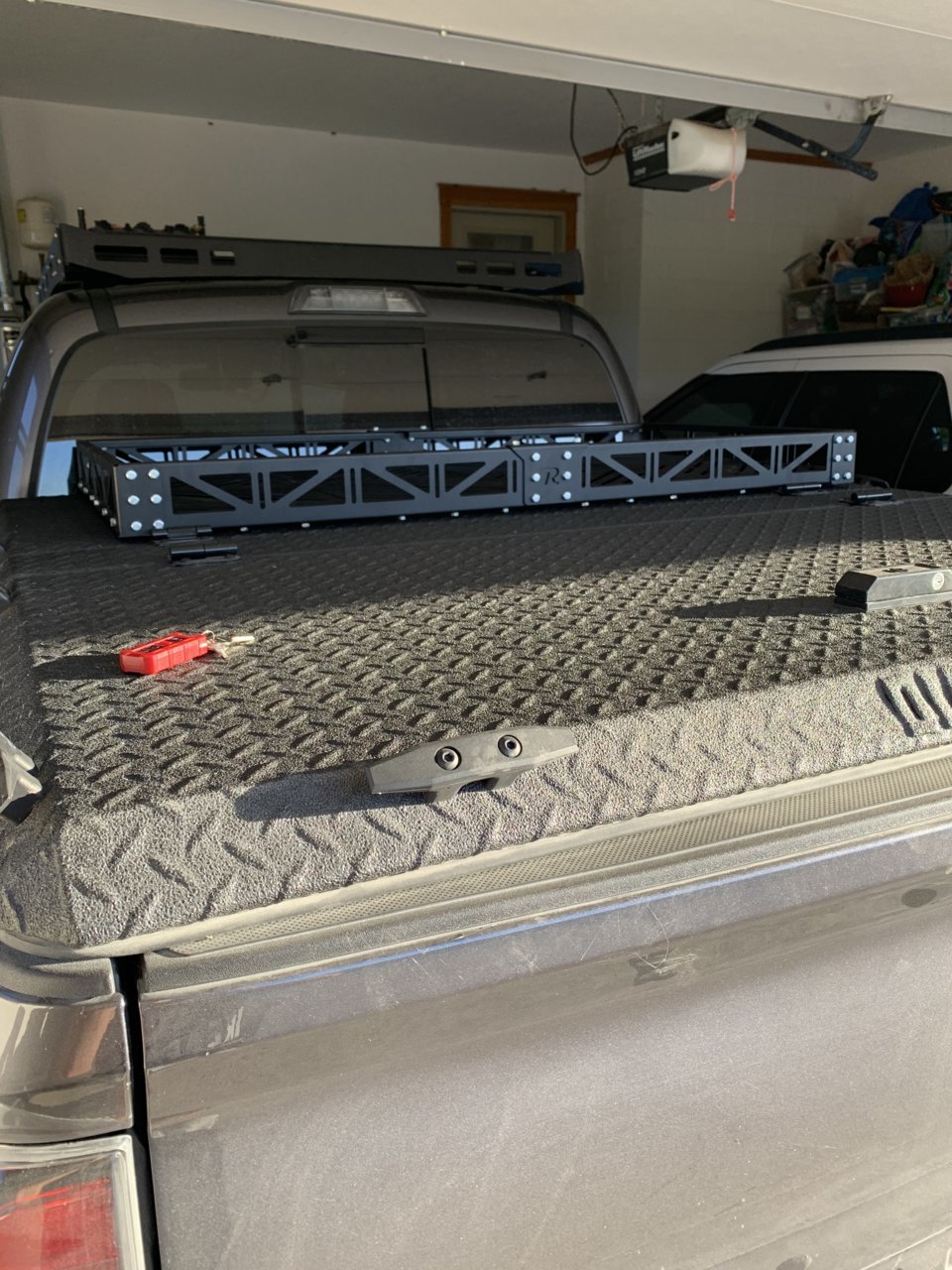

    Snagged an endeavor shelf from @ragofabrication on a smoking deal. Hoping to install it on the top of the cover using front runner feet and tracks. Tested to see if the lid can still open and hold the weight of the shelf, no issue there. Just need to find the time and courage to drill holes into the DB cover. And man, this shelf came with a TON of hardware. Most bolts I've ever had to use putting something together. Takes me back to the old IKEA furniture days.

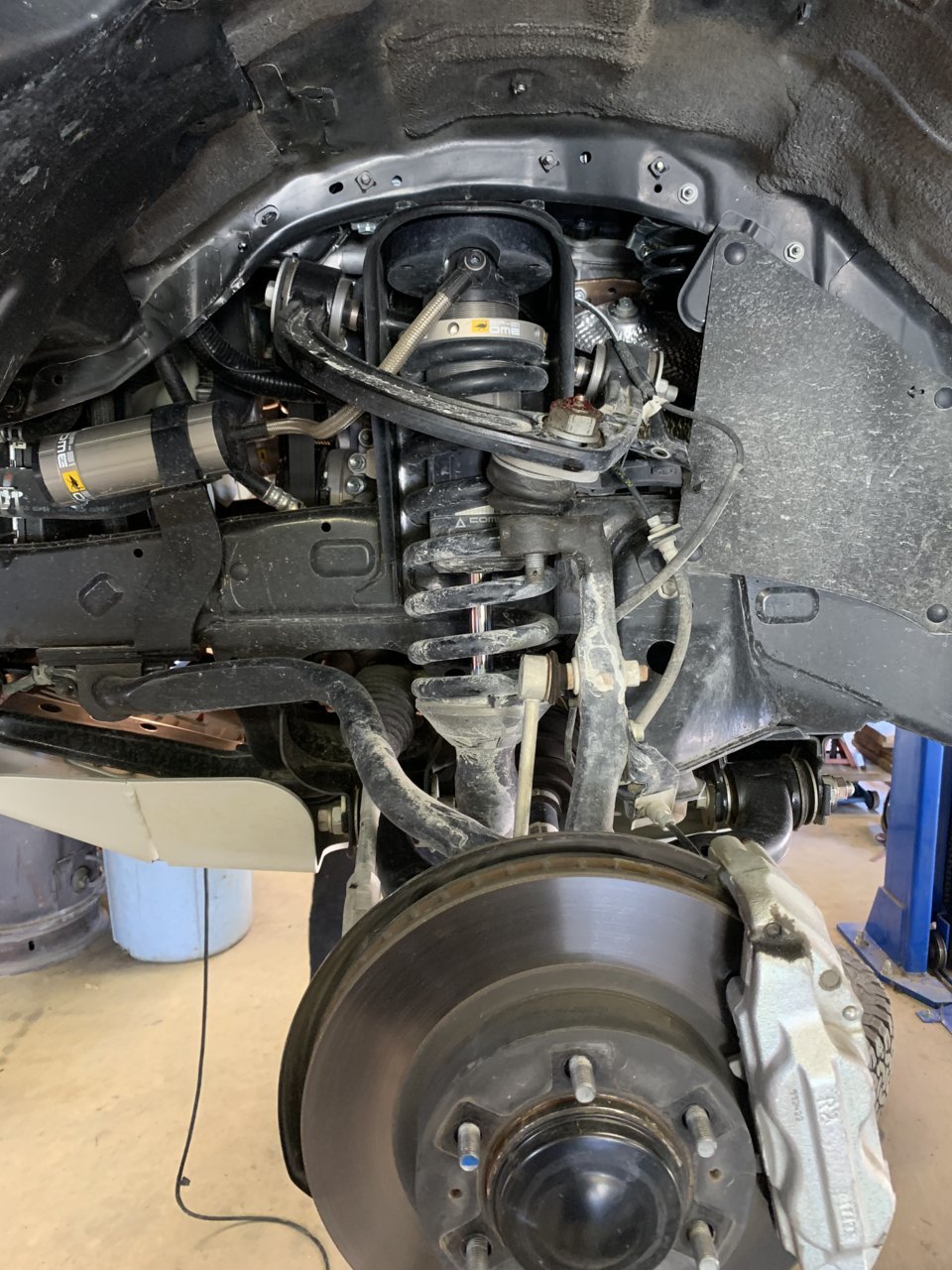

    Also, just swapped out the SPC's for JBA upper control arms and did the rear breather modification (super easy).

    reason for swaping UCA's, thinking of going with the SPC's but very concerned with the strength of them.
  10. Nov 11, 2020 at 5:38 AM
    #90
    WreckedRooster
    WreckedRooster [OP] Well-Known Member
    Jan 17, 2019
    #279680
    1,254
    Jake
    Oklahoma
    2020 MGM DCSB
    few reasons:
    -hard to find someone that can align the truck properly with them (eventually found someone)
    -I didn’t have faith in the sliding top nut.
    -they squeaked as the bushings are not greasable after installed.
    - arm would have to be removed to replace ball joint and you’ll need a press.
    JBA’s:
    -3 grease zerks to keep everything quiet.
    -ball joint can replaced without a press and you can use a moog joint found at most parts stores in a pinch.
    - I like that the caster is fixed. Nothing to adjust or come loose.
    Silly, but I like that they are red.

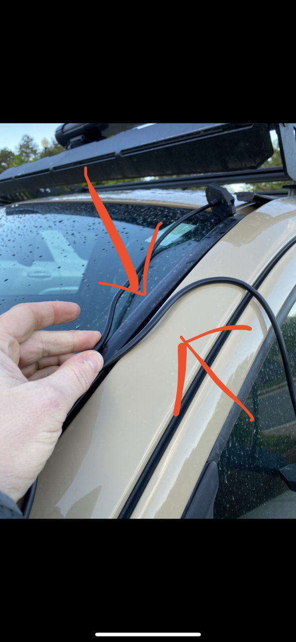

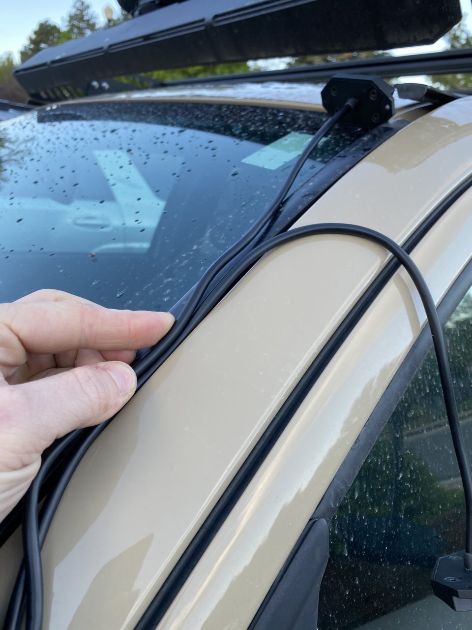

    @WreckedRooster hey man! Love the roof rack light set up do you have more pics or information on how you wired them?
  12. Nov 12, 2020 at 7:11 AM
    #92
    WreckedRooster
    Jan 17, 2019
    #279680
    1,254
    Jake
    Oklahoma
    2020 MGM DCSB
    The side lights?
  13. Nov 12, 2020 at 7:27 AM
    #93
    Gnarman
    Gnarman Well-Known Member
    Jan 24, 2016
    #175919
    749
    Southwest
    2016 dbcb trd off road quicksand lb
    ARB Shell, BP51, 255/85/16 ST MAXX, SCS Ray 10 Matte Bronze, Caliraised led 32 inch/side shooter/amber pods, floor mats, start x remote start, auxbeam 8 gang switch panel, diode dynamics hid lows, Australian Shepherd
    Yes, sorry for the confusion! The mictuning ones. I’m thinking of doing the same setup with one of the dsim dome rock units and those same lights.
  14. Nov 12, 2020 at 8:28 AM
    #94
    WreckedRooster
    Jan 17, 2019
    #279680
    1,254
    Jake
    Oklahoma
    2020 MGM DCSB
    Sure thing. I was able to route the cables in the groove channels of the extruded aluminum cross bars on the rack. The cables are super long, and it was tedious work, but it came out clean. The key in that setup was the 3d printed brackets that angle the lights down at a angle. I found the guy on FB, but he has an instagram as well and sells through there. I believe they are specifically designed for the Mictuning lights though.

    how did you route the wiring harness into the engine bay for these?
  16. May 3, 2021 at 11:26 AM
    #96
    WreckedRooster
    Jan 17, 2019
    #279680
    1,254
    Jake
    Oklahoma
    2020 MGM DCSB
    At the base of the windshield there is just a flap that can be pulled back to get the wires into the engine bay.

    awesome thank you did you put two wires per side
  18. May 7, 2021 at 6:26 AM
    #98
    WreckedRooster
    Jan 17, 2019
    #279680
    1,254
    Jake
    Oklahoma
    2020 MGM DCSB
    I have one set of wires running down the drivers side for my light bar and another set running down my passenger side for my area lights.

    thanks @WreckedRooster did you splice them or keep the brain of the unit up on the actual rack? For the four wire leads u can figure out how to get them all onto one side. I can do two on each side and run them into the engine bay but have been unable to figure out how to get all the wires down one side.
  20. May 8, 2021 at 3:23 PM
    #100
    WreckedRooster
    Jan 17, 2019
    #279680
    1,254
    Jake
    Oklahoma
    2020 MGM DCSB
    my box is up top. I ran a single paired cable down the windshield trim.
