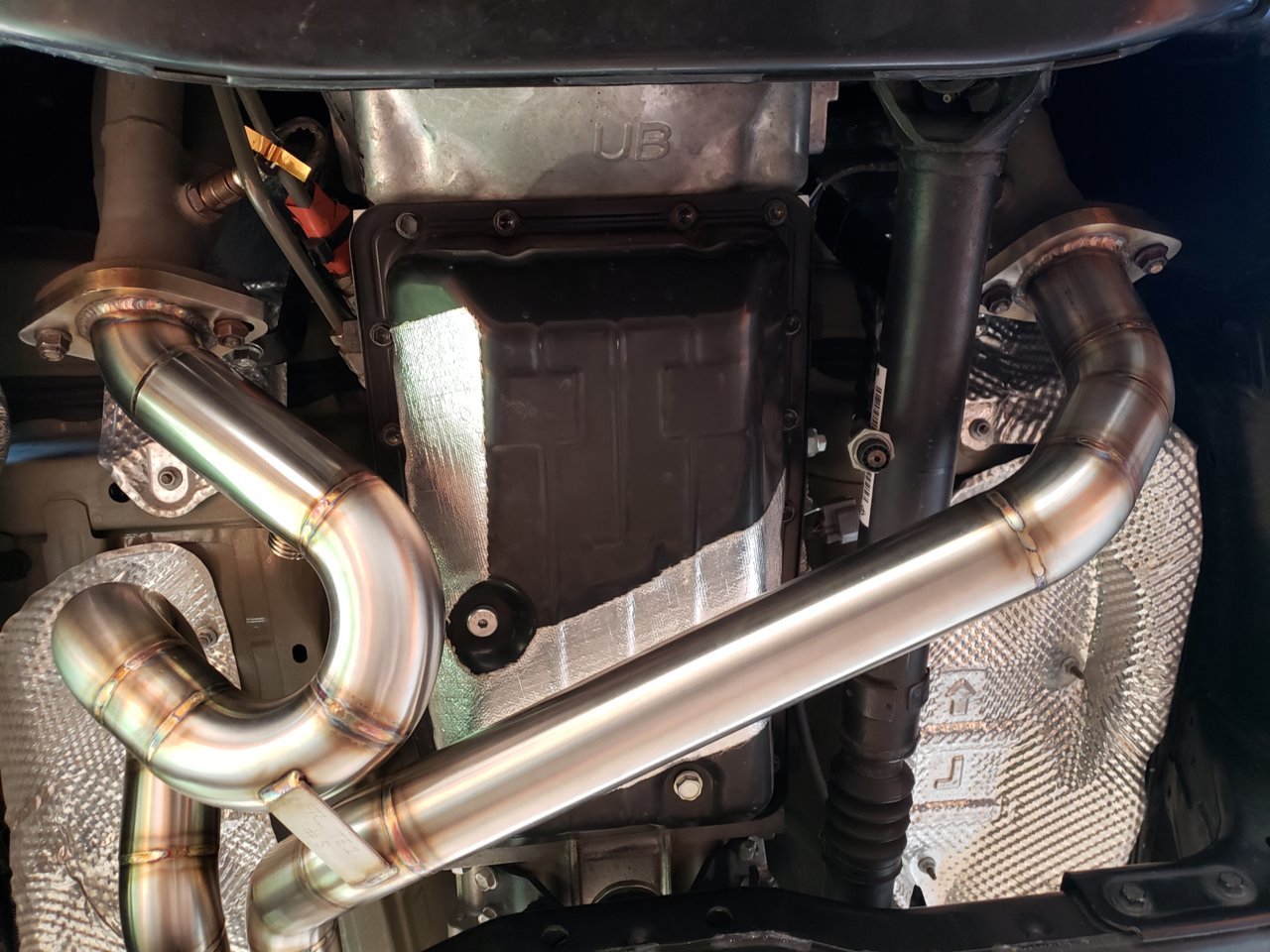

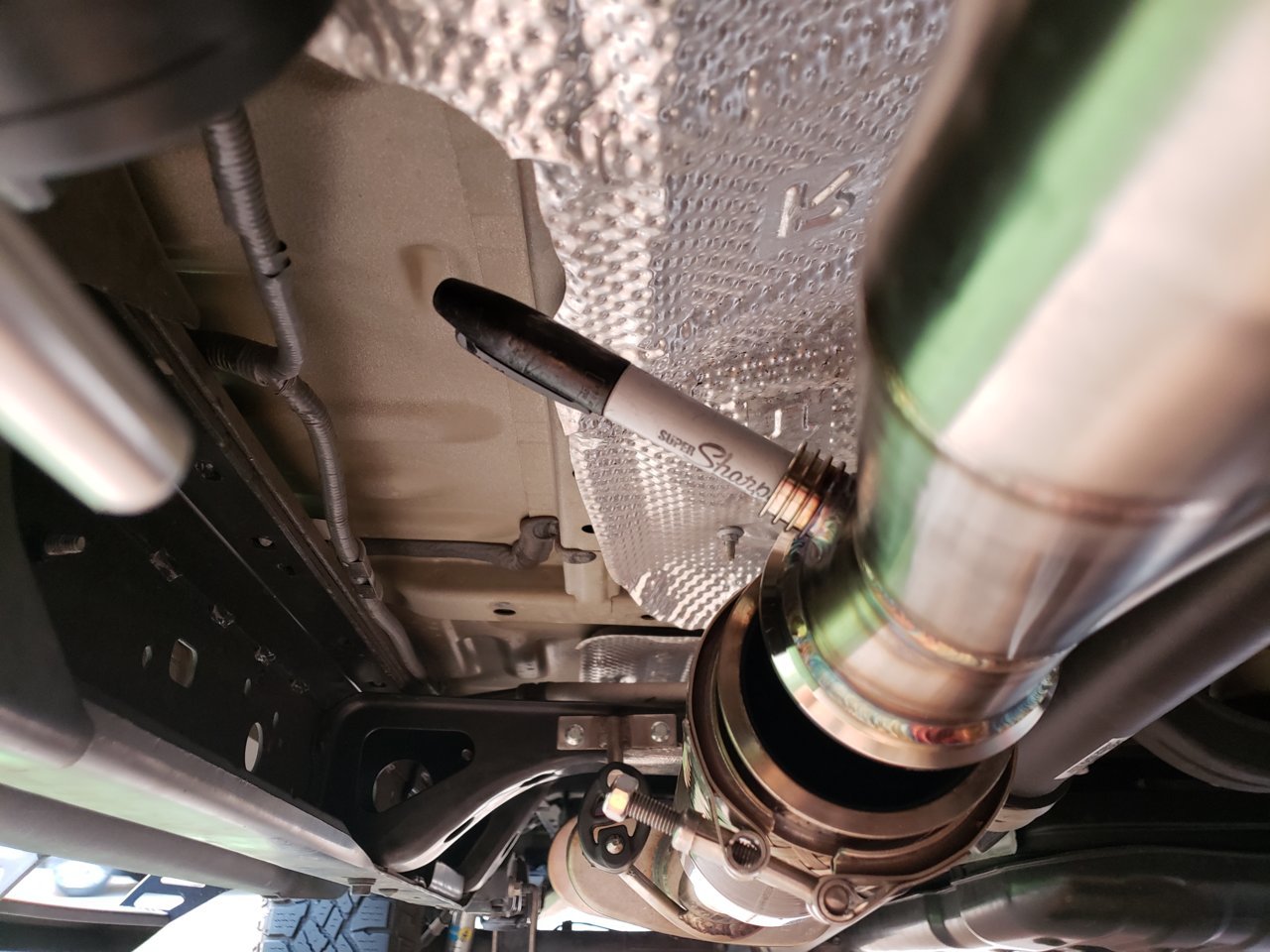

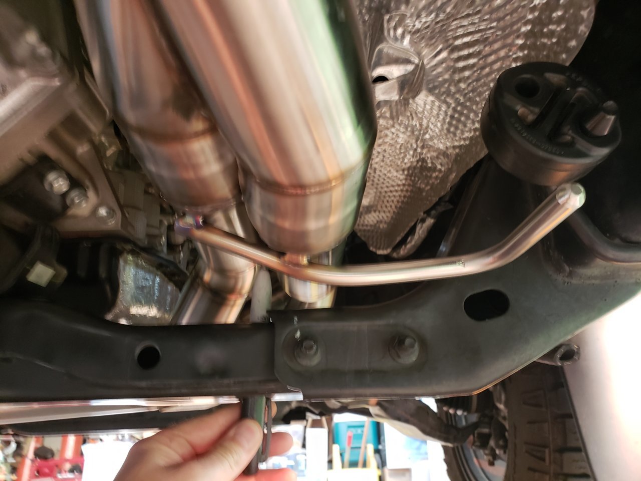

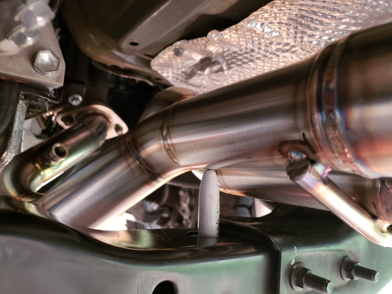

    @Murphinator yours is done! @rjbiii your next.
    Notice the permanent marker. That's where your skid bolt is.20180821_195056.jpg 20180821_195126.jpg
    Permanent marker again in the bung hole! You want it facing up more than horizontal to prevent any condensation from pooling in the o2 sensor.
    I'll try to get yours and @jojotoo shipped out Thursday or Friday.
