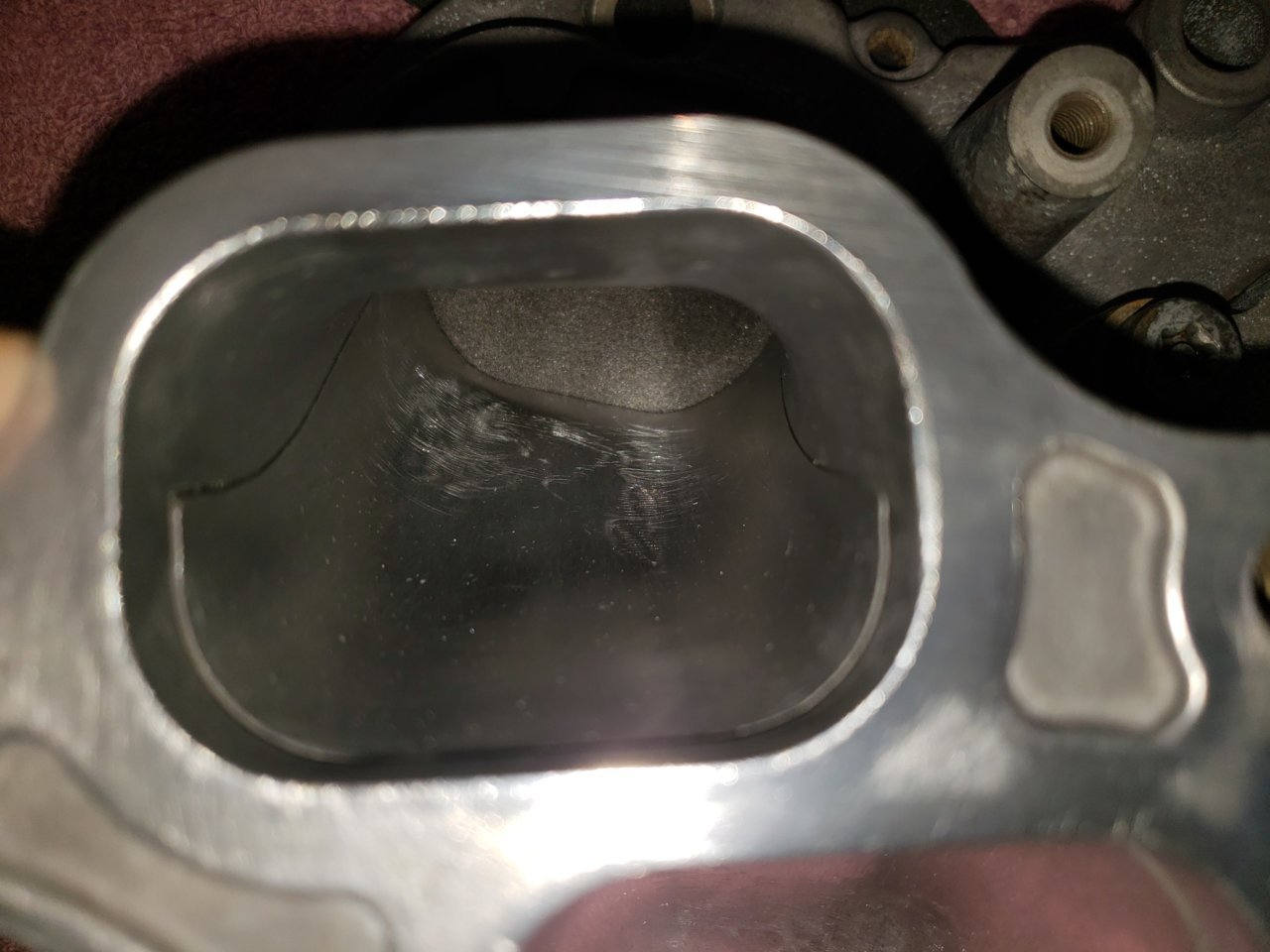

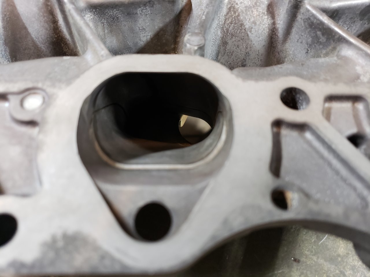

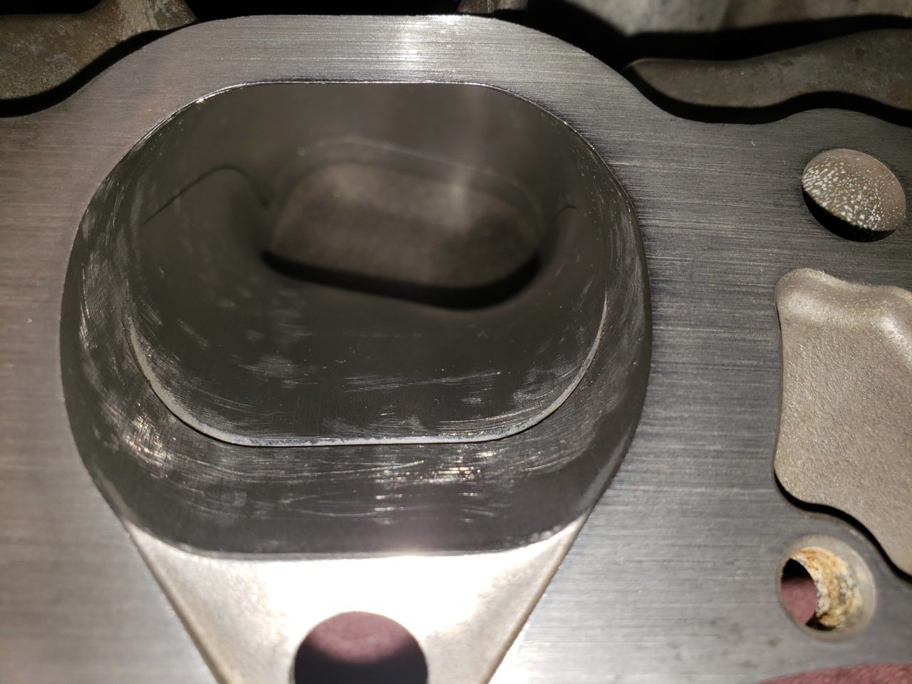

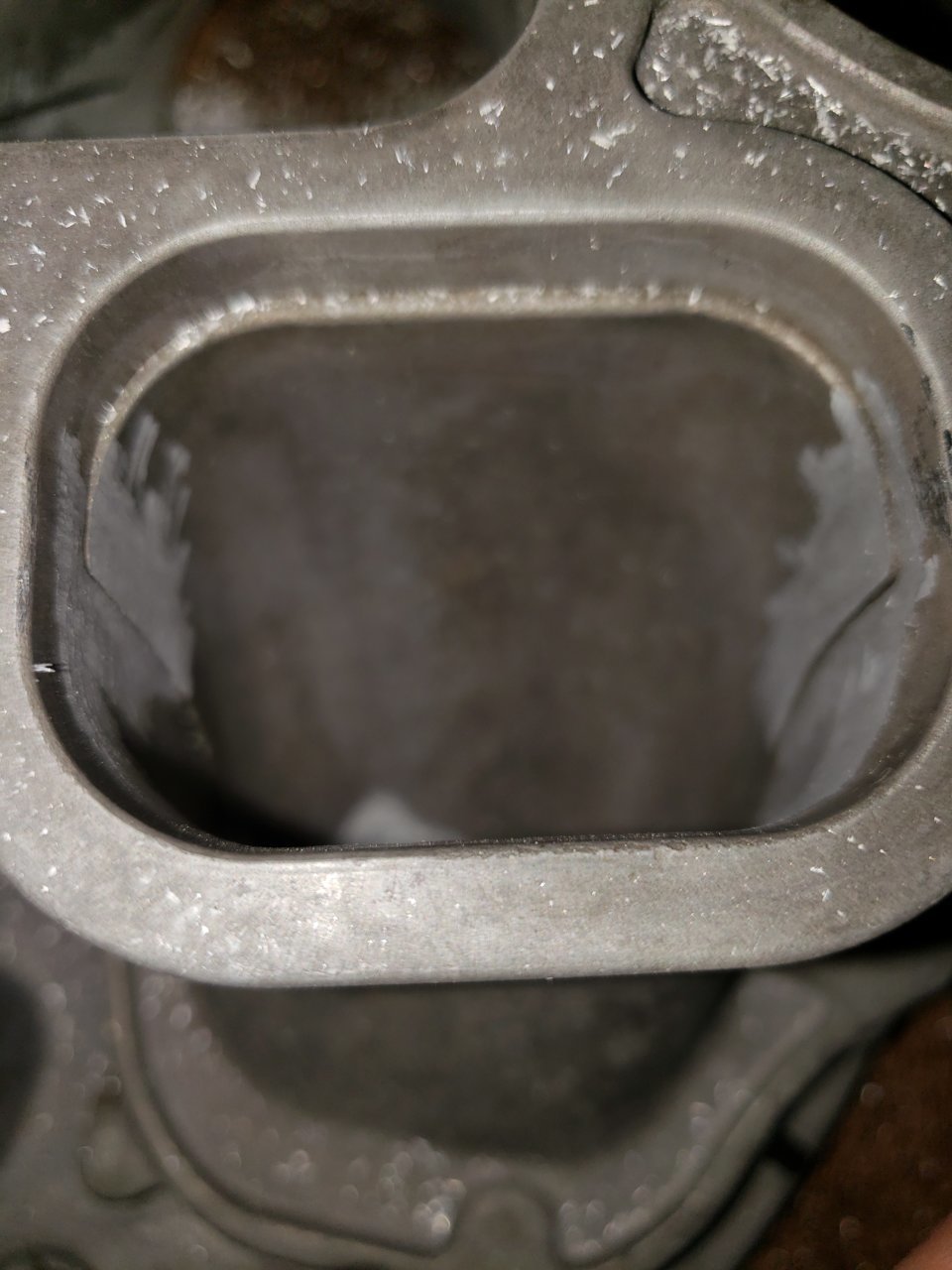

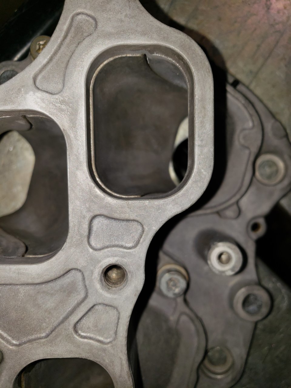

    Working on @5thGearPinned lower intake manifold. Here are a couple pics of the progress so far @o0opackersfano0o
    This lip is smoother out all the way around.
    20180823_174219.jpg Starting to smooth the sides. You can see the lip on the top of the port.
    A shot of an unmolested port.
    Here it's pretty well blended and ready for sanding. Ports dont need to be polished, shape is the important thing.
    The general rule of thumb for intake ports is a 2 to 3° convergent duct. This accelerates the air toward the intake valve.
    I'm not hogging out the port because I want to keep velocity up in the lower rpm range. Big ports for high end small ports for low end.

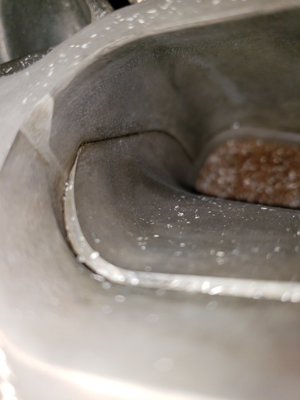

    Shaping the upper part of the port.

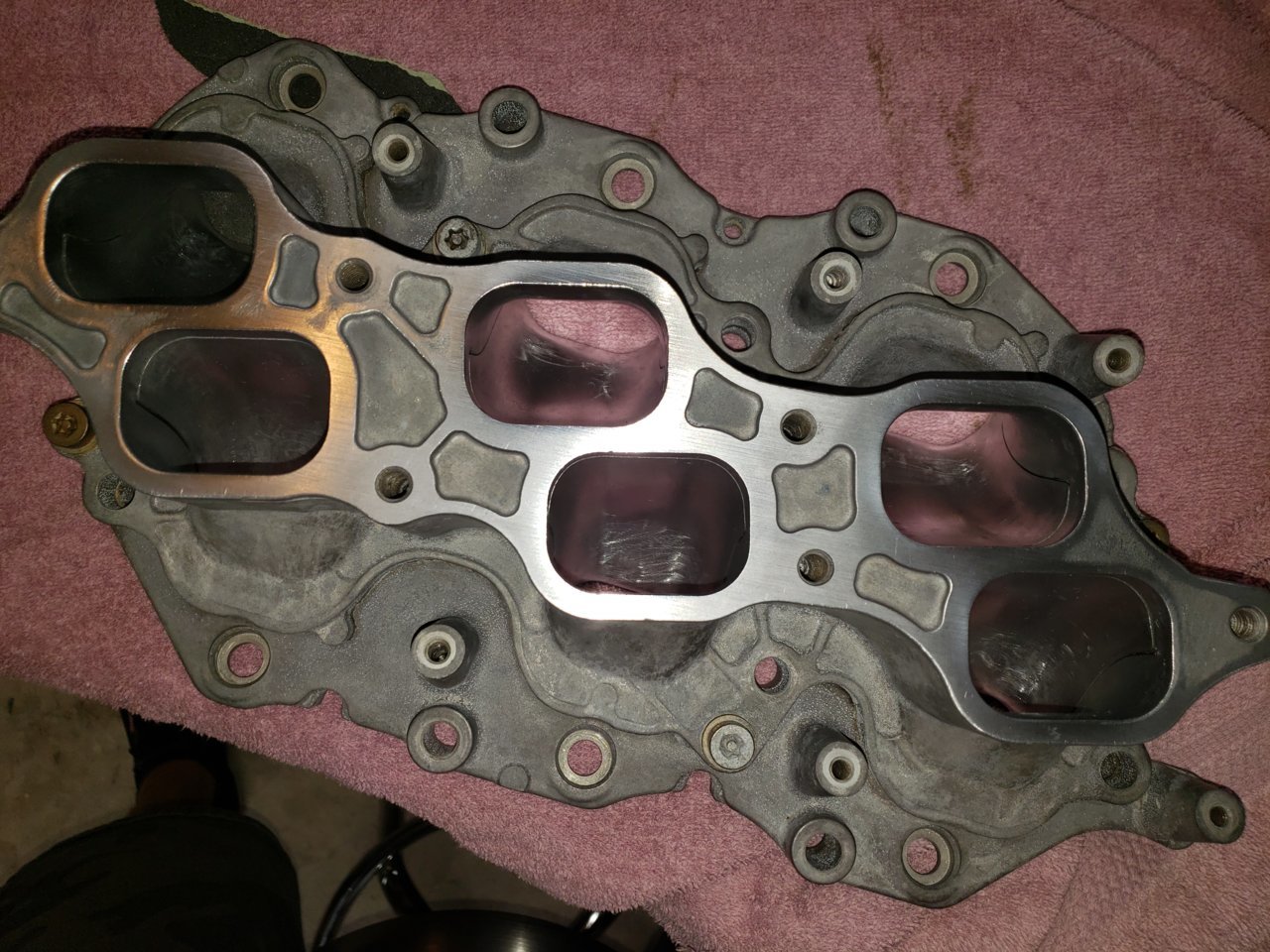

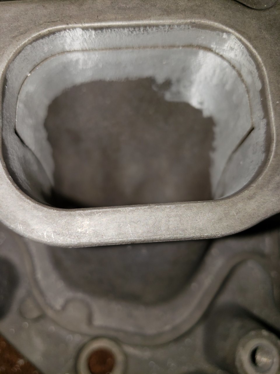

    Couple more pics of finished lower intake manifold.
    20180825_003043.jpg 20180825_003256.jpg 20180825_003129.jpg 20180825_003310.jpg
    BassAckwards, JWL, Stryker420 and 4 others like this.
