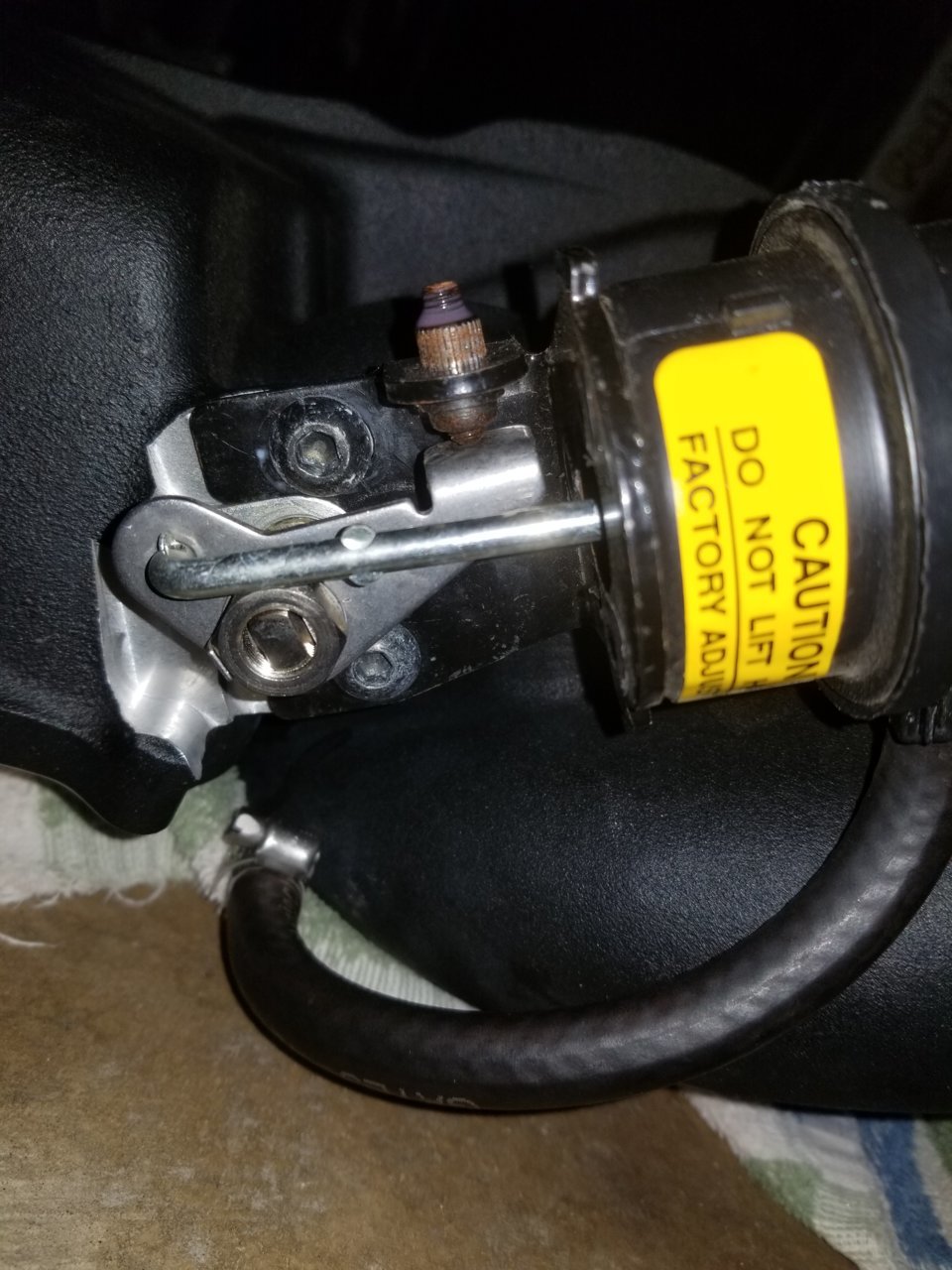

    Boosted
    Oh do they now?!
    What is your best advice on easily adjusting that valve? It is not very easy to totally access, and from what I have tested with it before it seems to be adjusted correctly, but what seems and what is are always two different things.

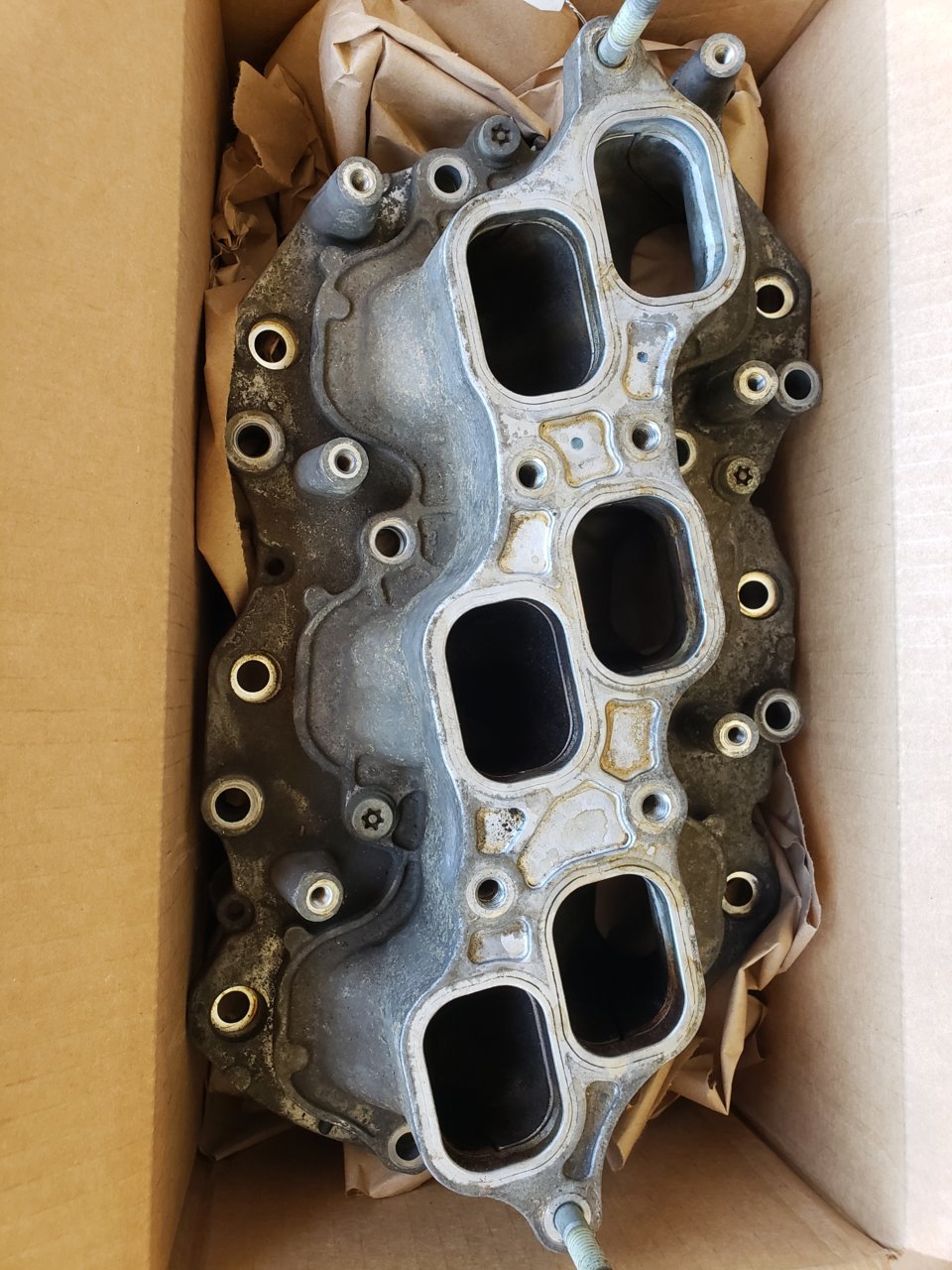

    This sits just below your black plastic intake plenum. It does nothing for your reliability, it's just to enhance airflow into the engine.

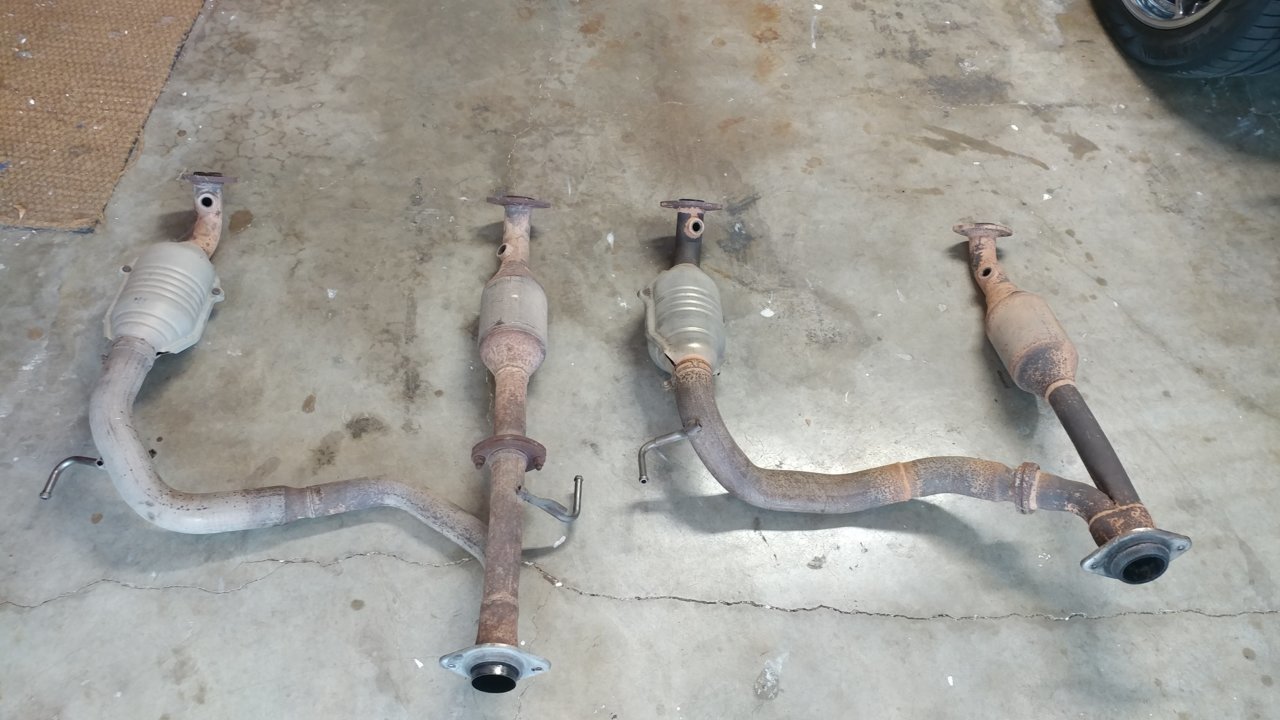

    Incase anyone was wondering the differences in the y pipe for thr 4runner and tacoma.

    Your right it's not the easiest to adjust when the sc is installed but super easy when removed.
    In a quiet environment you can open the valve and let it spring shut. LISTEN carefully at the sound it makes when it hits the stop. It will be a distinct metallic "tink" when it hits the stop. Keep doing this while backing off the stop and when the butterfly starts to hit the bore inside it will be more of a dull "thud" sound. Now you've found the full closed position but possible binding could occur. You may feel the initial binding at this point when you move the actuator rod.
    Adjust the valve opposite now until there is no binding and you just hear the "tink" sound.
    At this point you are allowing the bypass valve to close as much as possible while still hitting the stop and not binding in the bore.
    Hope this helps.
    I put a little locktite on mine when I was done. That's the pink in the pic.

    Dont remove it! Just adjust it. It's the small Allen bolt where you see the pink locktite in the pic. You can see the actuator stop and the adjuster.
