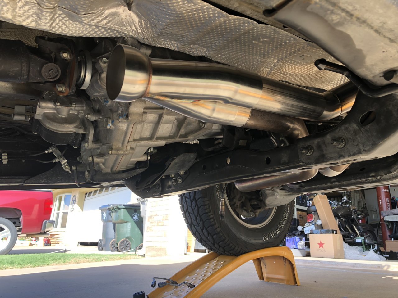

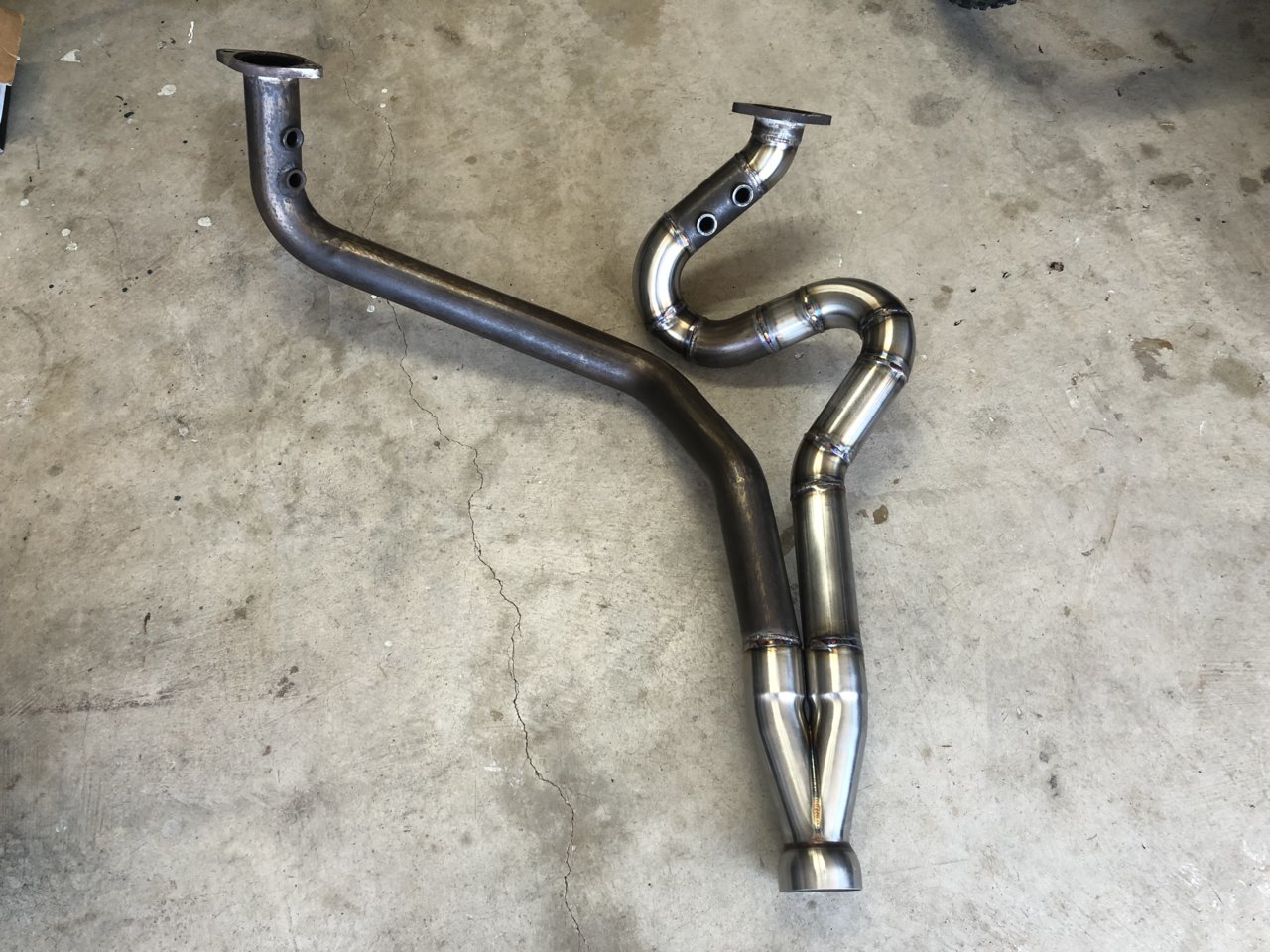

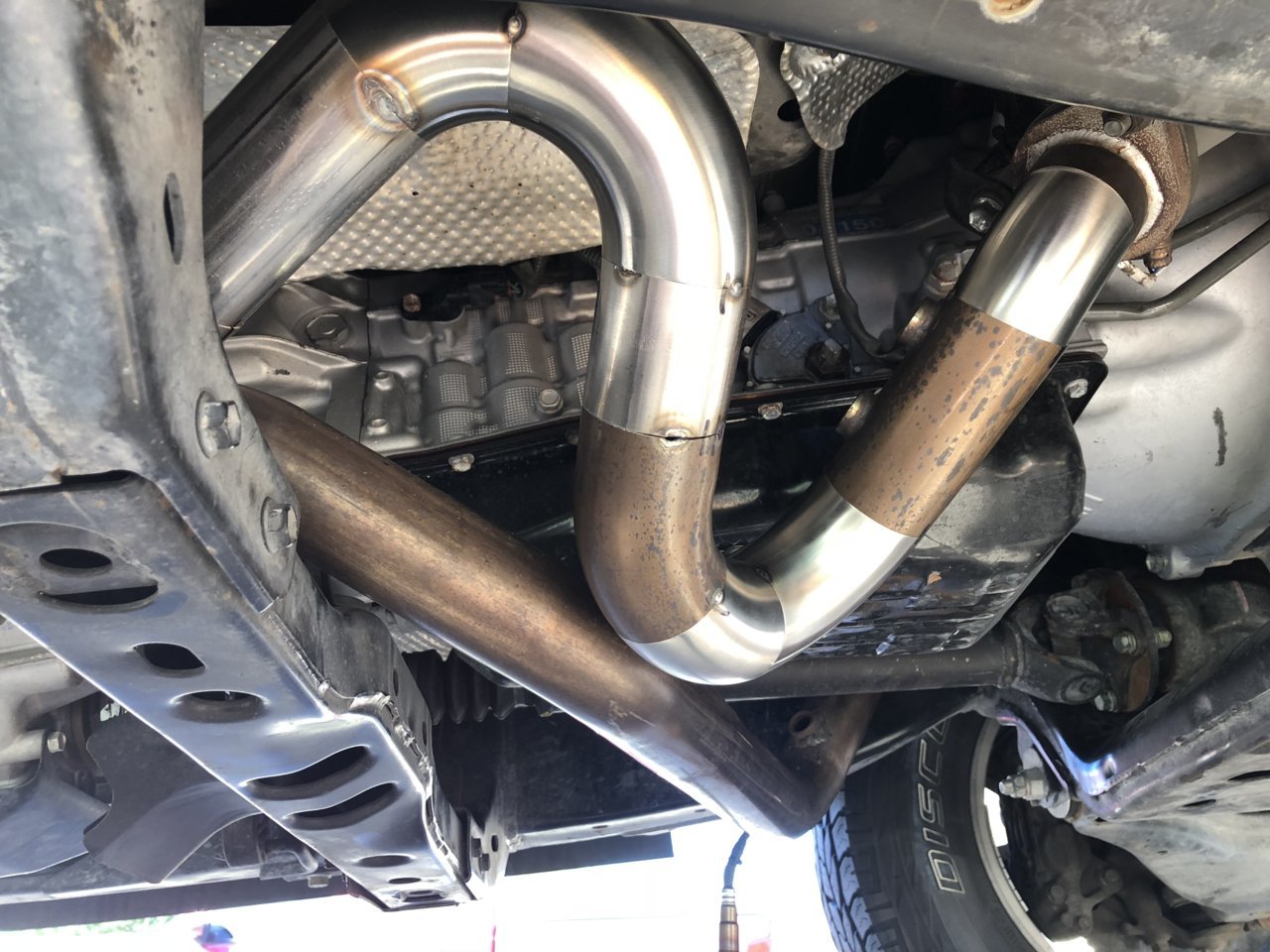

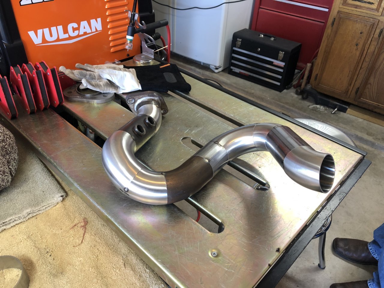

    For entertainment purposes... Here are some pics of my unequal length URD Y-pipe getting transformed into an equal length. Courtesy of @Roostfactor.
    This is what it looks like out of the box:
    The man, the legend. He re-used much of the original as possible, substituting fresh mandrel bends where needed to get the desired shape:
    We had some help:
    Test fitting along the way to make sure everything fits, before fully welding each joint:
    After:
  14. Aug 8, 2018 at 6:15 PM
