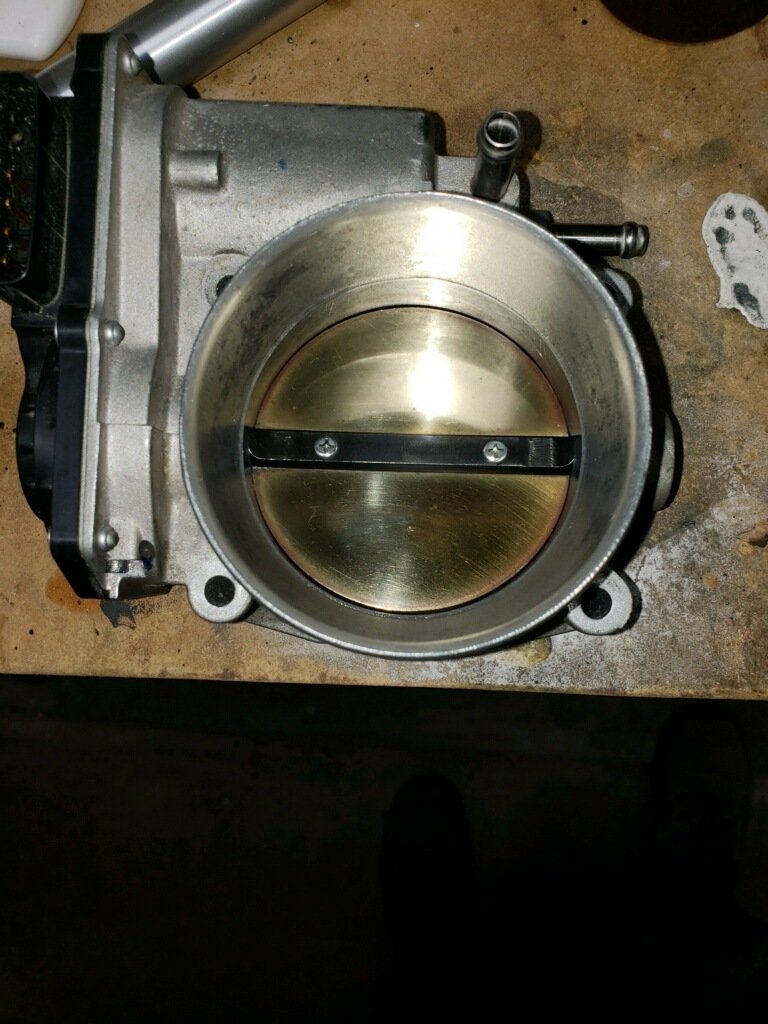

    Roostfactor
    Roostfactor Well-Known Member
    Jun 2, 2015
    #156609
    3,885
    John
    TX panhandle
    2015 DCSB OR Pyrite Mica
    HPT/justDSM tuned factory ecu, URD Headers, JFR Y-Pipe/l 3" exhaust, Walbro 255 fuel pump, Maggy SC (JFR ported), JFR ported lower intake manifold, 76mm tb, 2.5 pulley, 640cc injectors, CSF Radiator, custom electric fan wit Autocoolguy controller, JFR SC pulley wrap mod

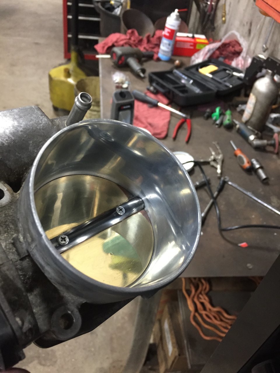

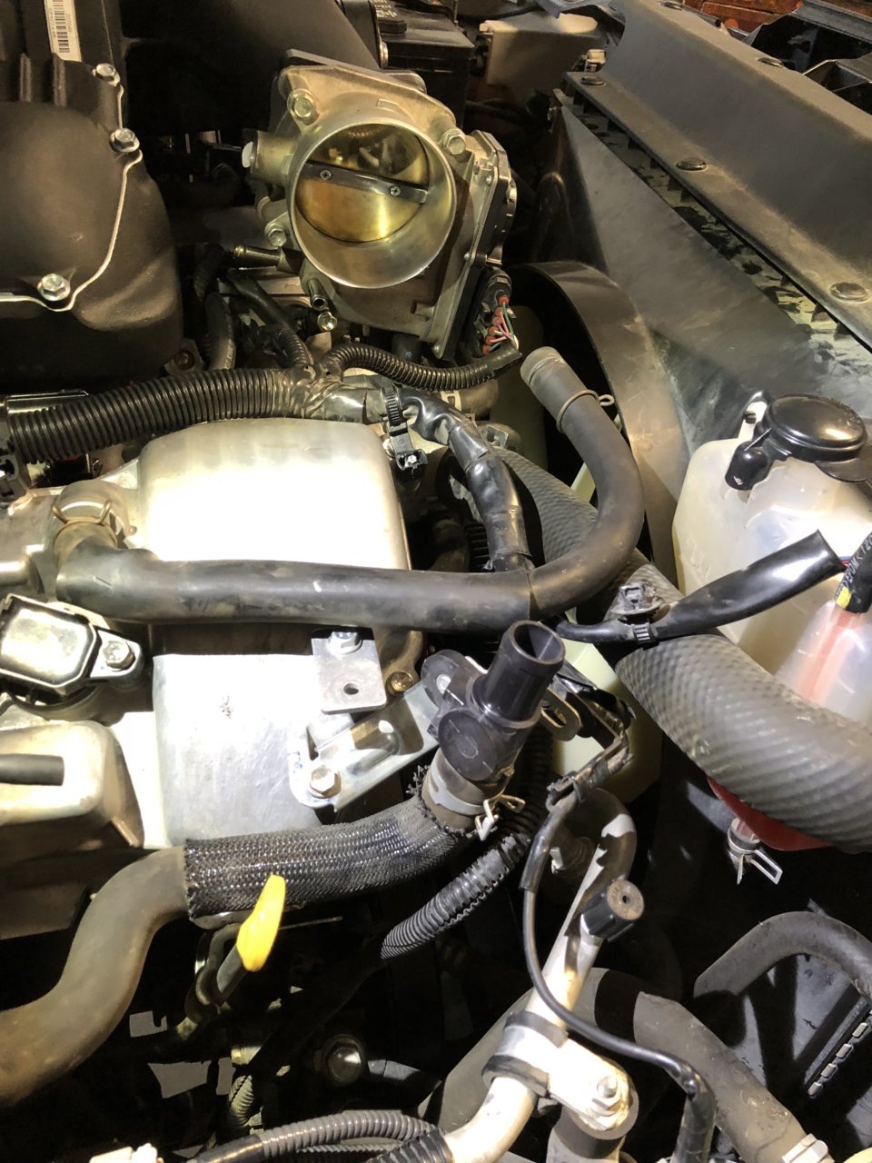

    20180321_181722.jpg The larger tb helps with throttle response and wot airflow.
    I havent done any datalogs with the Airaid but feels the same as the URD TCAI that I had on before.
    @o0opackersfano0o and I traded intakes.
    Here is a pic of the tb. I dont have any with the airaid yet.

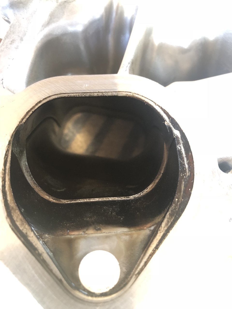

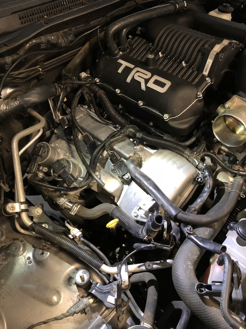

    5thGearPinned
    5thGearPinned [OP] Light Speed
    Feb 25, 2016
    #179354
    233
    Texas
    2013 DCLB 4x4
    TRD Supercharger

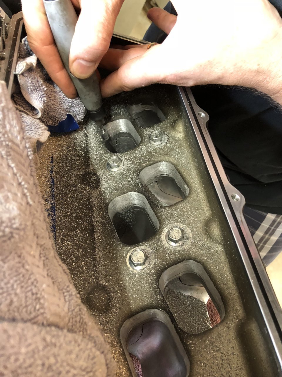

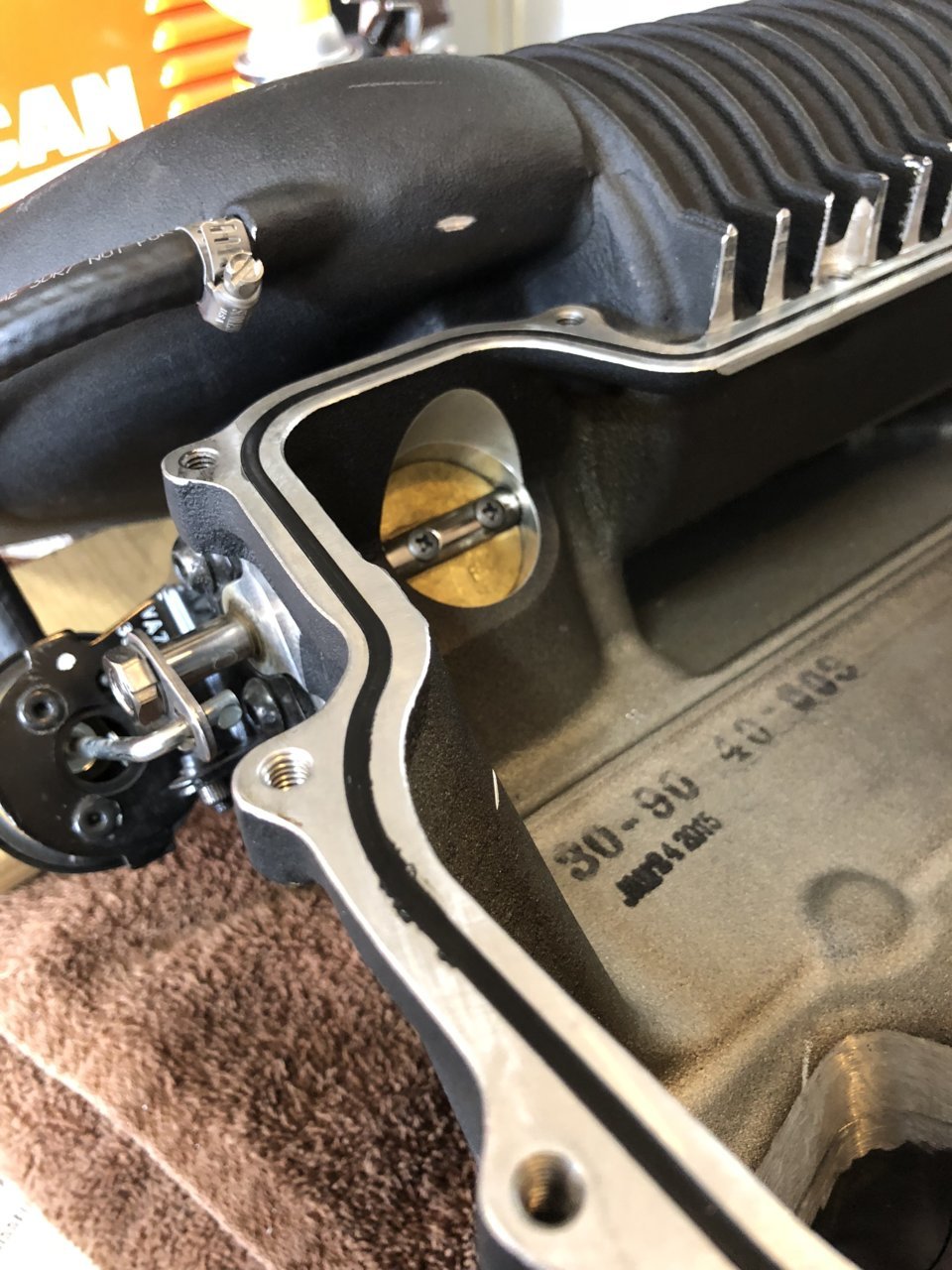

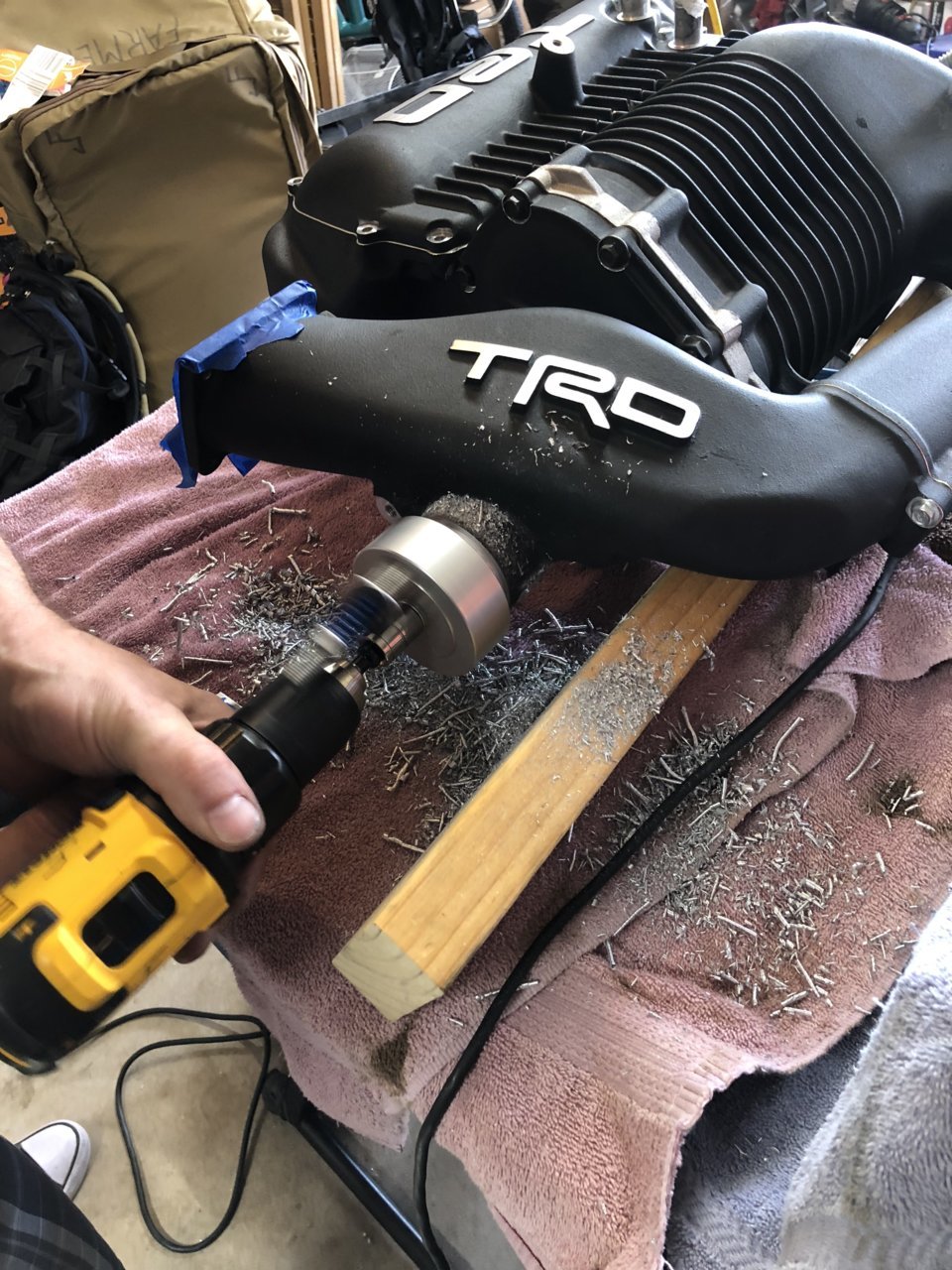

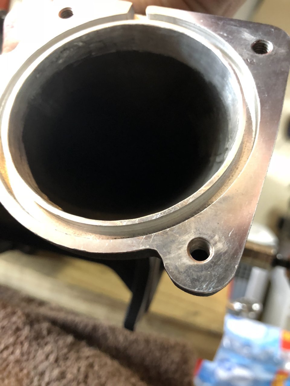

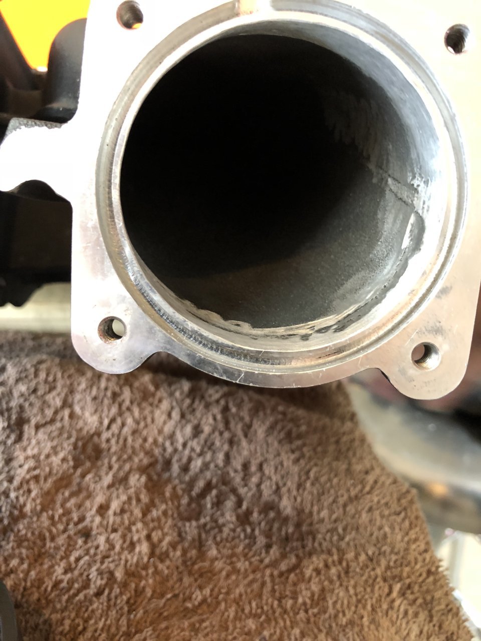

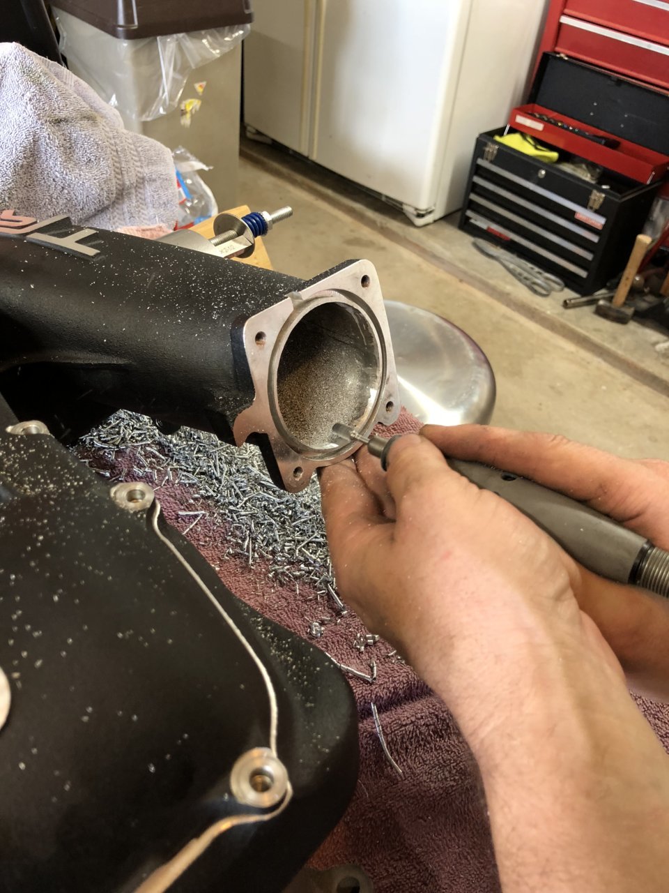

    Here’s a pic of Roosty matching the URD 76 mm throttle body adapter to the supercharger inlet. There was enough material to grind away to fully match to the adapter.
    These two pics show the inlet ground out but not yet cleaned up.
    Here’s a pic that Roosty took of my 76mm tb after he knife edged it. He hasn’t smoothed the bore yet in this pic.
    Here’s a pic after we installed it, you can see it’s massive, lol. I wish I had better close up pics, we modded a crap load in two days with about four hours of sleep both nights, plus lots of drinks and very little food.
    You might get a better idea of the scale with this pic compared to the supercharger.
    He carefully turned the idle screw counter clockwise one turn to basically get it to idle like stock. I was able to slide the afe rubber boot over the bigger throttle body without issue.

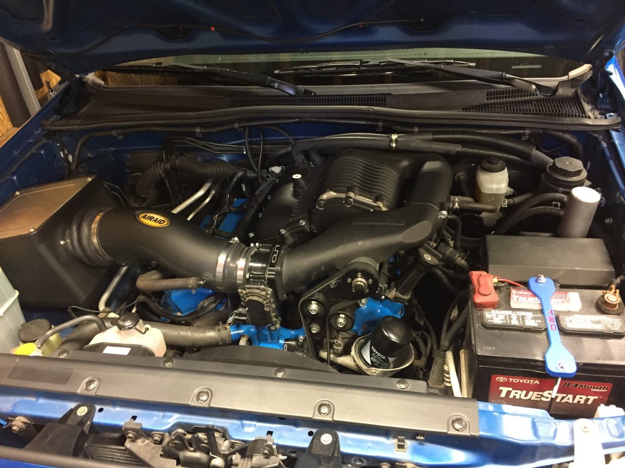

    Damn that intake looks familiar!

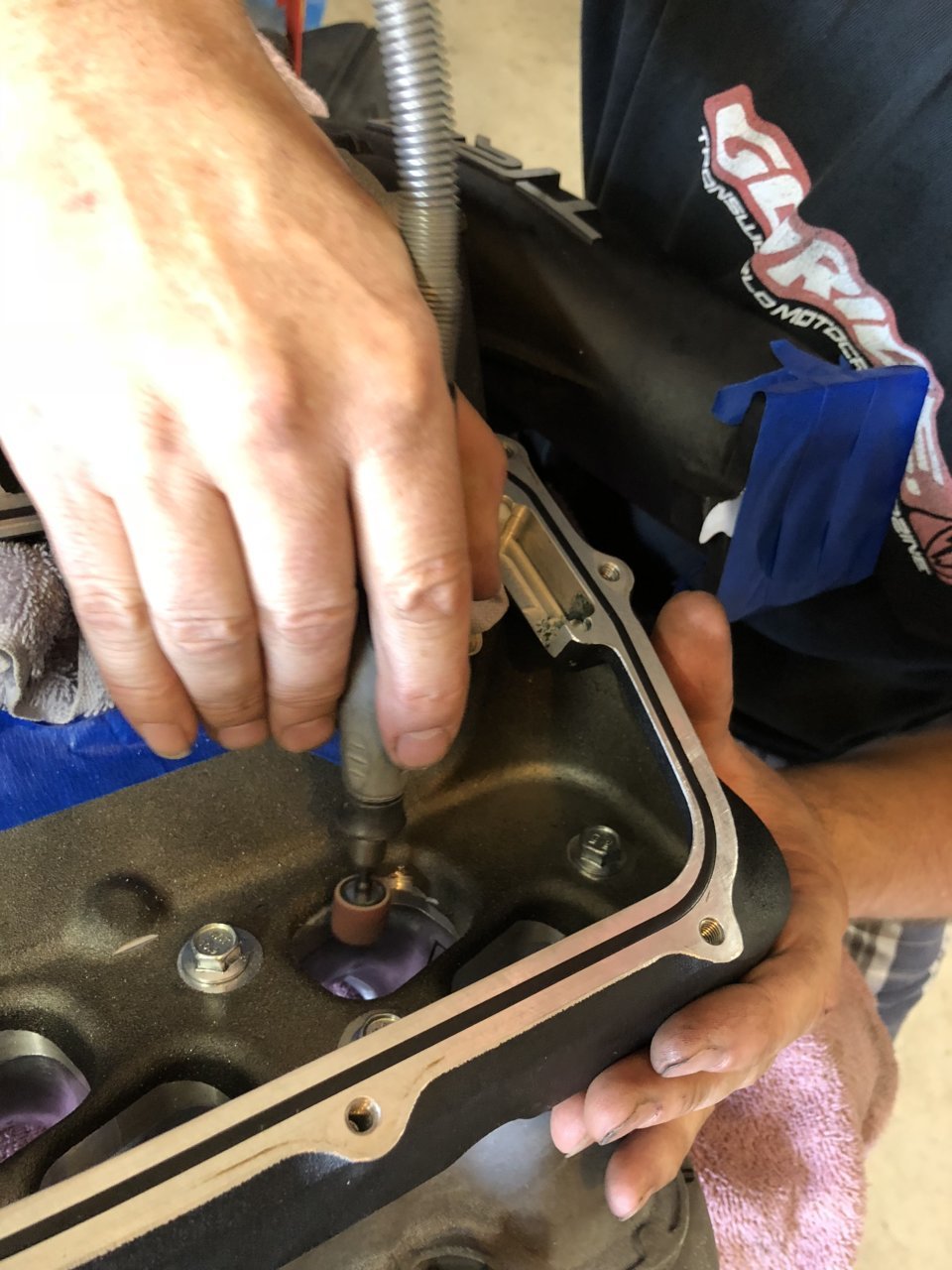

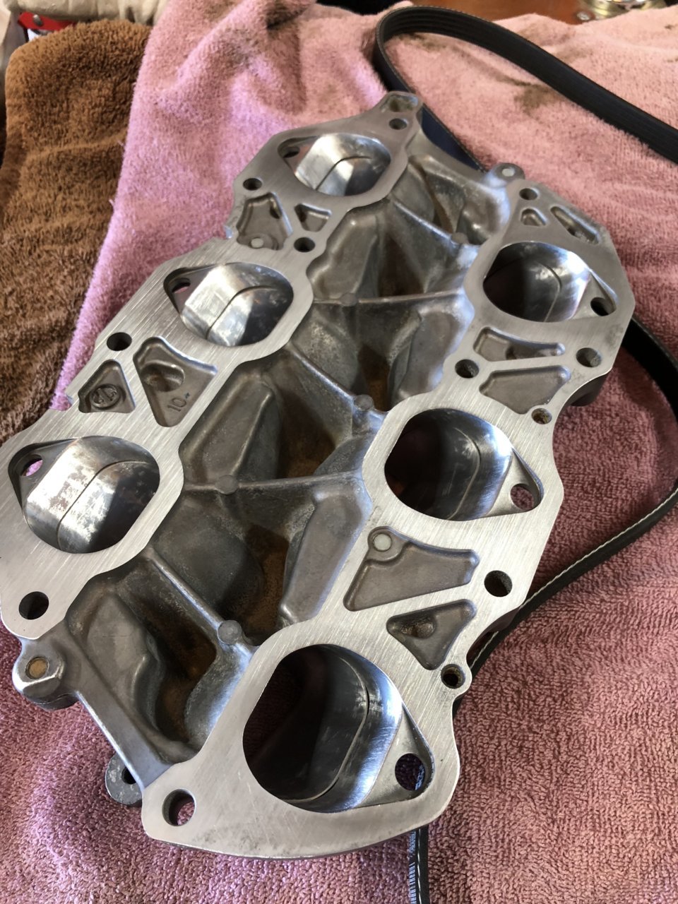

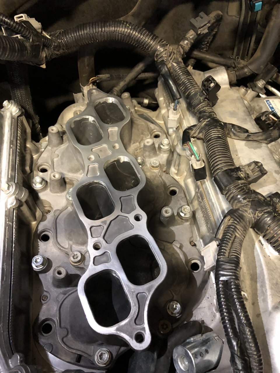

    5thGearPinned
    Feb 25, 2016
    #179354
    233
    Texas
    2013 DCLB 4x4
    TRD Supercharger

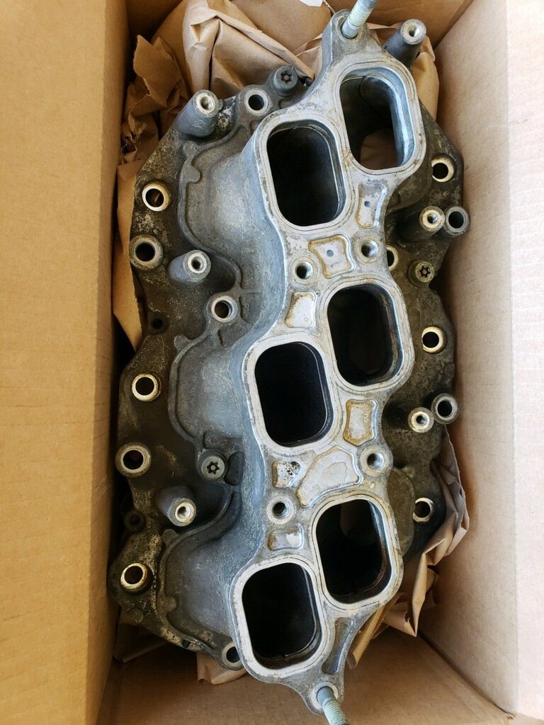

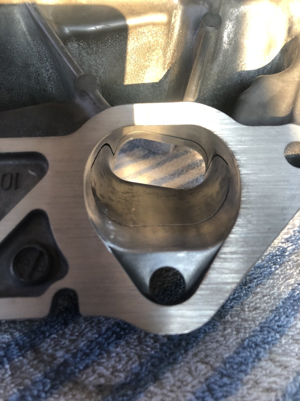

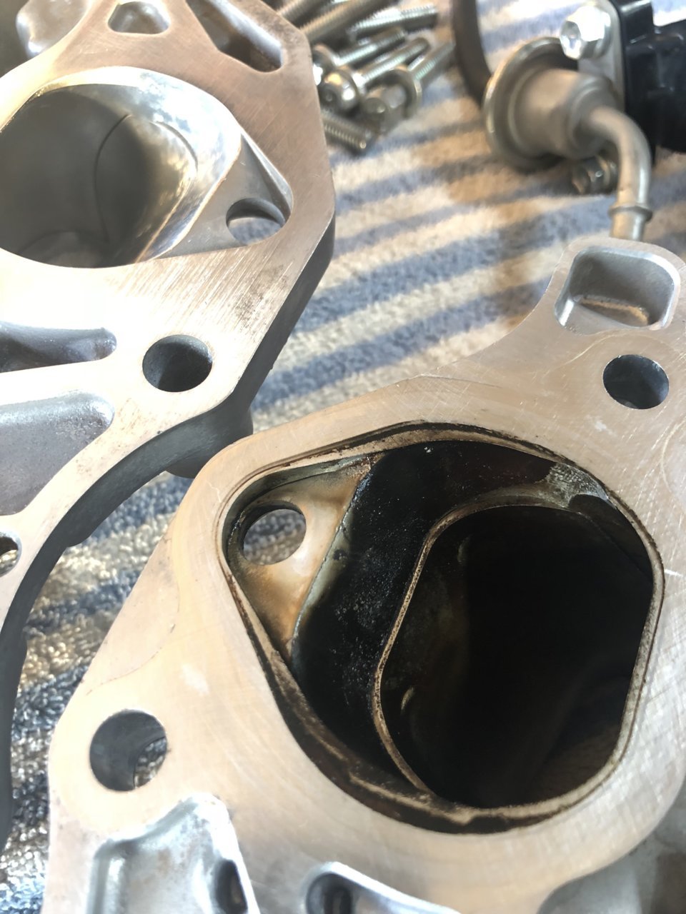

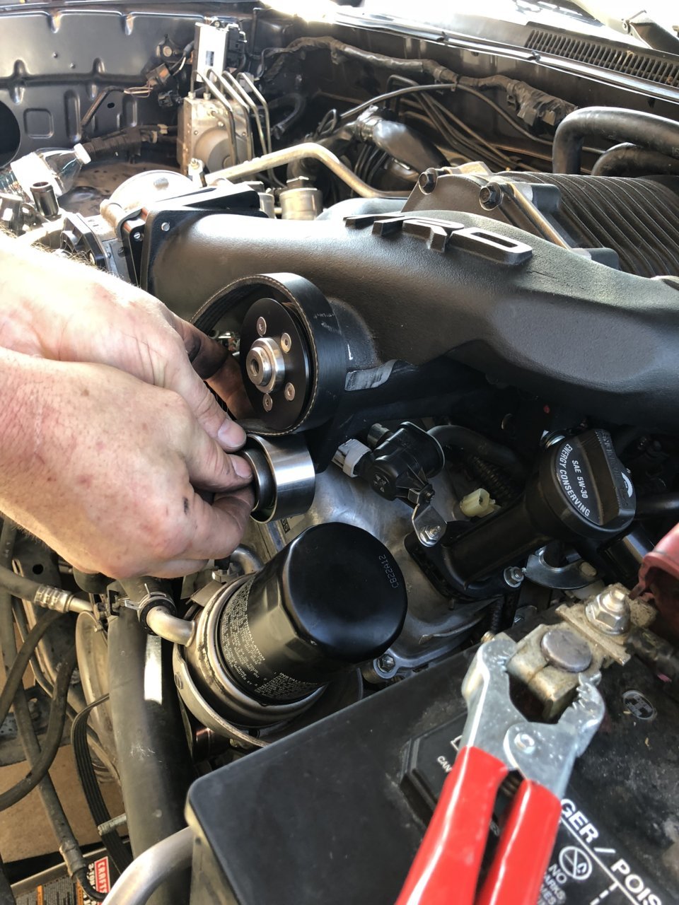

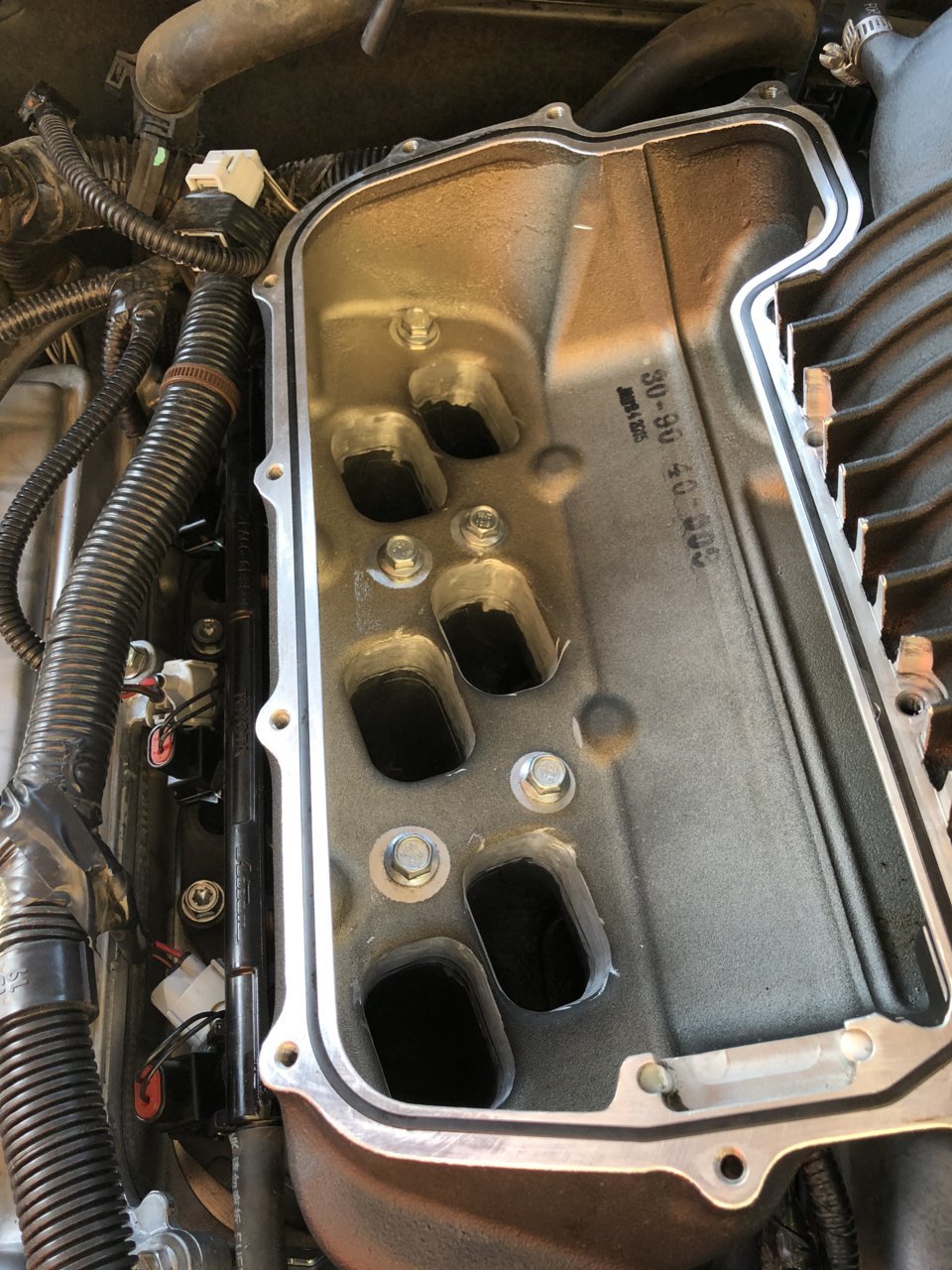

    Here’s the intake plenum that Roostfactor bought to port and polish, basically cleaning all the edges and evening things out in advance of me coming to his house. I traded him mine for this one once we pulled mine off the truck.
    This is the bottom or engine side of one of the runners of the intake before any work was done. You can see the outrageous walls and hang ups that effect flow. Lots of ledges, edges, and no beverages.
    This is after Roosty did his work, a ton better now.
    My old intake on the right compared to Roostman’s work on the left.
    Ready to be installed after it is port matched to the supercharger on its top side.
    Once we bolted the supercharger to the intake, John went to town.
    The intake is now installed on my truck, you can see the match work that was grinded off to flow with supercharger.
    The supercharger is installed and everything lined up perfectly which was a relief.

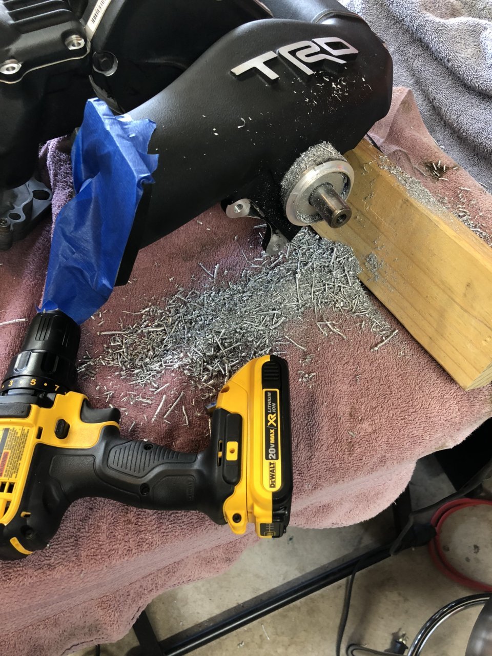

    Before we installed the supercharger, we ground down the snout for the 2.5 pulley. A big shout out goes to WhiteLightningBoosted for shipping his snout cutter to us.
    We also adjusted the bypass valve to perfection.
    Can’t forget the JFR Roostfactor pulley wrap mod, along with the trimmed down Dayco belt.
    Alright, gotta roll, I’ll post more pics in a bit.

    Roostfactor
    Jun 2, 2015
    #156609
    3,885
    John
    TX panhandle
    Thanks @5thGearPinned!
    I wanted to radius the sc plenum runners as you can see some of the radius was grinded out but we ran out of time. Ideally I wanted more of a velocity stack shape.
