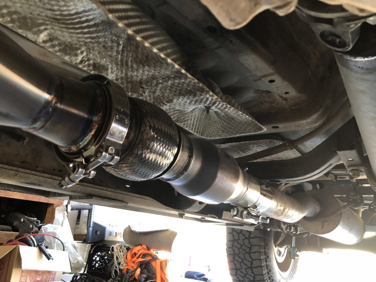

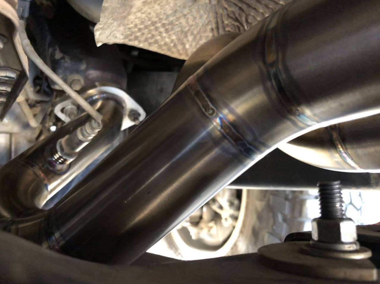

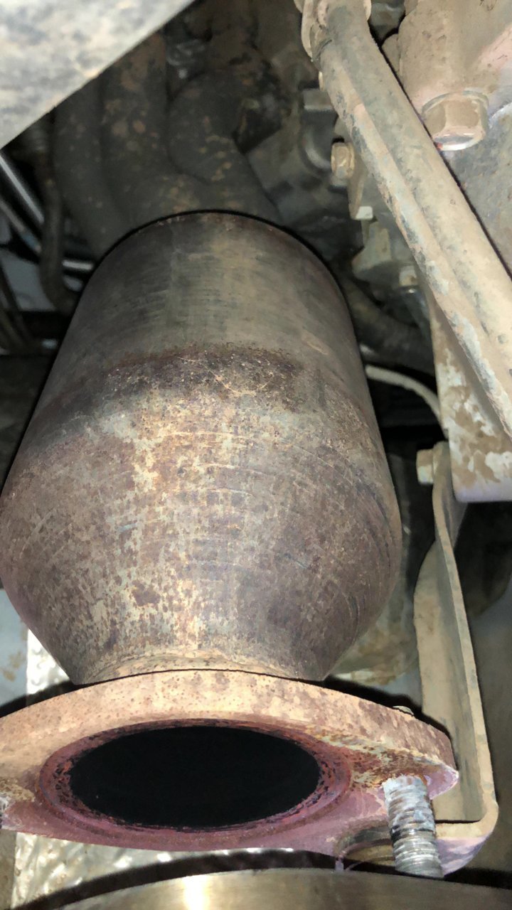

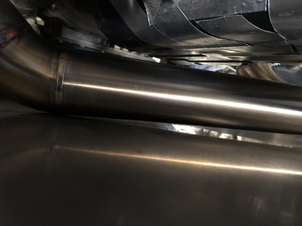

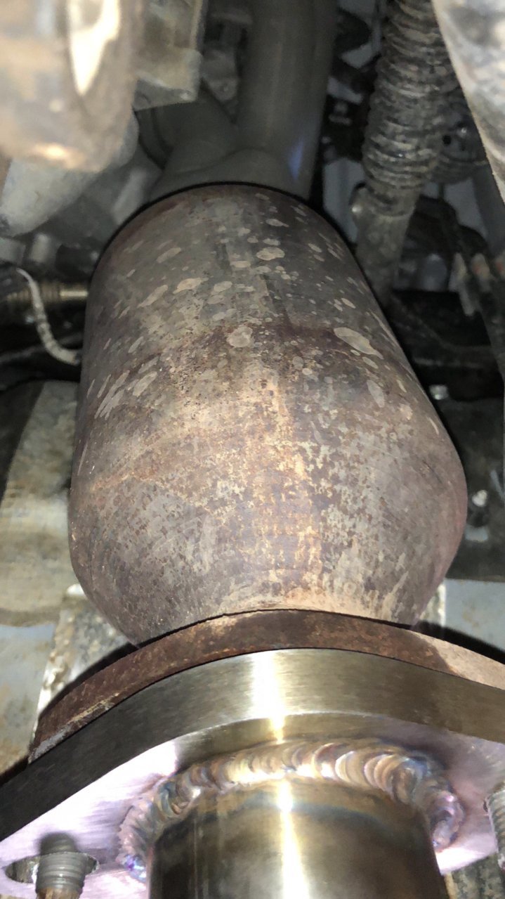

    For now I want to show some pictures with everyone. So some of you probably know I have shortie headers and the shop basically botched my driver side cat up. The transmission L bracket no longer lines up, and it caused some other issues with my cat back rubbing on a cross memeber. Here are some pics where you can get an idea of what I am taking about.
    Passenger side:7DB82AA8-FB2C-4F69-90DC-11C052505202.jpgDriver side:
    Not the most scientific photos, I get it. But you can clearly see why stuff isn’t lining up. Despite all this, The stock ypipe, urd mk2 ypipe, and John’s equal length ypipe still fit on. It mostly causes issues down stream.
    I went to reinstall my rci mid skid,
    It might have a nut hair of clearance, even though it doesn’t look like it from the pictures. I think my header is making this part of the ypipe hang lower, and the collector part of the pipe gets angled up slightly higher than it should be.
    No issue with the bolt contacting the pipe though!
    Here is my temporary solution for mounting the flex pipe to my catback. I think I should maybe flip the vband around so the bolt is facing up and if the nut ever loosened it would hopefully not fall to the ground.
