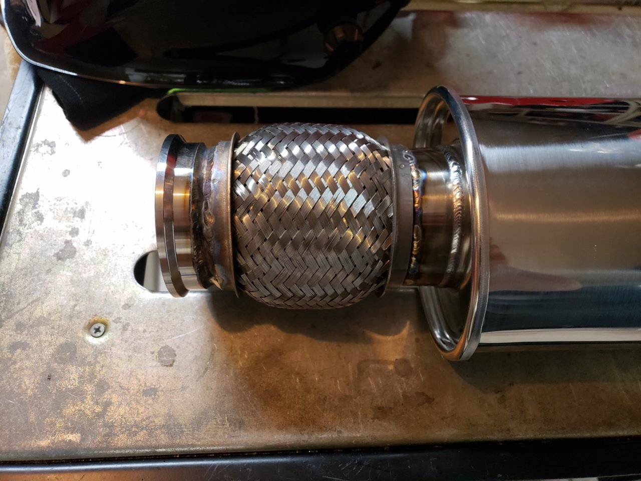

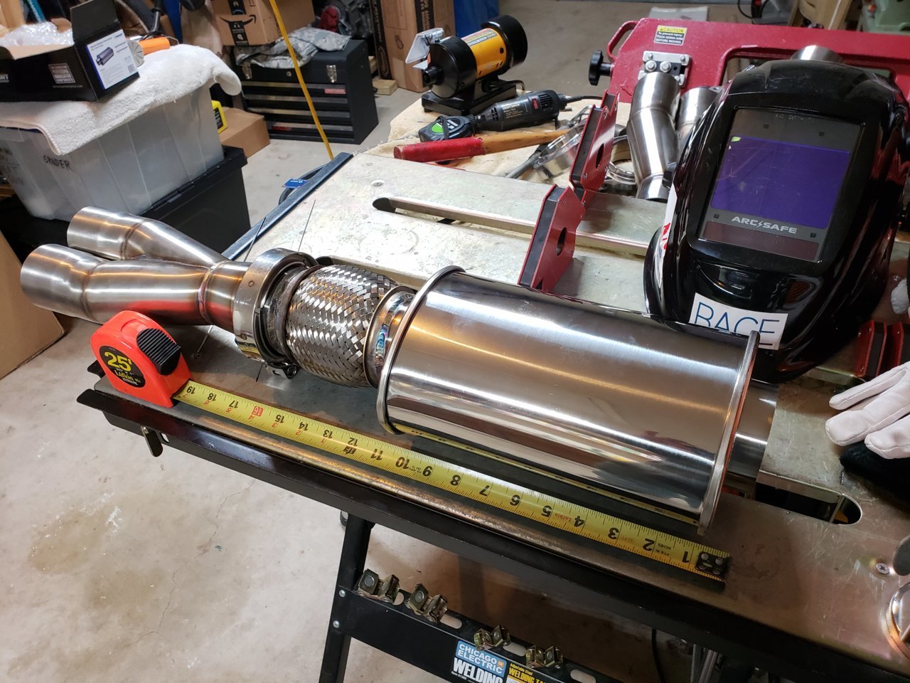

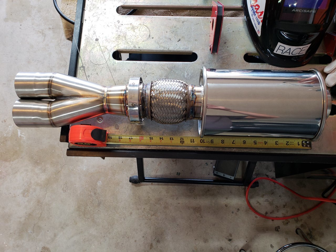

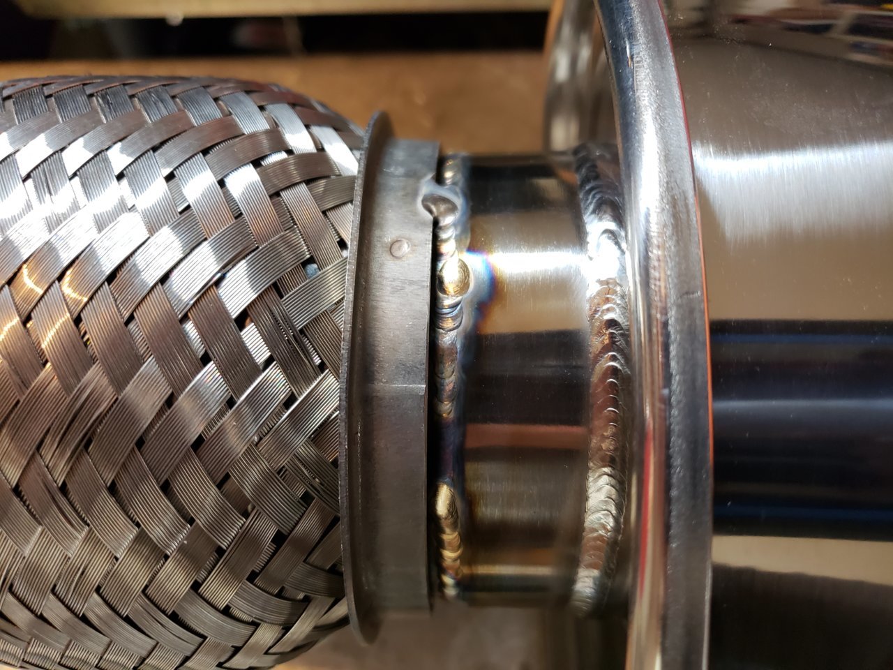

    Just to show you guys a little update of what goes into all this.
    I am installing some stuff for @rjbiii this weekend to include URD headers, my y-pipe (still have to finish) and this setup to mate to his exhaust. He chose an AFE side exit that allows very little room between the y-pipe and AFE muffler. Because of this we have very little room to work with. Originally he didnt want to install a res or cat but I talked him into the res because it would have been REALLY loud without it. He is going catless and we will have roughly 16 1/2" to work with.
    I had to use my portable band saw to get close enough to the resonator to trim 1" off each side.
    I also sanded 1/8" off each side of the flex.
    Then each joint gets a short piece of tubing which is welded all the way around, allowed to cool, then the flex is welded to other tube.
    This is done for structural integrity since there will be loads and vibration applied to this area.
    You can see in the pic that the tube is welded to the res and the flex is tacked in place. I took this pic now so you can see the time and effort involved.
    In this pic you see the same thing but also the extreme closeness of each part in order to meet our 16 1/2" length requirement.
    Total length is exactly 16 1/2". YES!!!
