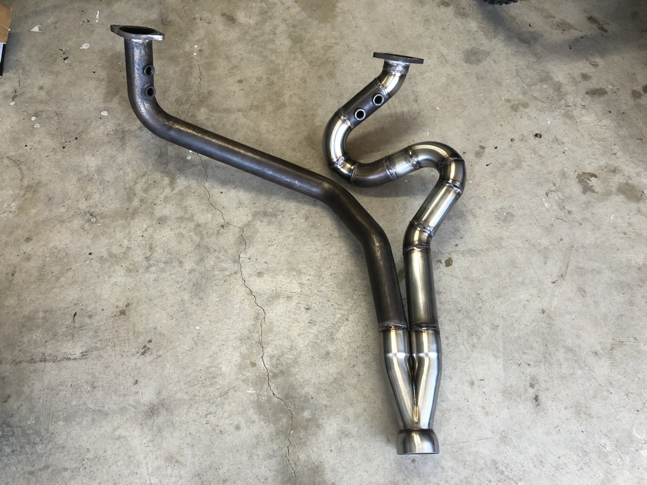

    Damn I want one of these so bad. I'm kinda pissed I got the URD y pipe and didn't know about this lol

    I have the unequal length y pipe. Wait, does URD make an equal length now?

    I think he is referring to URD's Spec-U exhaust. It does have an equal length y-pipe but it is not of any tuned length.

    I see. I have the competition y pipe like @loginfailed had before you upgraded it

    I felt the same way after I installed the URD unequal y-pipe. Sounded like crap. I was considering putting the stock stuff back on.
    Thankfully @Roostfactor convinced me that unequal length was the problem and he made the URD y equal length. After experiencing both versions back to back, I wouldn’t recommend anyone run an unequal y-pipe on a 1GR.

    Other than the sound, how much performance benefit is there in the equal length?

    It’s pulls harder and carries further throughout the powerband, besides sounding smoother and better, the exhaust pulses are helping each other and not fighting themselves when they merge. Instead of hitting each other at the merge, they are going in single file help pulling the other one through or out is a better way to say it. Roost has figured out the right length and diameter so that the whole pipe is tuned for the optimum rpm range for our engine. It gurgles when you are off the gas and coasting, idling. It’s awesome.

    Basically what @5thGearPinned said.
    On these engines, the left bank and right bank are basically taking turns firing a cylinder. When both sides are the same length, the distance an exhaust pulse has to travel is equal on both sides. So now the pulses are also taking turns at the collector.
    With unequal length, the paths are different distances so you get exhaust pulses arriving at the collector at the same time colliding with each other. When two pulses are trying to squeeze though at the same time it impedes flow.
