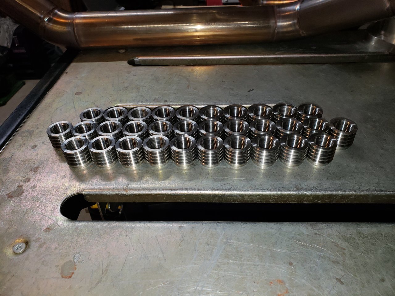

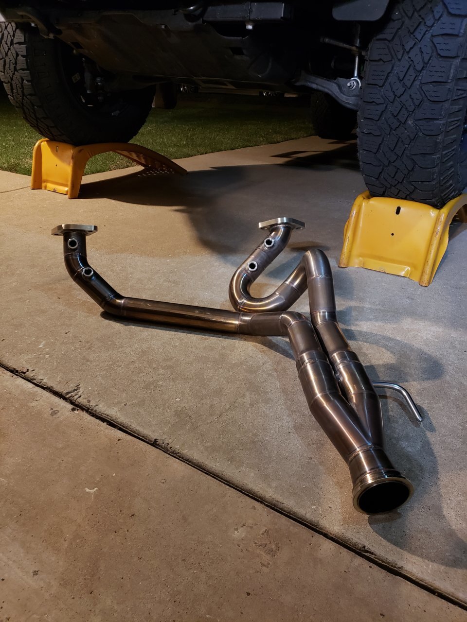

    Alright ladies and gentlemen,
    Sorry I havent been around much the last couple weeks but have been trying to get a good opportunity to take the truck apart AGAIN to start making y-pipes.
    Thank y-all for your patience and understanding. It's time to fuse some stainless!!!
    I should have enough material to make the next 5 units and after that I am waiting on "High Speed" merge collectors. Hopefully they come in soon!
    I would like to post the order of priority for those who have ordered so please let me know via pm in the next day or so if you dont want your name posted publicly. This will make it better for everyone as people will know exactly where they stand in the pecking order.
    I will say that right now I have a backlog of 12 people so you can get an idea of where you stand compared to when you ordered.
    As of tomorrow morning this is my full time job until further notice so first up is making a jig off of my y-pipe to include additional clearance for FJ and 4Runner front drive shafts (thicker) as well as slightly raising the area of the trans crossmember to alleviate any fitment issues with the pre-runner crowd. Thanks to @jojotoo for sharing that info.
    Once the jig is made I will build one to the jig as I continuously check fitment with my truck. When finished the finished y-pipe must fit the jig and truck perfectly or adjustments will be made. Then build one directly off the jig until completion and check fitment to truck. When it's perfect then and only then can I start making them off the jig with confidence. From that point forward the build process should go quicker.
    Call me crazy (others have) for thinking this is sexy!
    All for now and Happy Halloween,
    Roost

    Ribbed. Bungs. All makes sense now. :D
