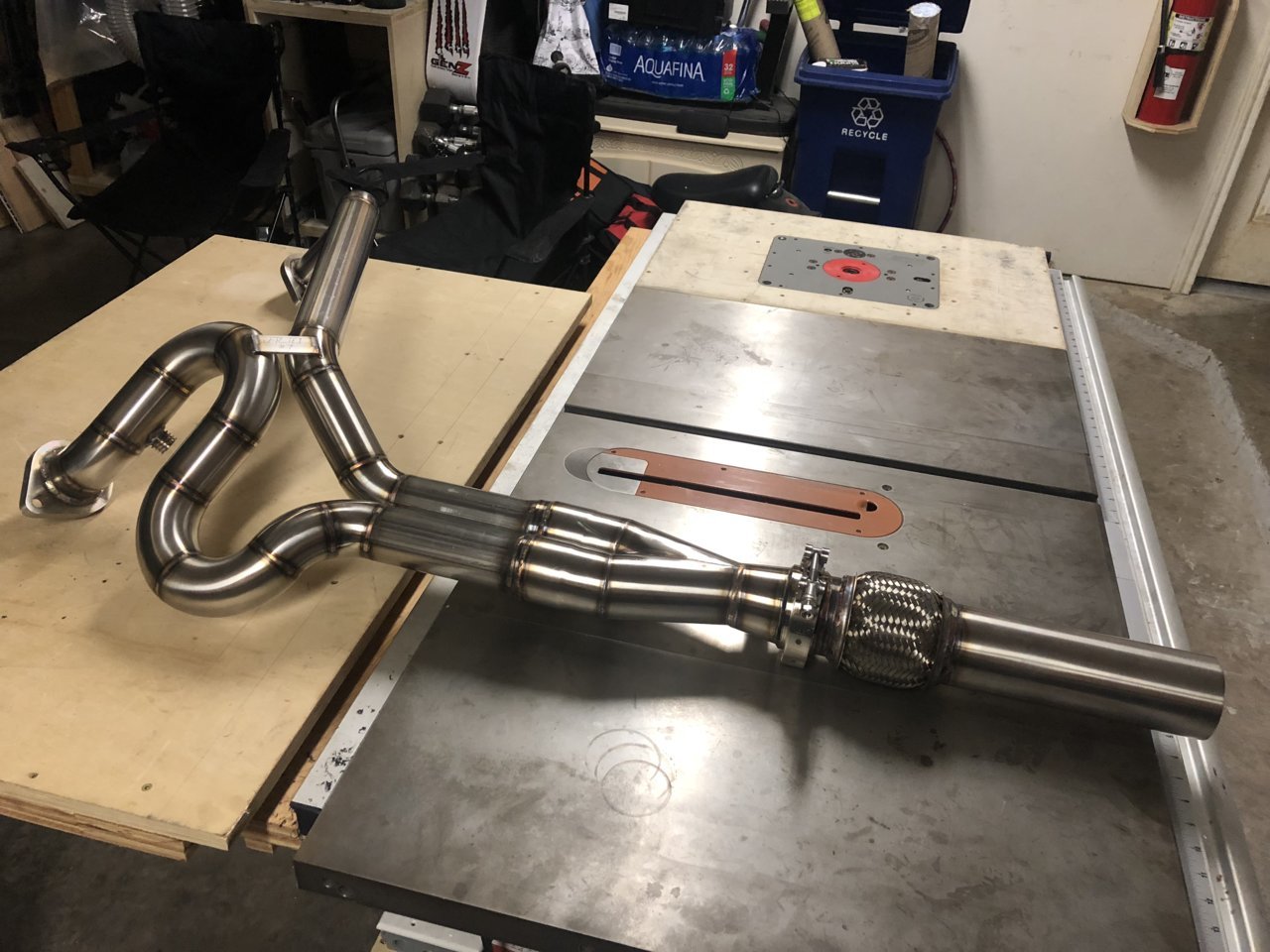

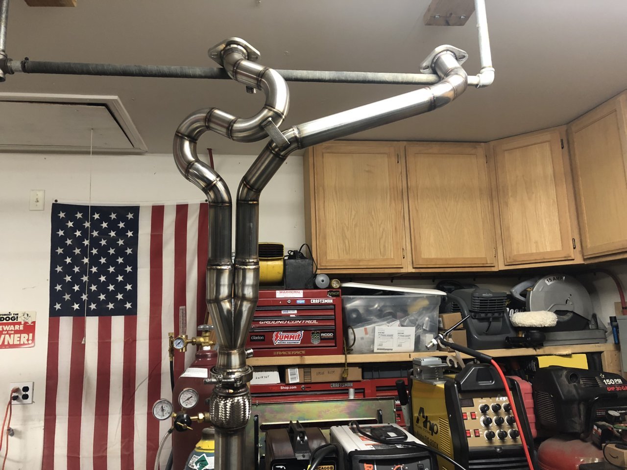

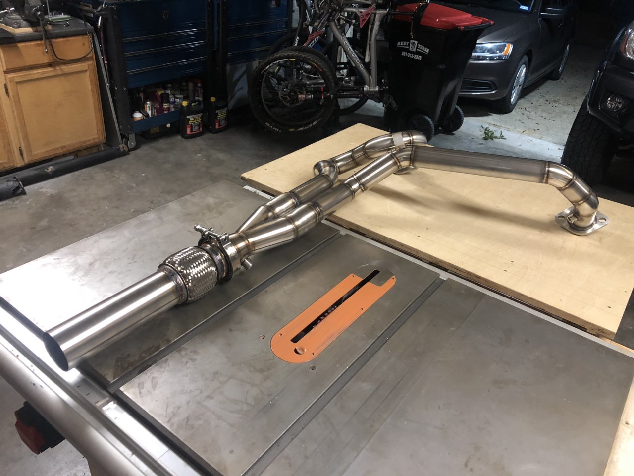

    Leave it to the man, to overcome the issue that didn't exist. ;) Bravo. Fantastic work again.

    Those are some beautiful pictures! :drool: I love how you are willing to design and fabricate what the customer really wants, not only your Tacoma but other Yotas. You are a very skilled A&P. Have you ever heard of the Chuck Taylor Award? Seems right up your alley... I'm stoked I am next in line. You are the man! Thank you in advance Roost!

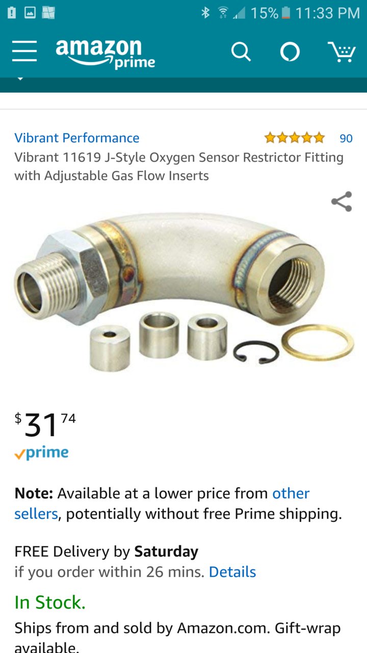

    @Roostfactor do you see any clearance issues running these adapters on both sides for those of us who don't have the UCON to disable longtube header cels? Apparently the combo of this adapter and the URD Sims does the trick for late models
    I can order a set and send them your way for fitment if needed

    Yeah man order a set and send them to me. That way I can ensure no probs on install. PM me and I'll give you my addy.

    Maybe @JacksonTacoma can shed more light on it but I know I still had occasional CEL's on my 15 even with the o2 sim. This is supposed to cure that. He may send me a set to ensure the o2 sensors will reach.
    If I have them on hand I may be able to locate the o2 bung where it will reach with or without the adapter.

    I don't know that it's a specific issue with '15's, I'm just going off of what I've read here in the forums. A couple guys with '15's have said that Gadget flat out told them the URD sims are hit or miss on the late models. I assumed its a '12-15 issue but can't confirm.
    As far as the J-bung, I'm going off of @arcenik reporting that that the J-bung with URD sims combo solved his CEL issues when using the small orifice:
    https://www.tacomaworld.com/threads/2015-tacoma-o2-simulator.562781/#post-18442797
    https://www.tacomaworld.com/threads/udr-headers-check-engine-light.395206/page-7#post-17266932
    @Roostfactor PM sent for address

    I can make them fit easy. It's a matter of if the o2 bung can be placed where the o2 sensor can reach with or without the adapter.
    So you want these incorporated into yours? If so order them and send them my way. You may have my address already but if not send me a pm and I'll give it to you again.

    It is relevant between the '12-'15 models.
    One member, removed his sim, and just used the bung extenders above, and stated it solved his issue. URD is aware that the above models have simulator issues.

    It is something slightly different in the way the ecu reads the rear o2. I had the urd sim before ucon and got occasional cels p0420 and p0430. Gadget sent me a replacement with no change. I also tried using an o2 spacer without a restrictor orifice but it didnt help either.
    The 12-14 dont seem to have as much of an issue. I have worked with Scott on the UCON also to solve the issue which is mostly cured now but I still occasionally (rarely) get a p0420 or p0430.

    Ok so three people now want the J adapters.
    Just so everyone knows I will TRY to place the bung where the o2 sensor will fit with or without the adapter so you could choose to run it or not run it.
    Understand that the o2 harness is only about 6" long so if you want it to fit with the J adapter the o2 sensor MAY not reach the bung without the adapter. I wont know until I fit the first one up.

    I believe Casper's Electronics sells O2 extension harnesses.

    I believe the other place that no one wants to mention here (but I'm buying my headers from them), has extensions as well.
