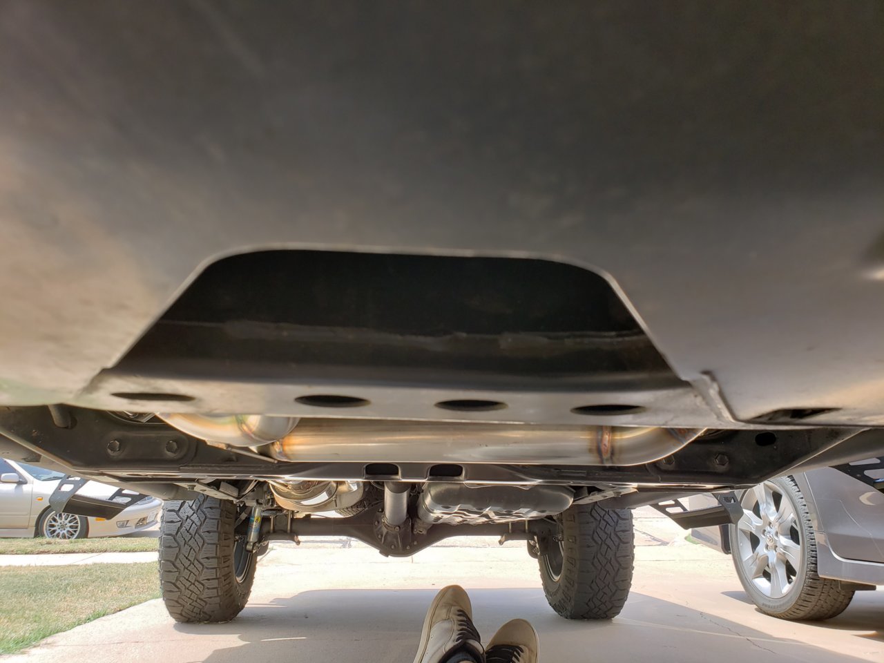

    Thanks Crash! I'm not 100% following you. I have an Off Road model with factory skids and there is no skid under the trans.
    I do ensure the pipe sits slightly higher than the crossmembers so there is no fitment issue for someone running aftermarket skids.
    I havent seen aftermarket skids in person so I dont know exactly how far they sit under the crossmember.
    If I put a straight bar between the two crossmembers shown in the lower pic. The pipe clears.

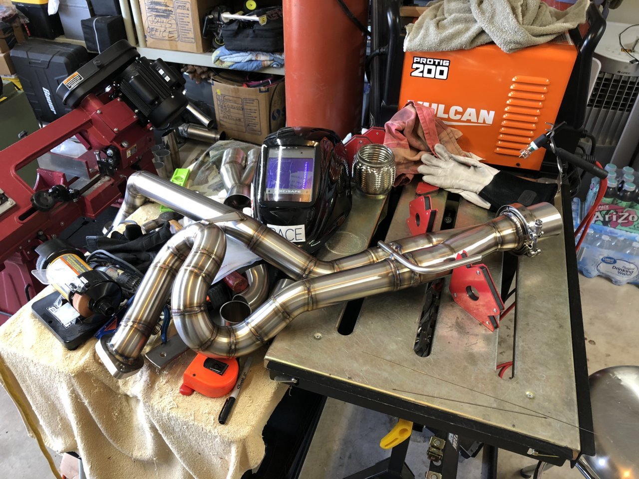

    A few more pics from Roostfactor day.
    This pic was taken right after I saw it for the first time. I was blown away to say the least.
    I like this shot of the madness.
    In this shot, and the one above, the hanger is being welded on.
    Biscuits, JWL, BassAckwards and 3 others like this.

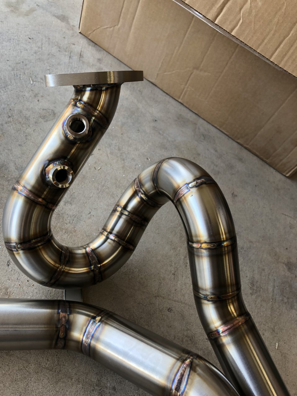

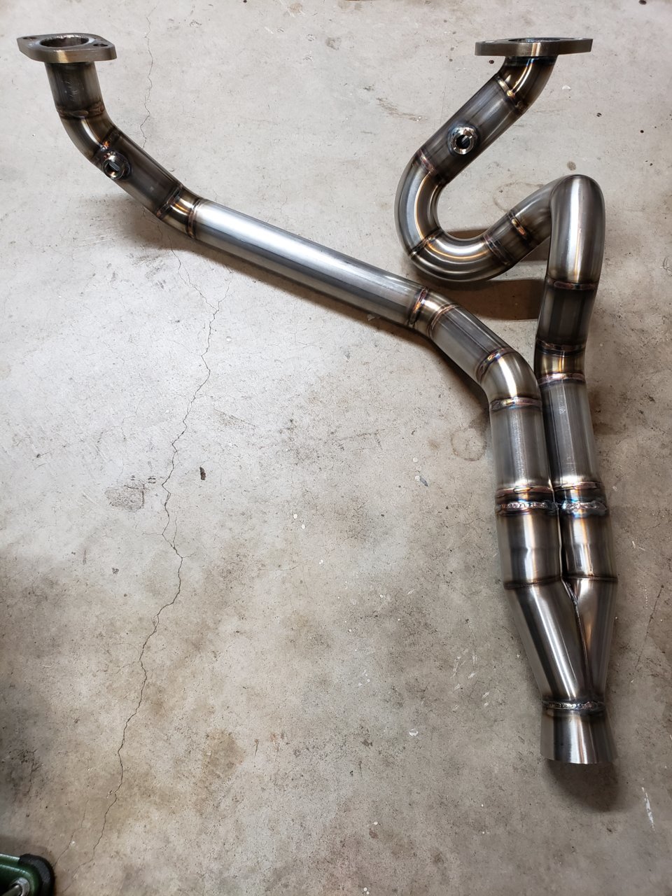

    One thing to note for all that are interested in this: I don't have control over the exact finish of the straight tubing. Sometimes it comes brushed and sometimes it doesn't. Also, the pipe in this picture has 45 degree elbows because my supplier was out of 90 degree bends. I usually do the 90 degree bends and if available that is what will be provided unless you want to spend an extra $50 for all 45 degree bends.
    This is an example of the 90 degree bends where possible and non brushed straight tubing.

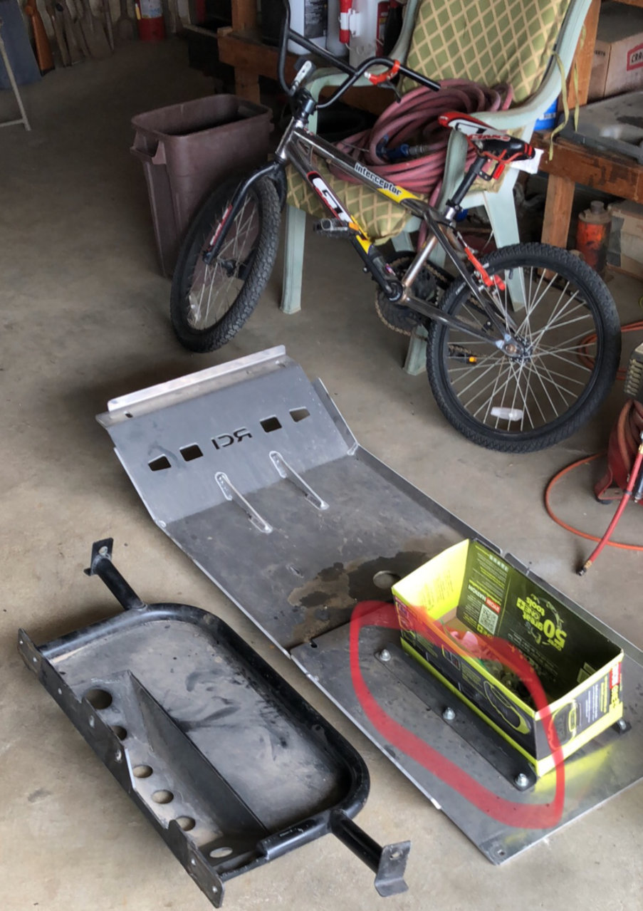

    Apologies for the lack of clarity. I destroyed my factory skids on the last outing, so I am looking at aftermarket replacements, including the trans. I would hate to use that beautiful art peice of art as a skid plate. You answered what I was looking for, thanks!
    @Murphinator I was also evaluating RCI, the trans pan has center braces, when you say “removable”, do you mean with an angle grinder?

    SoCal
    14 DCSB 4x4
    Negative. Mine were held in by 3 bolts on each brace. No angle grinder required!
    Edit: I do have the aluminum version though, steel may be different.
    Double edit: pic for reference

    Thanks for the info, I was going to run aluminum as well. Their website shows welded braces, maybe it is showing the steel product, or a earlier version. I’ll email to confirm with them before purchasing if that is the route I decide on.
