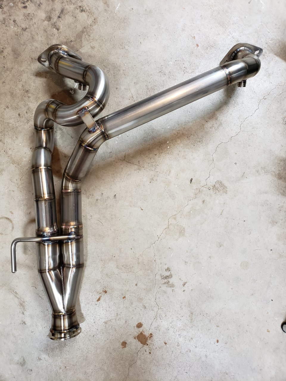

  2. Aug 12, 2018 at 7:09 AM
    #102
    5thGearPinned
    5thGearPinned [OP] Light Speed
    Feb 25, 2016
    #179354
    233
    Texas
    2013 DCLB 4x4
    TRD Supercharger
    Yes it is, nice work!

  3. Aug 12, 2018 at 7:11 AM
    #103
    JWL
    JWL Well-Known Member
    Dec 26, 2014
    #144961
    1,760
    Jeff
    Greenville, SC
    08 DCSB 4x4 TRDOR
    OME 885, Bilstein 5100, JBA UCAs, 2" Single AAL
    Sheesh that thing is beautiful!!

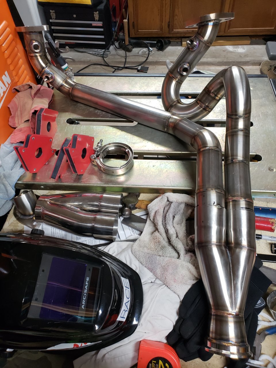

  7. Aug 13, 2018 at 2:39 PM
    #107
    Roostfactor
    Roostfactor Well-Known Member
    Jun 2, 2015
    #156609
    3,885
    John
    TX panhandle
    2015 DCSB OR Pyrite Mica
    HPT/justDSM tuned factory ecu, URD Headers, JFR Y-Pipe/l 3" exhaust, Walbro 255 fuel pump, Maggy SC (JFR ported), JFR ported lower intake manifold, 76mm tb, 2.5 pulley, 640cc injectors, CSF Radiator, custom electric fan wit Autocoolguy controller, JFR SC pulley wrap mod
    @jojotoo I almost got yours finished last night but ran out of time. Now I still have to fit it up to the truck, weld the merge collector, and add one hangar. If stars align it will ship late this week.
    Please PM me your address.

    @Roostfactor I do have a question for ya if you dont mind answering. Off the manifolds are the I.d. of your pipes 2 1/4, 2.5, or 3in? Just wondering.
  12. Aug 14, 2018 at 6:00 PM
    #112
    Roostfactor
    Jun 2, 2015
    #156609
    3,885
    John
    TX panhandle
    OD is 2.25" ID is .130" smaller. It's the same diameter as the URD headers if the inner lip is ground flush.

  16. Aug 17, 2018 at 3:22 PM
    #116
    Roostfactor
    Jun 2, 2015
    #156609
    3,885
    John
    TX panhandle
    @jojotoo tours is done! I will ship it next week per your request.

  20. Aug 17, 2018 at 5:14 PM
    #120
    Roostfactor
    Jun 2, 2015
    #156609
    3,885
    John
    TX panhandle
    Yeah I saw that. It's pretty funny really. I had told him when I bought his Spec-U system that I thought the problem with the drone was at the merge collector or rather the lack of a true merge collector and that his system the pipes barely turn parallel when they merge together causing reversion.
    I told him I would test my theory and he said he had already tried that. Now he re-releases his system and said he did some trickery in the merge to fix the problem.
    Furthermore he said it's a "tuned" length. I dont know how he is calculating the tuned length because it just routes together as close as it can after the transfer case.
    I am not trying to bash his product because I'm sure it's a good system but I am pretty damn confident my y-pipe yields much better numbers in the rpm range we use our trucks.
    He also magically has a 160° thermostat that he offers as an option for his 170° thermostat kit. I had asked him long ago about the 170 when I saw zero temperature difference between his 170 and the stock thermostat and he said a 160 wouldnt work because it would cause a cel. I tried it anyway after getting the part # from @Torspd. It works perfect and now amazingly it's on URD's site!
    Once again not bashing because I think it's funny and a complement in a weird way. He does have quality products of which I have and use many, and I still recommend people buy certain things that have synergistic effects with what I have.
