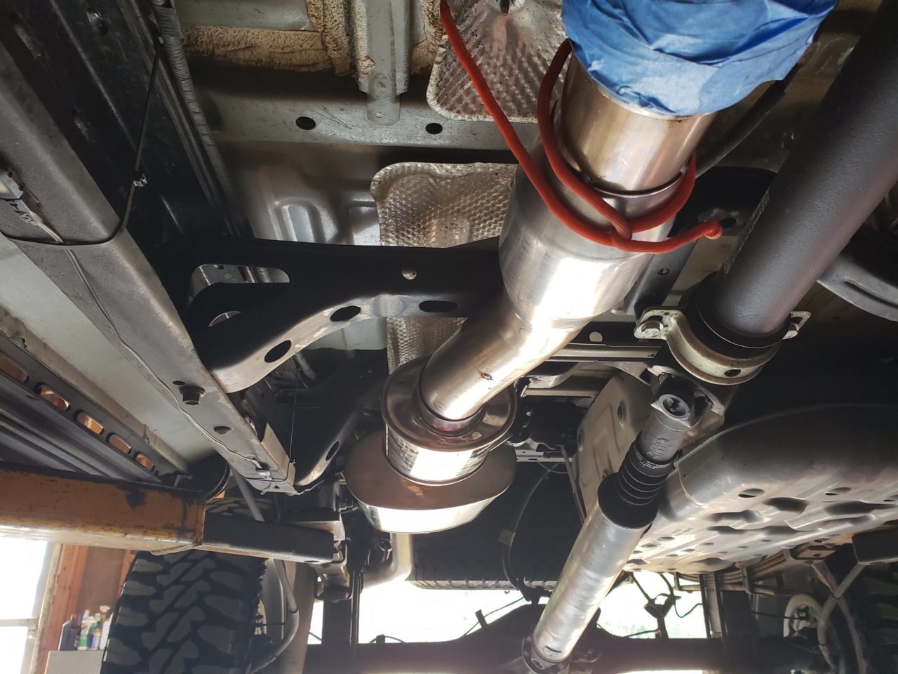

    20180818_124357.jpg Making good progress. No speed bumps so far.

    Ooouuucchhhhh! The prototype is forever changed! :D:D:D

    I know. Price of a dumb dumb bracket lift boyo_O

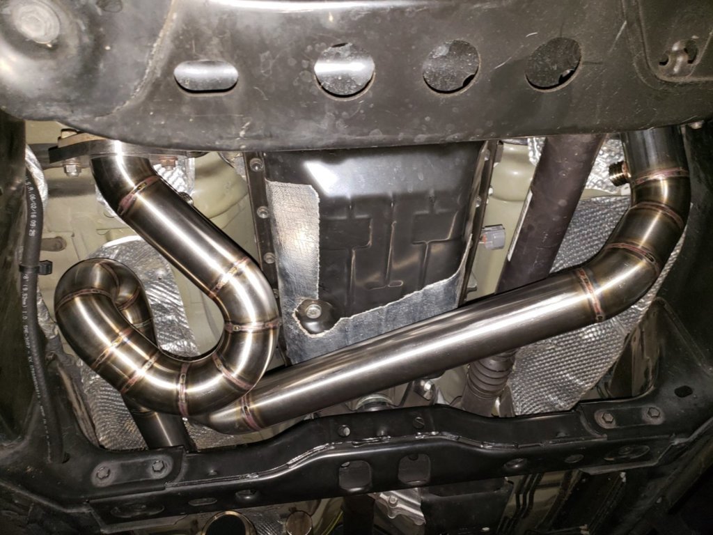

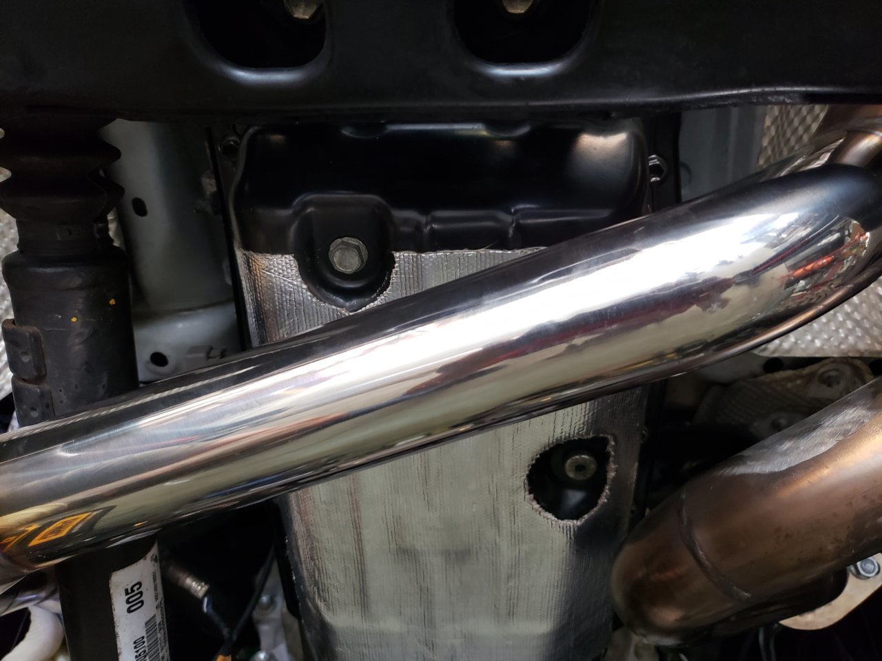

    Hey try to keep the trans drain and check bolts accessible. There is no way of checking fluid level if you dont have access with the y-pipe on.

    That's some bitchen heat shielding, where'd you get it?

    You know I have to see the finished product.

    I got the heat shielding from (THE MAN) who pioneered this concept. Final welding now. 20180818_160955.jpg

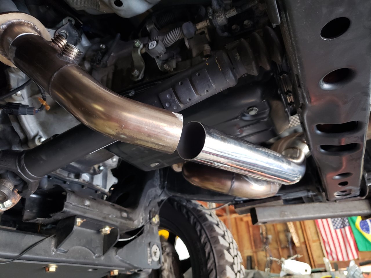

    Have you done the carrier bearing spacer?

    Your drive line angle could really benefit from the 1" relief. Crawl under the carrier bearing mounting points and look for shiny aluminum spacer blocks.

    o_OIs the flat bar welded from pipe to pipe new? I don't remember seeing this until this thread...

    20180725_222159.jpg I don't see it here.

    That's 5thgearpinned's truck. No lift.
